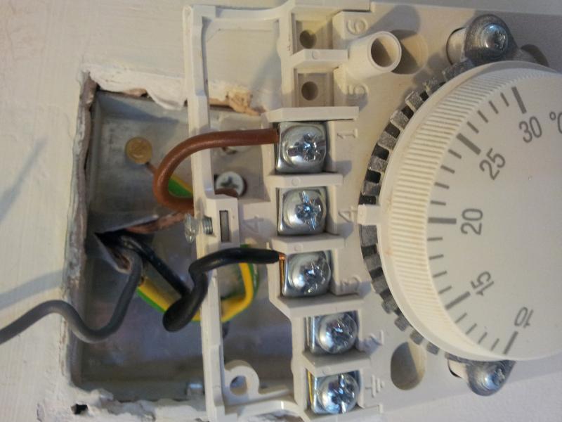

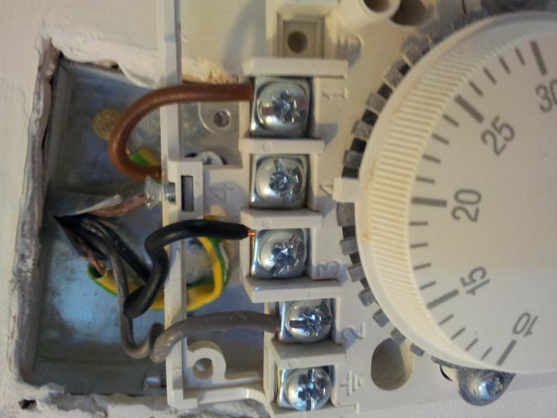

OLD STAT:
So from this:
Brown = Live
Black = Switched Live
Grey = Neutral
To confirm I had the Switched Live/Neutral correct, I wired up the same stat and removed the neutral and checked it still turned the boiler on/off, which it did:

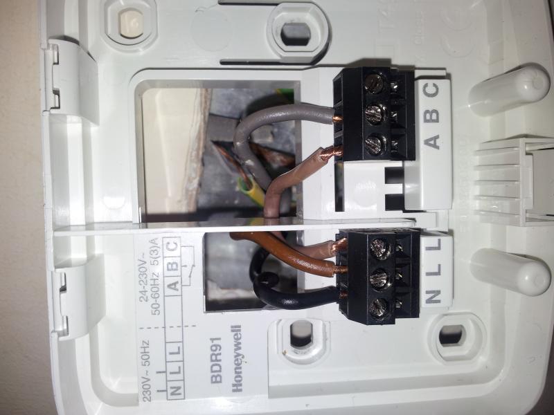

So I then wired up the new CM927 with the following:
N = Grey
L = Brown
L2 <=>A Link
B = Black
[No photo available]
Which I believe should be correct. This didn't work, no lights on relay, nothing fired up, etc. Essentially dead.
I then accidentally did the following:
N = Black
L = Brown
L2 <=>A Link
B = Grey
(Note this is incorrect in theory):
Swapping the N and SL - oops. This seemed to work - the box powered up and responded and had the all important green light. However it didn't fire the boiler up (presumanly because it was just switching the live to neutral rather than going back to the boiler.
So I'm stuck. Is this a dodgy unit or have I done something stupid:
I reckon your old stat was miswired, try this
black to L
grey to N
brown to B
and link L and A
The wire connected to terminal 2 must be the neutral or the boiler would not have worked when it was disconnected. So 2 goes to N.
As for 1 and 3, 1 should be Live and 3 the Switched Live; but it's not unknown for installers to wire it the other way round (Technically it's wrong - but that's another topic).
If you have a multimeter you can check which is Live. This should go to L and the remaining wire (S/L) goes to B. You also need a link from L to A.

Hi
OK - just tested with multimeter.
With the old stat still connnected, but turned down to off:
Brown to Grey: 235v
Brown to Black: 235v
Grey to Black: 0v
So, the only connection with a live when the thermostat is off, is the brown - this must be the Live?
We established earlier that if I remove the grey, the boiler still fires, so Black must be SW/L. Therfore Grey is neutral
So, wiring up the CM927,
N: Grey
L: Brown
L: Link to A
B: Black
Correct? This is what I tried first time to no avail.
