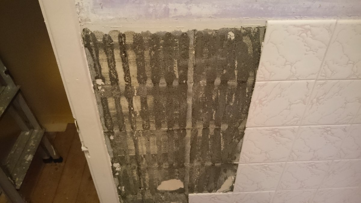

Hi ,just removing the tiles in the bathroom in my new house. What is this type of adhesive under the tiles? It has a crumbly consistency and is only under some of the tiles. The rest of the tiles have the standard white adhesive.
cant remember what its called,but done many a shower/ablution rooms where i work and that stuff has been lingering behind it,ITS A RIGHT P.I.A to remove and the only way ive managed to to it is using a still filler knife and start by jabing it then like using a chisel try and push it off,oh and resharpen the edge of the knife regularly.
i normally just smash the tiles all off then do as ive said above.

to be honest i have no idea?but wouldnt of thought so,as you can even pick it off with your fingers.
did even consider using a sander before but would think it would be extremely dusty.
so as said chip it off manually.
Never known of a tile adhesive that contains asbestos. What purpose would it serve?
Looks like crappy ready mix rubbish to me.
Yeah your right,it basically crumbled away today when I finished smashing the tiles off.
