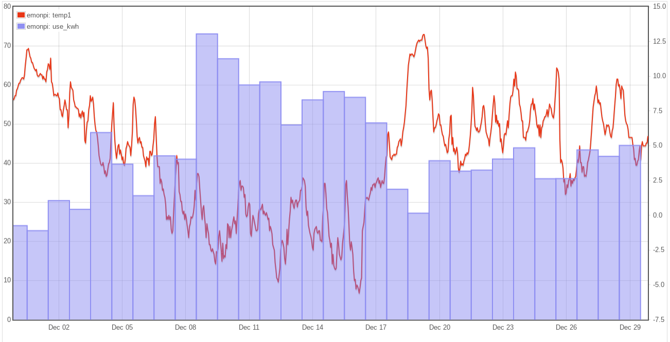

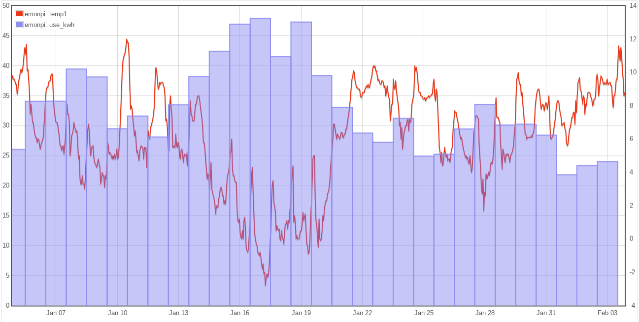

The purple bars below are the house's energy usage in kWh (left axis), and the red line is the outdoor temperature (right axis).
The temperature between the 16th and the 19th of January 2023 dropped just below zero, and our daily energy usage spikes to 45+ kWh per day.
We see the same pattern in December of 2022, with the temperature dropping into the deep minuses between the 7th and 17th of December.
Energy usage during this period is in excess of 50 kWh per day, and spikes to greater than 70 kWh on the 9th of December.

Is this lack of resilience simply due to the heat pump having to work harder because of lower temperatures?
Or does it point to a heat loss problem - how can I tell?
What are other people's experiences with heat pumps during cold weather - I expected more resilience to temperature changes.
