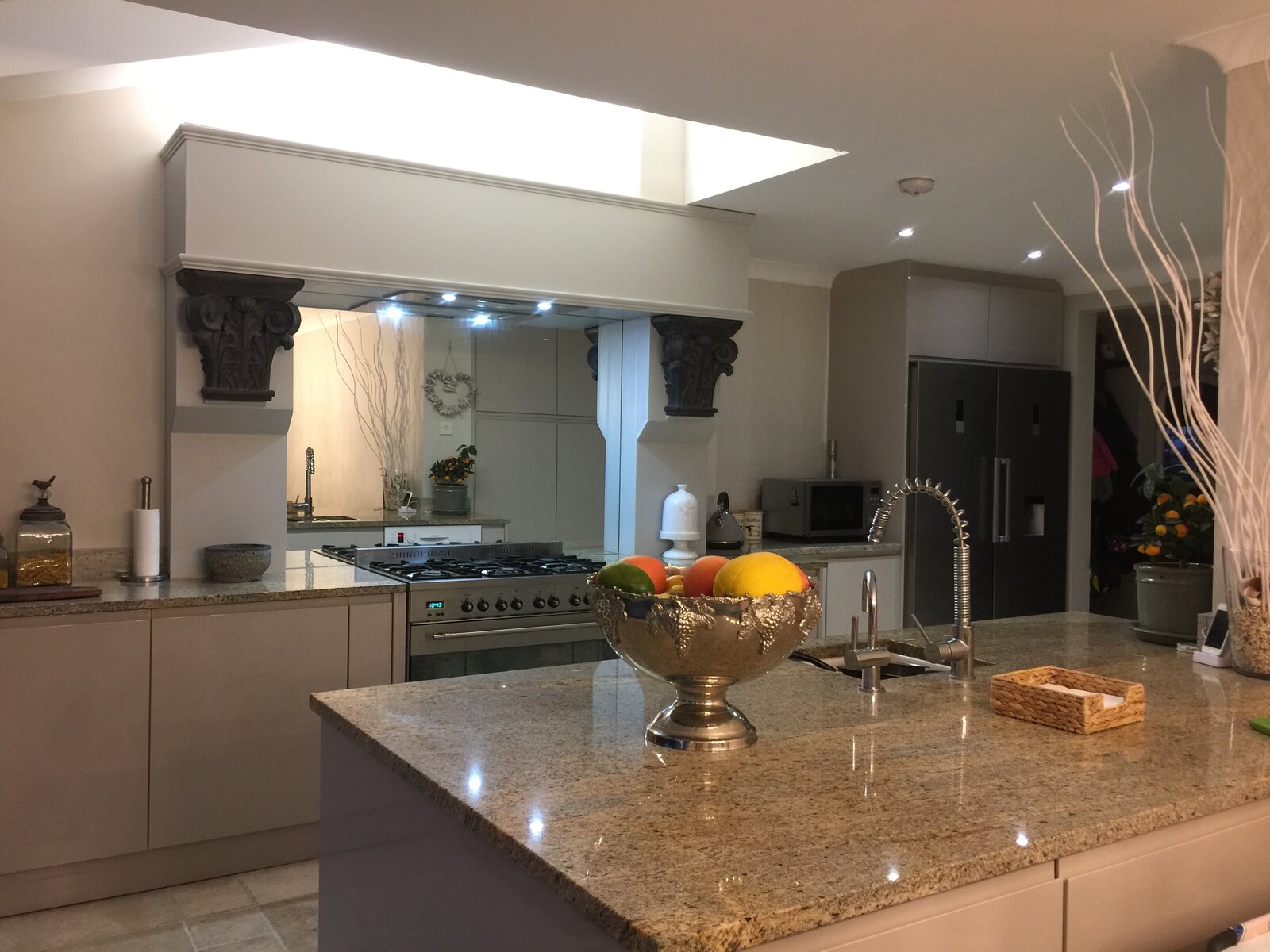

Put a 750 unit above a 900 oven, worked fine.
Hi, do you know how high above the job you installed it? Looks higher than the regular recommended 750mm.
Actually, that's not a recommended height. It's a minimum height.
