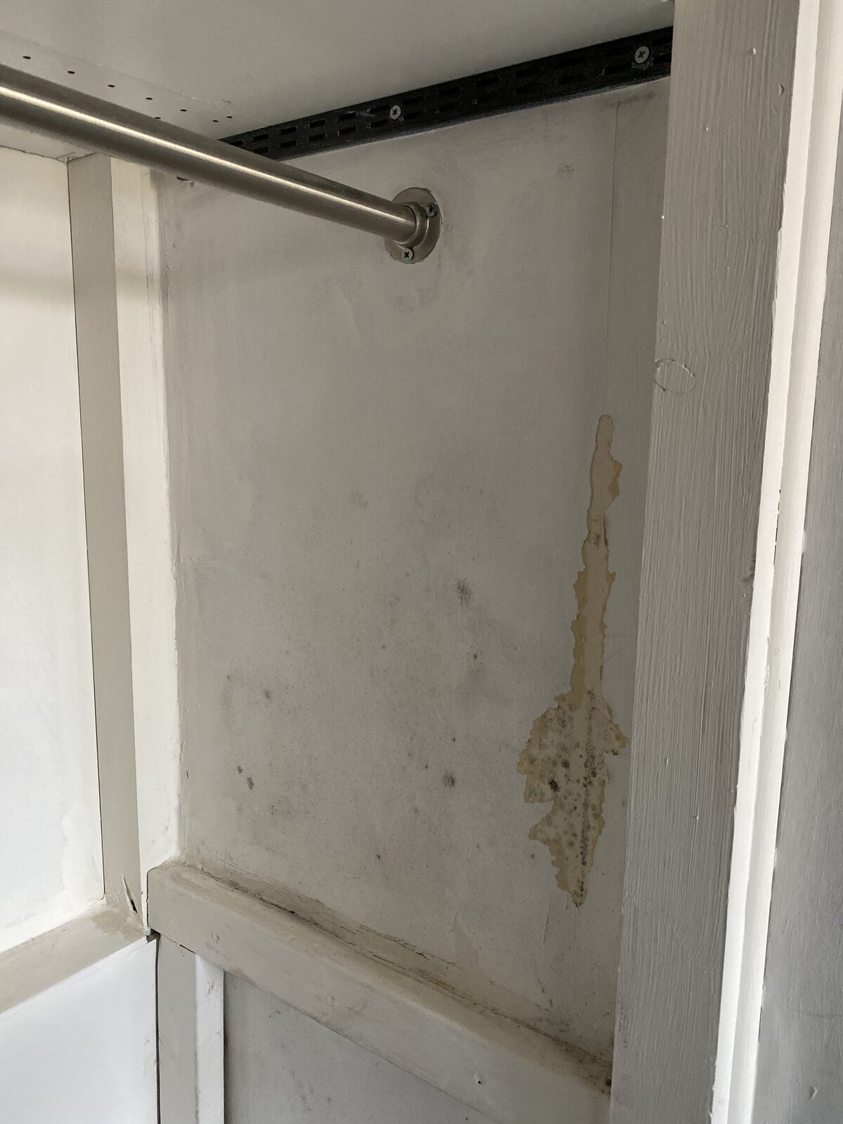

Hi all,
I've got an upstairs bedroom alcove with signs of mould on and under the paper. I've used a moisture meter to make sure the wall is now dry and I'm looking to redecorate but want to do it right. Speaking to a local decorator he said it needs a stain block, undercoat and top coat - is that correct? Will I also need some kind of filler/sealer to make the wall smooth due to some paper being missing? Any help appreciated! (Photo attached)

Presume it’s a solid brick wall, i.e. no cavity?
You might be able to get the mould spores off with a weak bleach and water solution.
I’d remove the pole and screw a piece of foil backed plasterboard over the area, cut the pole down and reattach.
It’s more than likely a ventilation problem and a cold wall meeting.
I agree that it is possibly due to a lack of ventilation.
Mr Chib's advice is sound.
If you don't want to go down that path then paint it with an alcohol, shellac based paint such as Zinsser BIN or Blockaide. They dry extremely quickly and can be recoated after 30 mins on a warm day. They will not allow the moisture to penetrate through to the plaster.
The white is slightly off white though, but is that an issue given that it is inside a cupboard?
With regards to filling over the torn paper. Apply the shellac paint first and use a filler of your choice. The shellac will prevent the water in the filler from activating the old wallpaper paste.

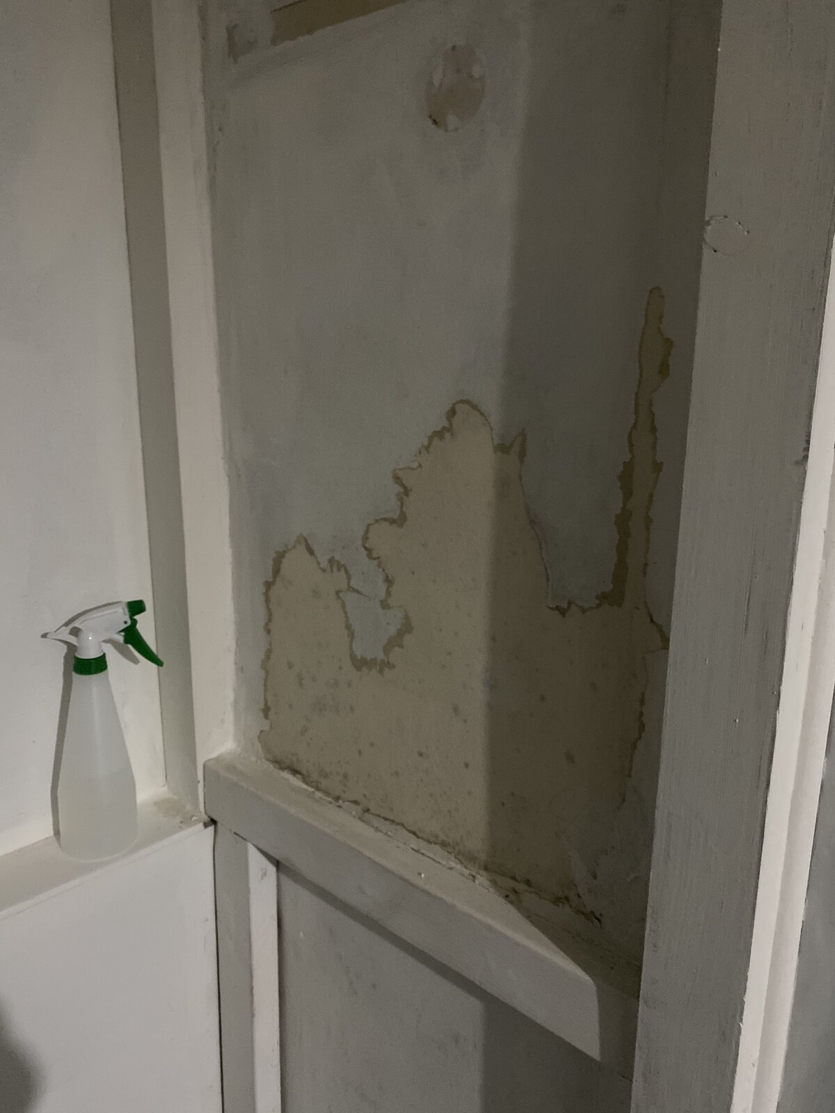

Trouble is I've had to remove a lot more of the lining paper to find and treat the entire area of mould. Is this too big an area for fine surface filler? I'm somewhat apprehensive about patch papering this section as I'm unsure what grade the existing paper is and how well it would go trying to blend the edges.
Why not just strip the section, it doesn't look very big

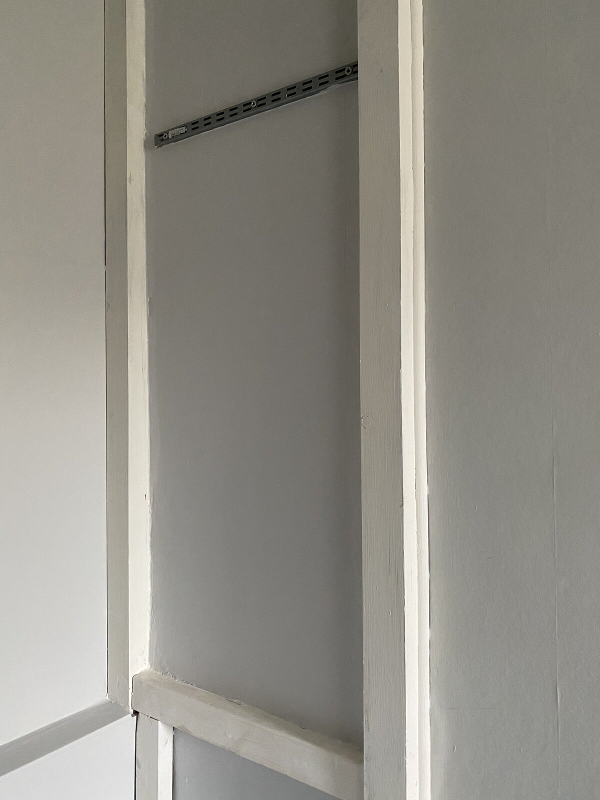

Due to the paper being trapped behind the wooden beams it would have been a bit of a pain to strip. Decided to go ahead with the BIN primer and filler, followed by more BIN and a final top coat to match the rest of the walls. Really pleased with the results, thanks for all the help!!
Well done.
BTW, if you had run a stanley knife down the edge of the timber, you would have been able to remove the paper.
Looks good though. Kudos.
