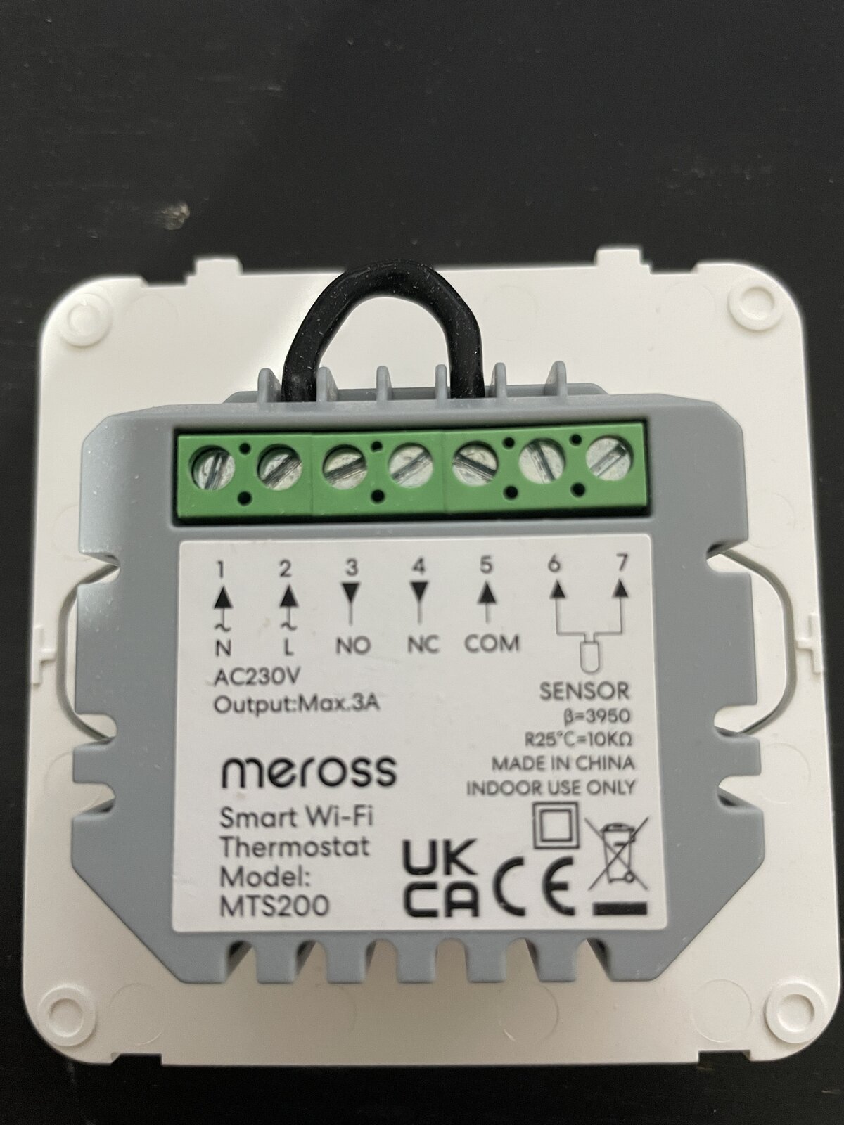

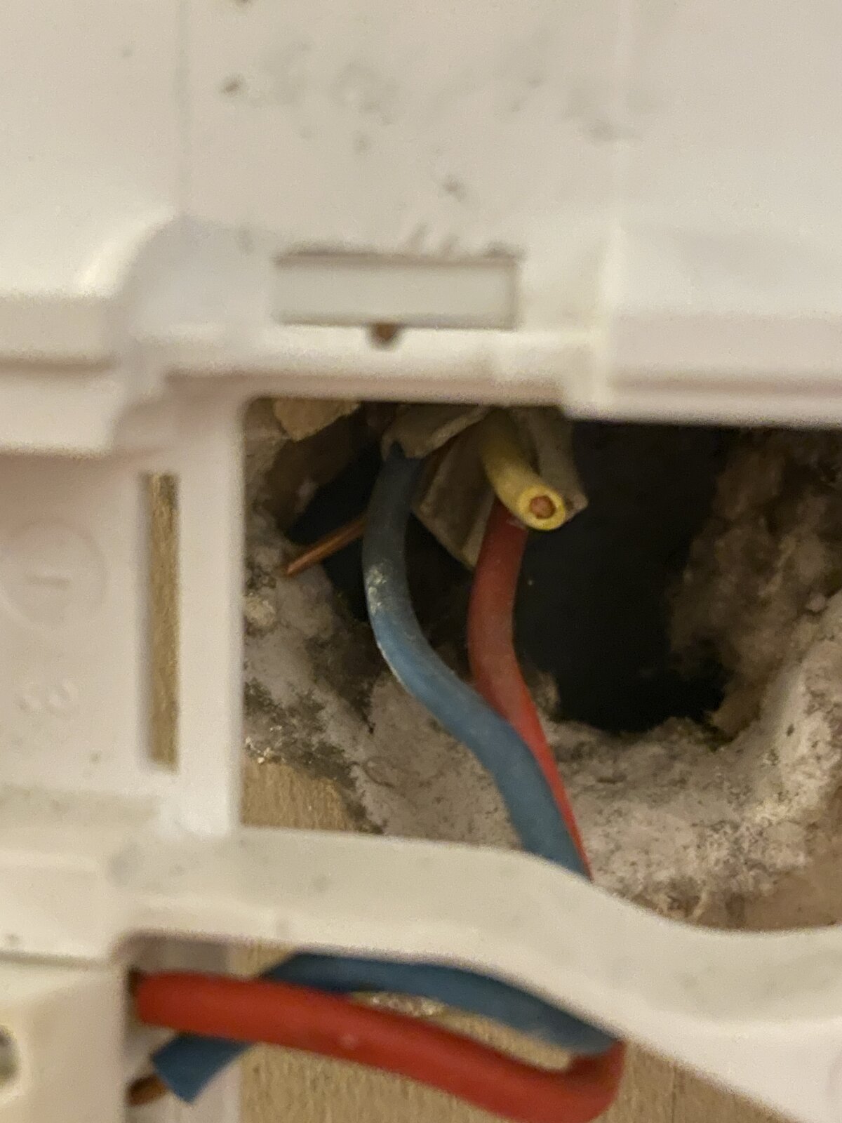

Hi, I have the Meross thermostat which I used in my old house without problems by connecting L, N and NO.

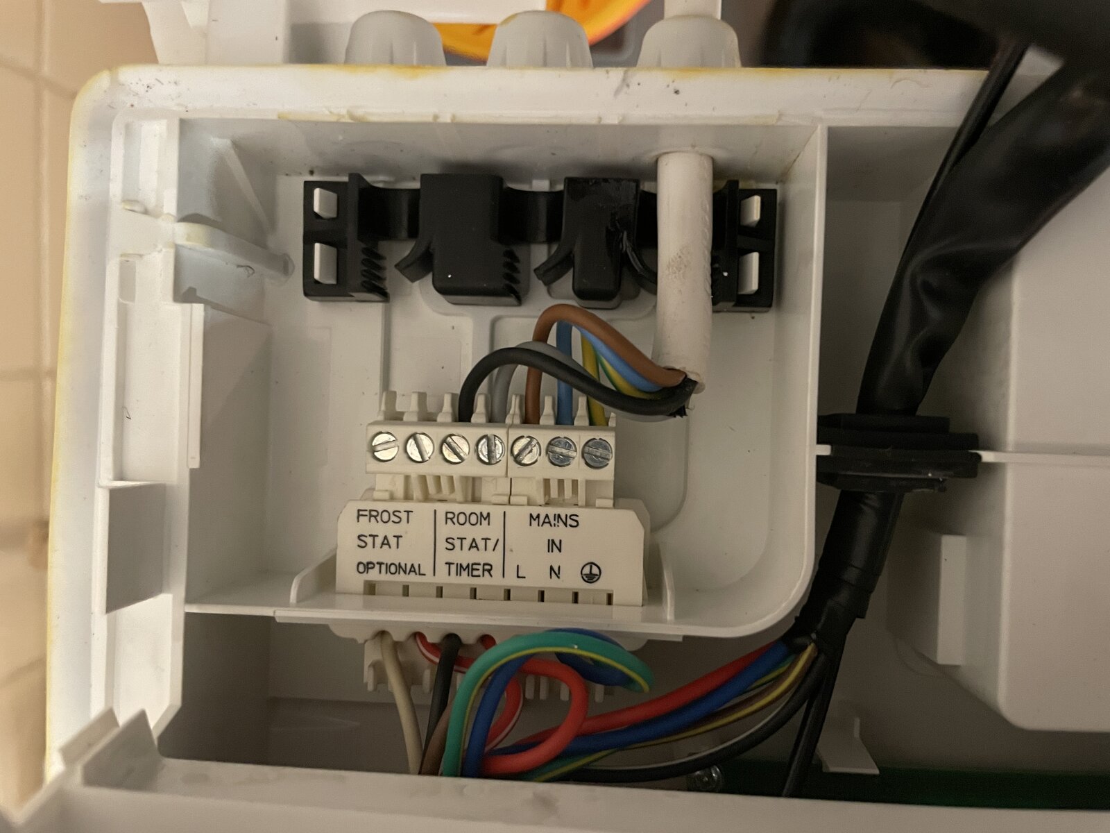

However the new house currently has a Honeywell T6 thermostat in the corridor and a Honeywell unit in the closet upstairs (I'm assuming there used to be a tank/system boiler previously).
The current boiler is a Ideal Logic combi boiler 35

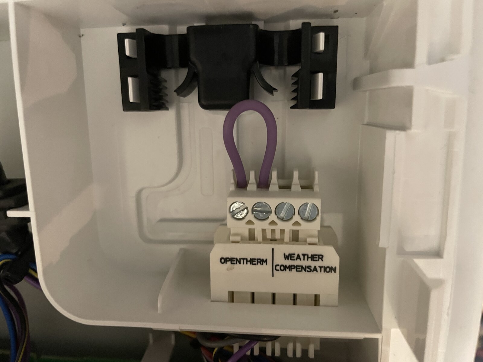

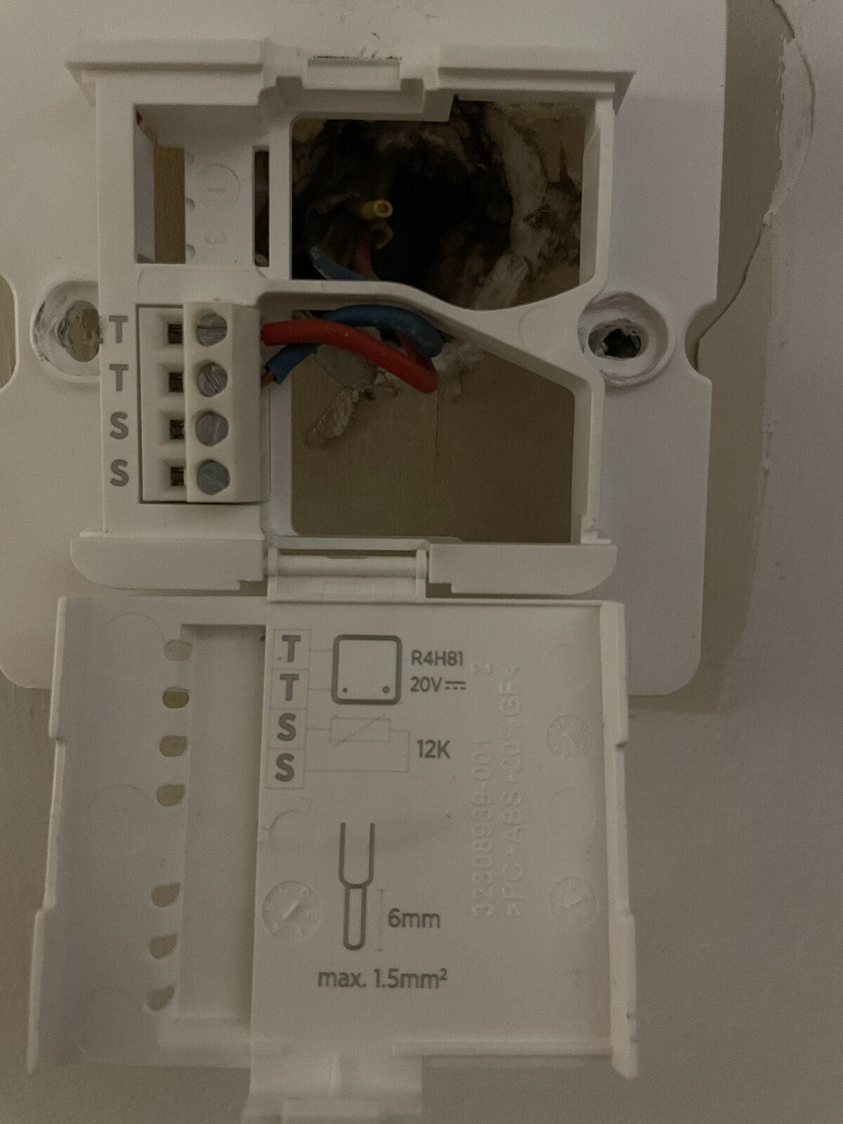

The main issue I have, and that's as far as my knowledge goes, is that there's only 2x 20v cables to the current thermostat from the honeywell unit in the closet.
However the cable itself is a 3-core & earth going behind the thermostat which might be useful.
I'm willing to repurpose the 3-core& earth going to the thermostat but I don't even understand what cables/signals does this boiler need so that it can be controlled with a thermostat.
Thanks in advance

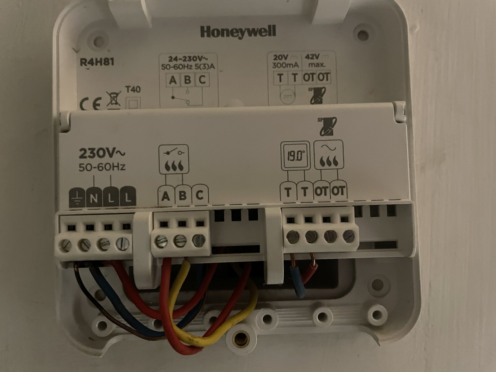

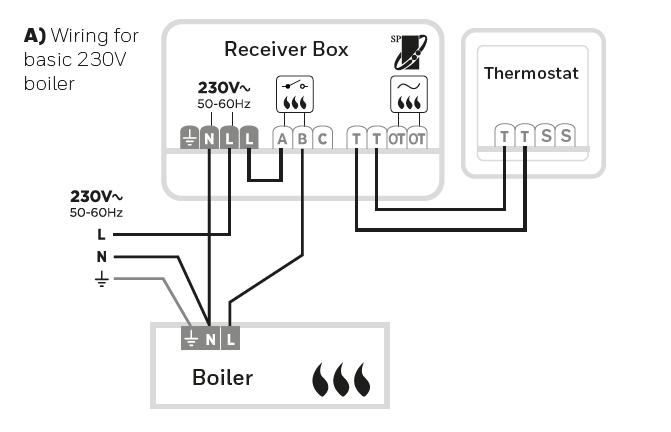

I don’t know why you want to get rid of a good thermostat, for what I see as cheap Chinese crap. What you have is mains switching and the 20v is to power the thermostat instead of batteries.
So to use the Meross place instead of receiver and use the same wires:
L to L
N to N
A to Common ensuring link is maintained
B to NO
Park and sleeve the cpc/earth
Test the boiler for safe functioning as you have removed the cover which forms part of the combustion circuit
Yes, the 3 core and earth should be reusable to power the Meross in the existing thermostats location.
However, to work out the wiring correctly, we could do with knowing where the grey and black wires to the thermostat/timer terminals on the boiler, turn into the red and yellow wires on the Honeywell unit.
The wires can sometimes be joined behind the FCU, or in a small wiring centre etc.

Looking at this
it seems the problem is the old thermostat is in two sections, and the new one is a single device. But somewhere
yellow and red become
black and grey, and I have no idea where or why. I can have a guess, that somewhere there is a motorised valve, or at least a junction box.

Thank you very much for all your answers. I've now successfully installed the new thermostat with the suggestions from @Stuckinarut.
So the B cable from the old honeywell box went to the NO on the meross as suggested, while the A was completely left out as it seems to be a spare Live from somewhere else (completely on it's own via another 3 core cable-and was not bridged to L as honeywell diagram suggested).
