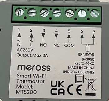

* The Meross does not connect to TRV heads, so may as well use Nest e which is smart and battery powered, so why use Meross?
