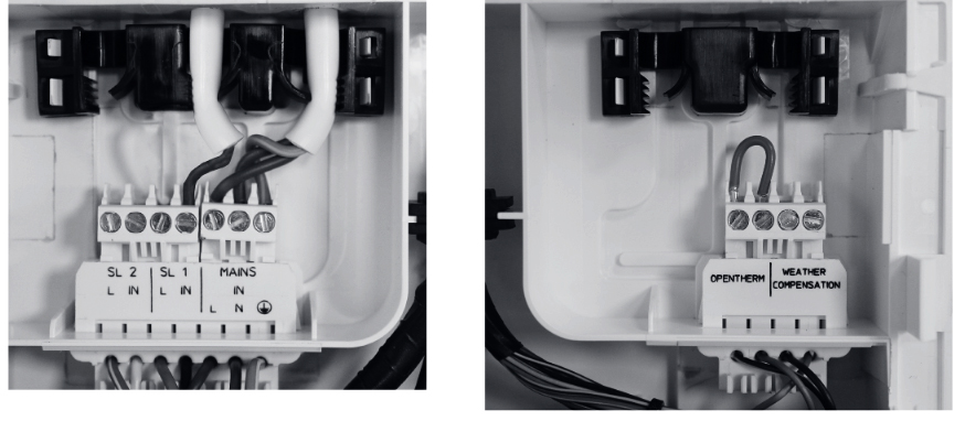

So we know that putting low voltage AC with other supplies within a cable can mean inductive or capacitive linking, and some boilers actually put the low voltage and extra low voltage on opposite sides of the boiler, clearly so one uses two independent cables.

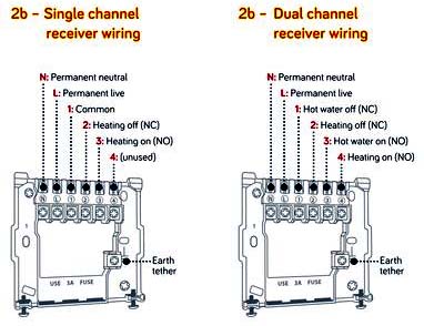

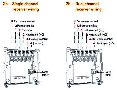

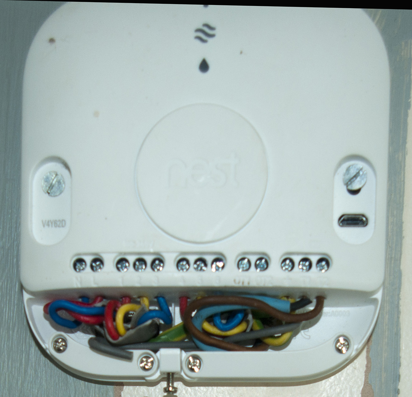

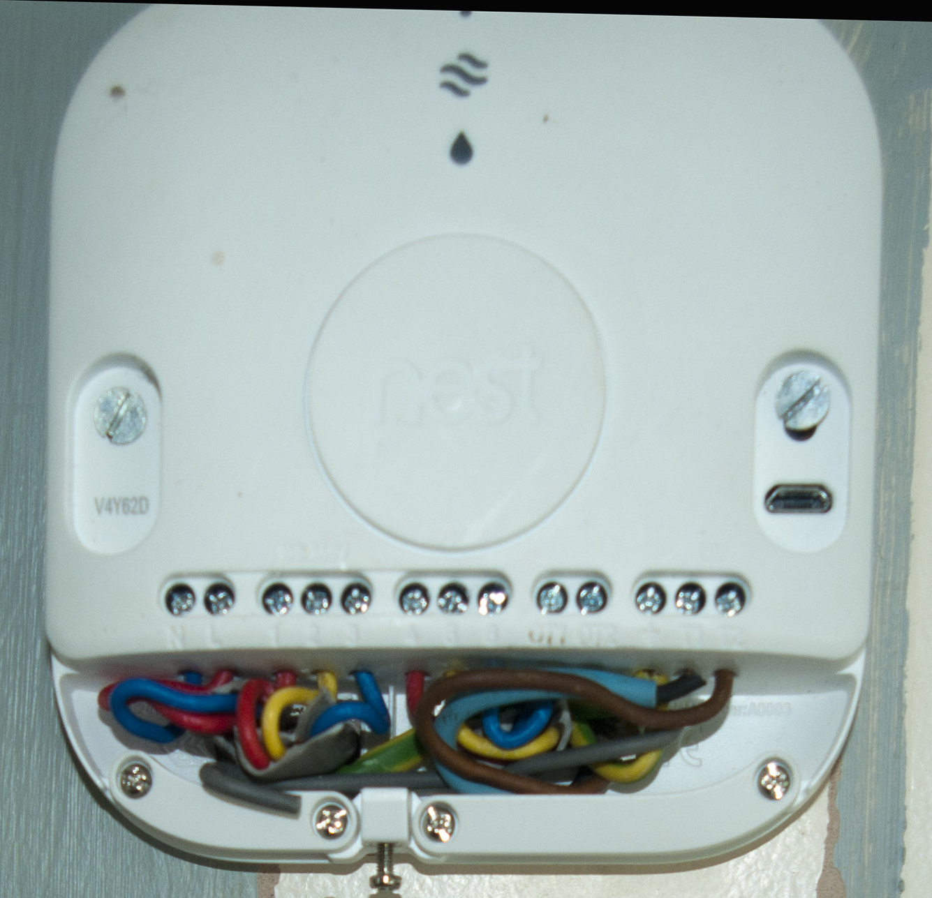

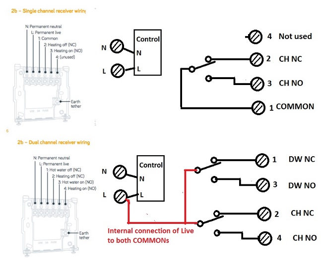

Some thermostats the supply to the electronics and relay contacts are common, like the duel channel Hive, others the relay contacts are not connected to the supply to the electronics like the single channel Hive.
Personally I think the way Hive uses the same back plate for single and duel channel is asking for problems,
If a duel channel is used to replace a single channel you could easy send 230 volt down 24 volt cables, different when some one actually needs to swap the cables, but just too easy for some one to fit wrong version. Nest it would need some one with at least some skill to change Nest heat link.jpg so unlikely anyone would mix up 230 and 24 volt. But even the boilers keep the extra low voltage and low voltage apart OT-lodgic.jpg the OpenTherm contacts are other side of boiler to mains supply. Be it keeping 24, 40 and 230 volt separate or two independent 230 volts separate the same applies, one has to work out what you are doing, and not wire by trial and error. However I have cringed when I have read threads where some one tells the posters you need to fit a link L to 1 without first making sure the boiler uses 230 volt control.
I agree with that. Terminal 1 can be floating ( single channel Hive ) or connected to Live ( dual channel Hive )
I wonder how many boilers with 24 Volt controls have been damaged by being connected to a dual channel Hive

Personally I think the way Hive uses the same back plate for single and duel channel is asking for problems, View attachment 214795 If a duel channel is used to replace a single channel you could easy send 230 volt down 24 volt cables, different when some one actually needs to swap the cables, but just too easy for some one to fit wrong version. Nest it would need some one with at least some skill to change View attachment 214796 so unlikely anyone would mix up 230 and 24 volt. But even the boilers keep the extra low voltage and low voltage apart View attachment 214797 the OpenTherm contacts are other side of boiler to mains supply. Be it keeping 24, 40 and 230 volt separate or two independent 230 volts separate the same applies, one has to work out what you are doing, and not wire by trial and error. However I have cringed when I have read threads where some one tells the posters you need to fit a link L to 1 without first making sure the boiler uses 230 volt control.
Sadly this is not a Hive issue.
This convention has been in place for many years, possibly 50 and I have come across some very wierd symptoms where a time clock has been replaced with the other format. In the day of all 240V control there was unlikely to be any damage so the format went unchecked.
But as you very correctly describe, there is now real danger involved with mixed voltages in modern systems. To make it worse It is an actual shock risk as the 24V side is/can be classed as SELV and SELV equipment may not be built to the low voltage [mains] standards.
