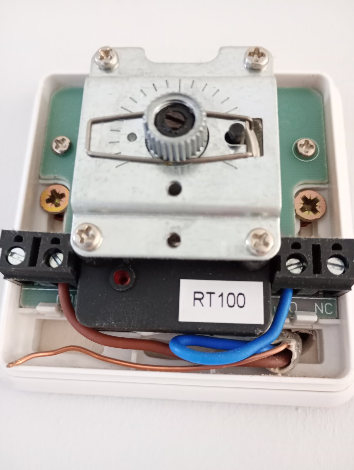

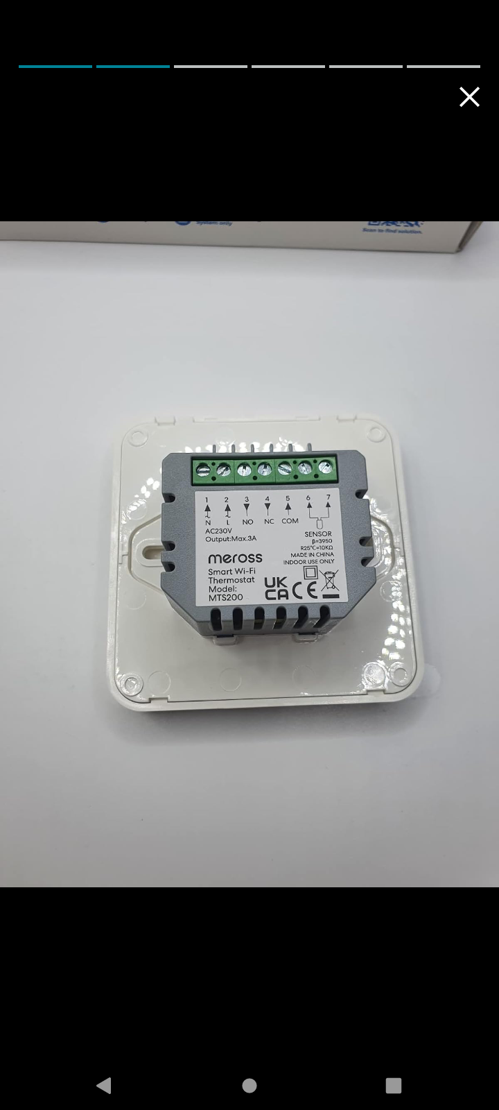

I recently purchased the Meross MTS200 smart thermostat.
It was to replace a Salus RT100 dial thermostat.
The Salus is connected with two wires as pictured.
Brown to COM
Blue to NO

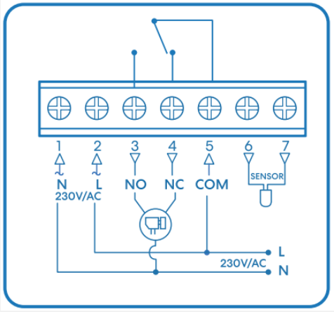

I have attached the Brown to L on the Meross and Blue to N.
I have then used the supplied cable to bridge to the COM from L.
There is no power.
I thought it would be a swap out. I am no electrician but can turn power off and swap things around :) but it doesn't seem to be as easy as I thought.
I connected the Meross to a plug connecting the Brown to L and Blue to N from a kettle lead and it powered on.
Any help to get it working?

Your blue that is connected to NO is normally open as in switched live, NOT a neutral wire. You need a permanent live and permanent neutral, and some earth sleeving for the earth/CPC.

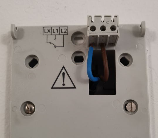

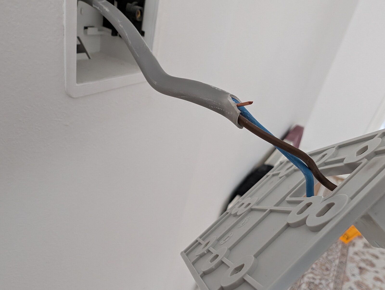

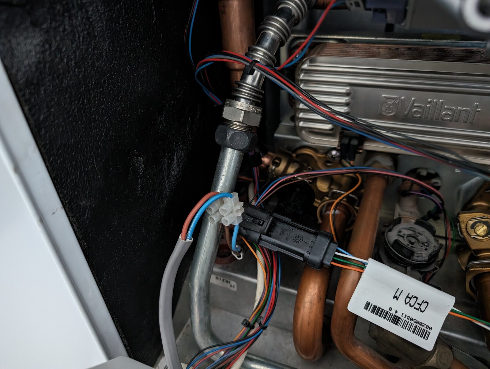

I have more or less the same question. My current thermostat is a battery operated one and would like to change to Meross thermostat. The current cable seems to be a twin & earth (3 core) but the thermostat uses the brown and blue only. My question is, can the 3rd non used copper be used as a neutral and connected directly to my Vaillant boiler (if possible) or if not, to a spur near the boiler and be fed to Meross in the living room?
I asked Meross and they said that their thermostat is not suitable for Vaillant, nor my cabling. I have found their answer a bit odd.
Please see the attached files, my current thermostat front & back, the boiler connection and the Meross MTS200 diagram.

Ignore the existing cable colours, you need to add a permanent live and neutral.
Thank you, I don't think adding another cable here is feasible, can you kindly advise if I can add a Nest thermostat to this set up? (Not the battery operated one). I believe Nest has a device called heat link which I can get it installed next to my boiler and I can arrange extra power if needed to this device, however the thermostat itself needs to be in the living room and this is the only cable (twin & earth) can be fed to Nest thermostat.
Yes you could add a nest, the existing wiring might even be able to be used to power the thermostat from the heat link, depends on sporious voltage. The cable which is being used currently isn't correct either as it's not really heat resistant. You'd need someone in too as the cover forms part of the combustion circuit and needs checking for safety afterwards.
Can I ask what is wrong with the existing thermostat? Seems odd to swap an on/off for another on/off.
I am most of the time away from the property and need a remote solution to turn on and off the heating. I already use Meross brand and quite happy with it that is why it would be my 1st choice. If that does not work, I already have a Nest thermostat that bought recently at a very cheap price and was planning to use it somewhere else but no worries.
Can you please advise further on this? I will get a professional person to fit Nest and they can use the existing cable?
The cable is twin and earth, and is only heat resistant to a certain temperature. Heat resistant flex cable is in the region of approx 95 degrees Celsius, so able to withstand bing near the heat from the boiler. They could use the existing cable where it enters the boiler and pull back through, providing it doesn’t cause sporious voltage.
