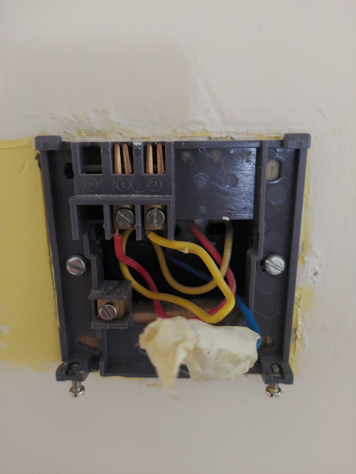

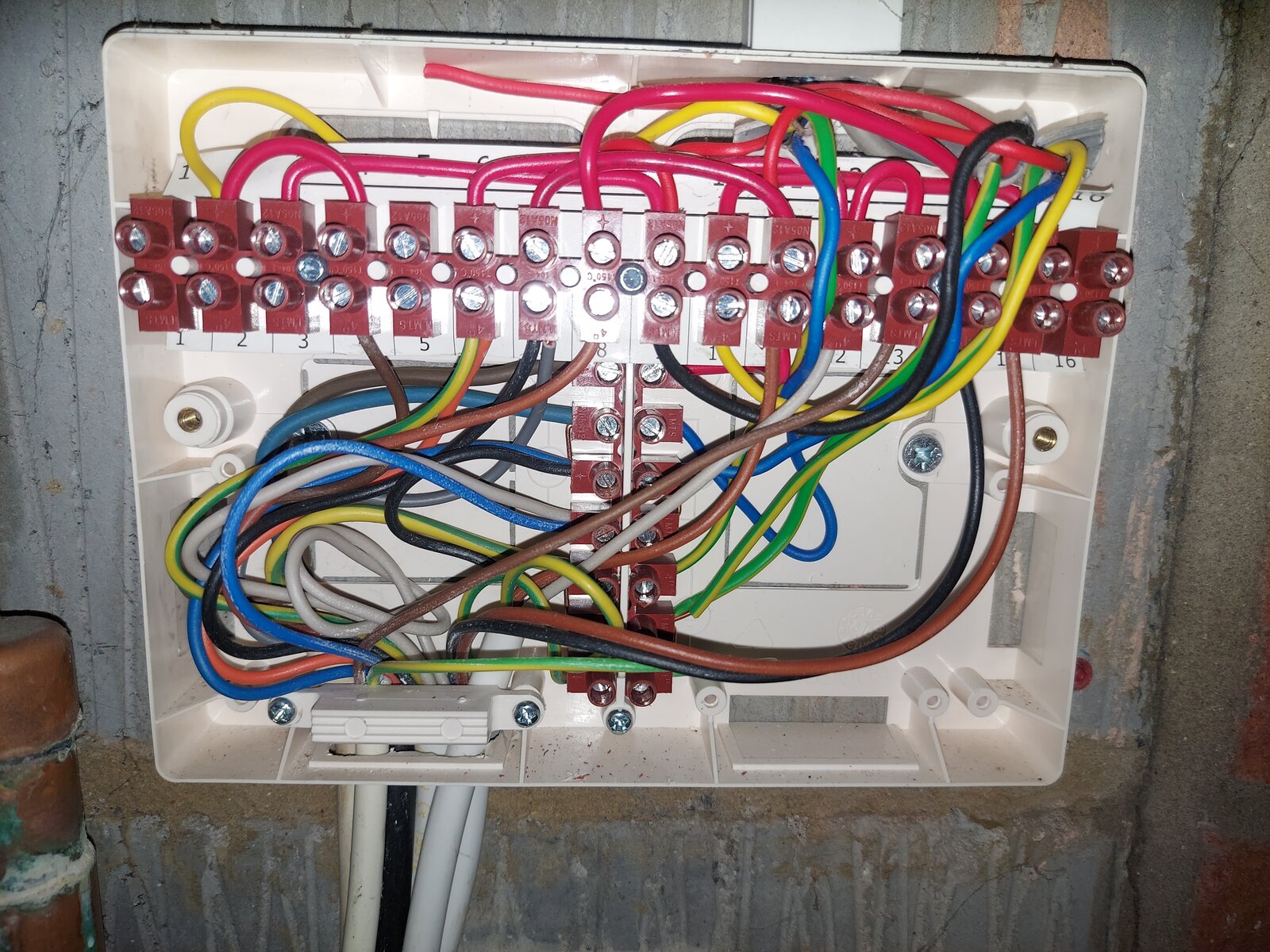

I bought a Meross MTS200 smart thermostat to control our gas boiler for the central heating. I then realised that the existing thermostat (Salus RT500) is on low voltage, despite the 3 thick wire feeding it (See picture). I would like to replace it by the smart thermostat Meross MTS 200 that requires line voltage (230V), without having to bring a new wire to the thermostat, which will be a major piece of work (cost, dig in solid wall, repaint, etc...). I wondered if there was something that could be done at the boiler terminal point, to convert the line to line voltage, since main line voltage feeds it the terminal (see picture attached). Thank you for anyone that can help.

If this is the cable connected to the thermostat...
The Red wire could be live and the yellow, a switched live.
The blue wire appears to be connected to the neutral bus at the wiring centre.
However, do you have a central heating controller on your system, in addition to the thermostat?
If you have a separate controller, the red wire may not be a 'permanent' live.
For simplicity, you can set the controller so that the heating is constantly on, or you could link the controller out at the wiring centre.

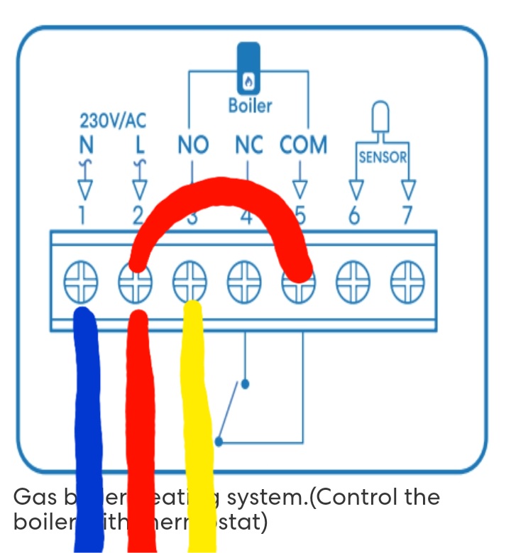

If the above is true, you can try and connect...
Blue wire to N
Red wire to L
Yellow wire to NO
And add a small link wire between L and COM
and see if that works.

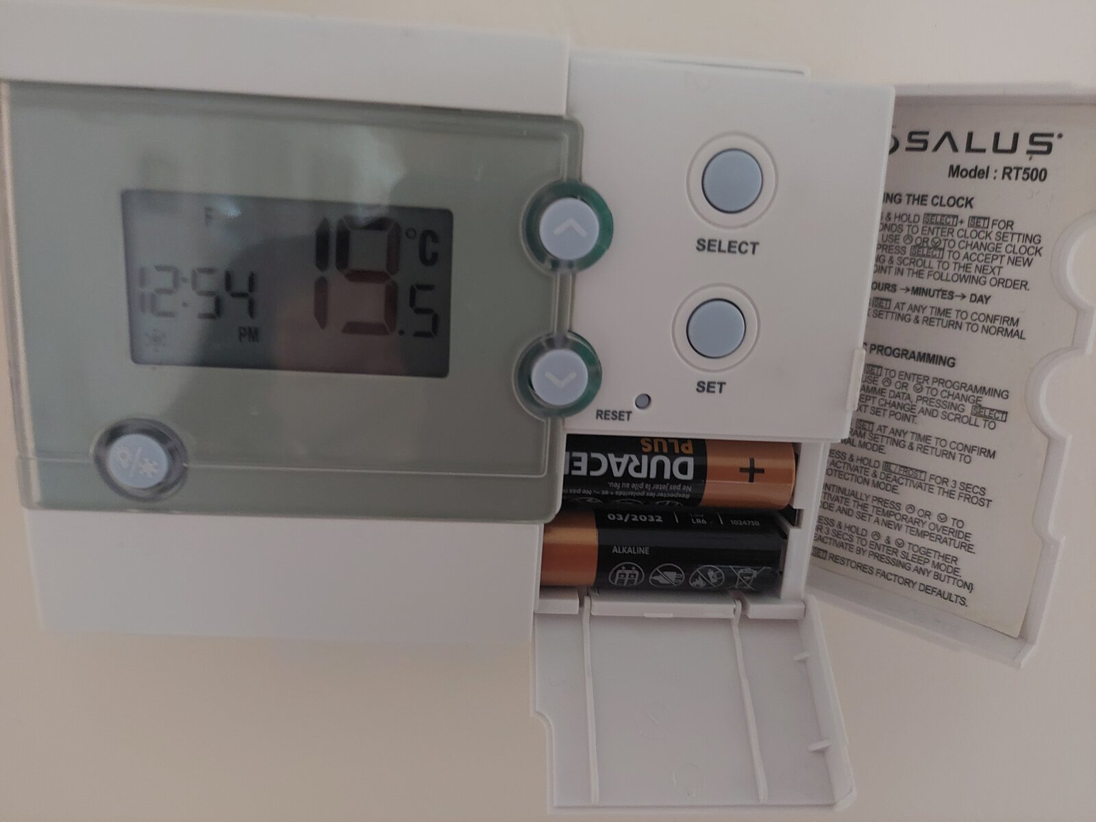

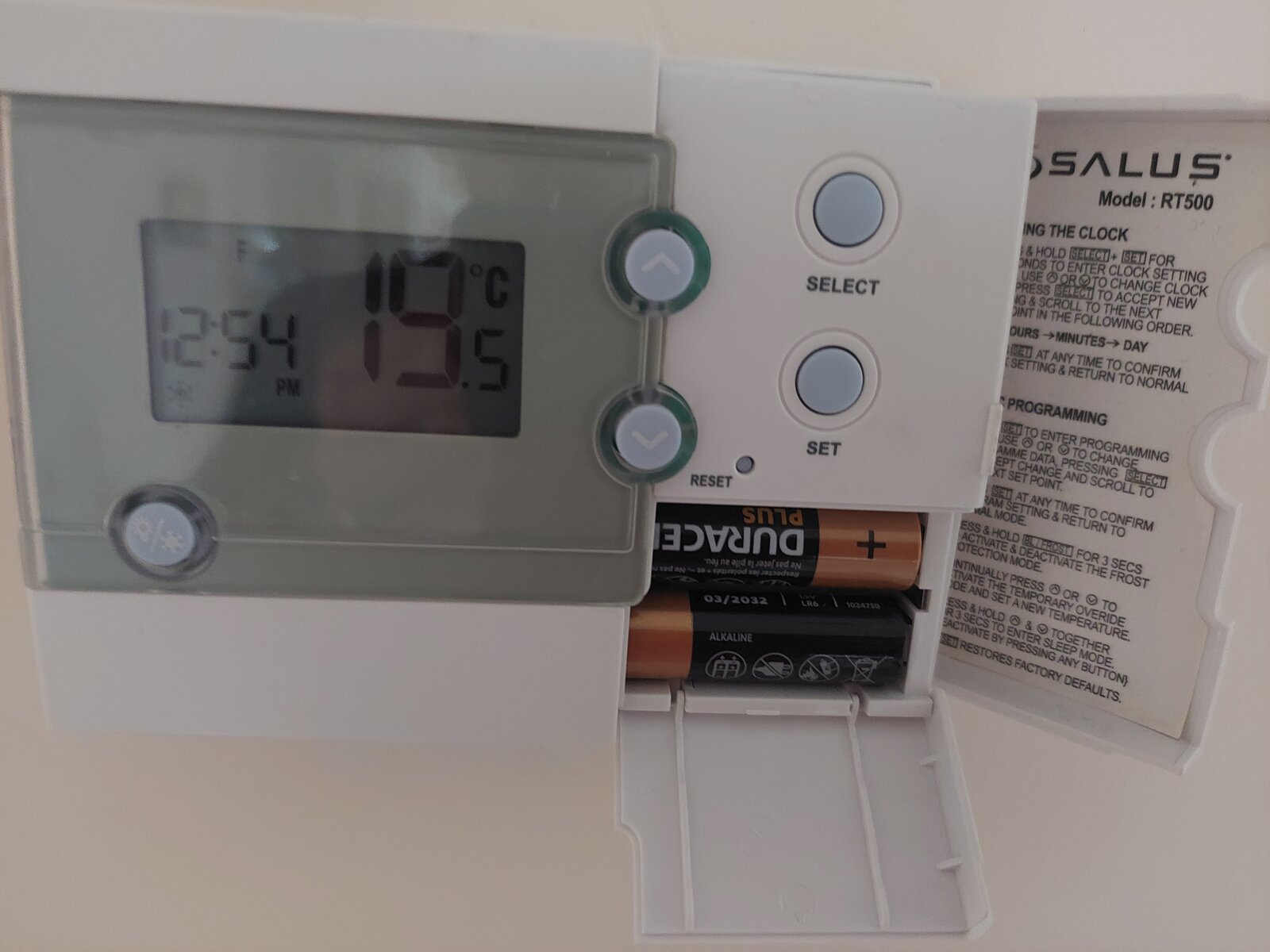

Thank you all to your replies and sorry for the delay of my reply - I am new to DIYnot and did not seem to have received notifications of your very useful replies. I am going try to answer the questions you all asked. The reasons I don't believe that the 230V is getting through the wires currently coming through the wall and connected to the Salus Thermostat are that I have measured the voltage with a multimeter, and I am getting pretty much nothing, which explains why my smart meter does not come on at all when connected to these same wires, and when measuring voltage from a lead coming directly from a plug, I am measuring the expected 230v+, which do turn on the new smart meter. Might not be relevant, but I have attached a picture of the Salus Thermostat, which shows batteries, and when I remove the 2x1.5V, the thermostat screen turns off... which I assume means that few Volts are getting through these wires. To answer questions asked by RandomGrinch, in addition to the thermostat, I do have a central heating controller on a wall too, allowing me to program on/off on the heating and water system, and when times come, I put it permanently on "On", and thermostat then send signal to start boiler system (or not) for the radiators. As well, I did exactly plug the wires as per your diagram. I am keen to avoid to go for a different thermostat like Nest E, as that would be an additional £100 of spending considering I already have a new thermostat... so keep to use your kind help and knowledge to get 230V through these wires. I am rather lost as I do read like you that the Salus RT500 should be fed by 230V. Thank you all for any of your further replies.
@Banjara please can I repeat above, and to clarify to you how the Salus thermostat works and to save you more worrying about the old thermostat.
The power for the operation of the Salus thermostat is powered by the batteries. The batteries provide all of the operation of the stat including the display. It does not require ANY other voltage, mains or any other voltage to operate.
When the logic turns on, it operates a relay (basically a switch) and this closes two contacts. These are known as volt-free contacts.
This tells the boiler to turn on . Some boilers use mains voltage to start. Some use lower voltage. Your system uses mains voltage.
The instructions for the device are, I admit, misleading as the backplate connections are called Mains live and switched live, but that is not necessarily how it works in all cases!
The boiler system, the valves and your wiring is 230v mains, and your new Meross MTS 200 also requires this for its power and operation.
I hope this helps.
@Taylortwocities, thank you for your message - Ok, I understand that the Salus Th. doesn't need 230V to operate, but now my hope, is that following @RandomGrinch 's comment, If my programmer is on, those wire carry 230V (like the rest of the system), and therefore allowing me to just install the Merros and by turning on the C/H controller, the smart thermostat working. You are saying that Salus is battery operated, but when plugged in to the wall, and taking battery off, it still works! I thought the batteries were just here to not lose the temperature program set when removed from the backplate. I'll carry out the measures suggested by RandomGrinch and report the findings :). Thank you
No. I am saying that if you leave the batteries in. Remove the Salus from the wallplate, the thermostat display will still work and, if you turn up the temperature you will hear a click as the internal relay switch on. It wont switch anything because it will not be on the wall plate.
No, no!!!. The batteries are there to operate the device. It has nothing to do with being on the wall plate or the boiler wires.
If you can't grasp this then you are going to have problems with your next step....
