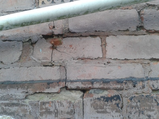

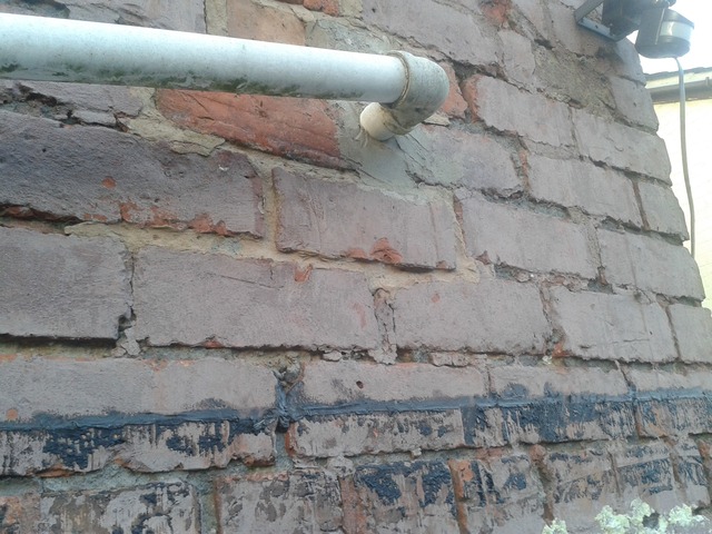

I've just built a verandah,
but now i have some water leaking into the kitchen through the wall, the beam i used the wood did not sit flush against the wall so the bolts were exposed but beam secure, i've used self adhesive flashing and expanding foam under the beam, which does not appear to have worked, can anyone advise what i could do to resolve this ?
is there anything i can use to seal the holes as this has only happened since i did the verandah
thanks.

sorry let me explain again
the wood beam i used was not straight as was most of them i saw at b and q etc, so 2 bolts are in half way but half are exposed as is the hole i believe this is where water is entering the kitchen as the leak is adjacent to these 2 bolts and the leak only occurs when the rain is heavy.
i've used flashing tape above the corrugated roof but no flashing on the beam itself.
i was thinking to use rubber bolt washers with some guttering seal around them to try and stop water entering.
Sorry still not following you can you post some pictures.

I'm at work at the minute so cant provide a pic, but i've done a little illustration on paint hope this explains it a little.
thanks.
Ok updated, i've removed the sheets away from the beam and soaked it with a hosepipe but no water comes through the wall, i just wonder if water was getting trapped behind the beam and then soaking into the wall as it had no where to go ?
Would the bolts not pull the wood straight if you tightened them more?
Sounds like you need to cut into the mortar above the wood and point in a Lead or Ubiflex flashing.
Is it possible you have bridged the cavity in some way allowing water in the cavity to seep across?
not sure but if i have whats the solution ? but what i dont get is why i cant recreate the same issue with a hose pipe.
another important detail i should have mentioned i did not use primer with the tape just stuck the tape on i presume this would have allowed the water to soak in and penetrate behind ?
