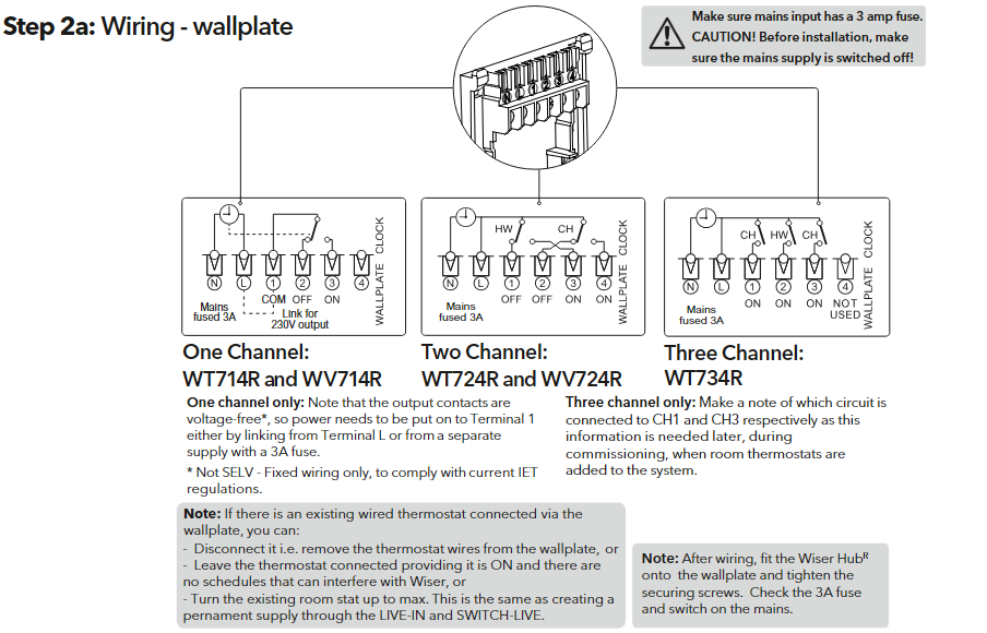

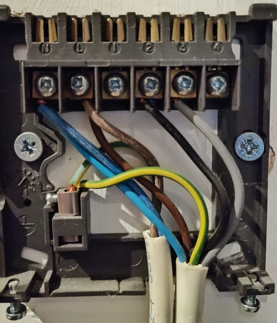

Help wiring Drayton Wiser Kit 1

No link only required where it’s not provided, yours is from the boiler. Black would go to Com and grey to On
