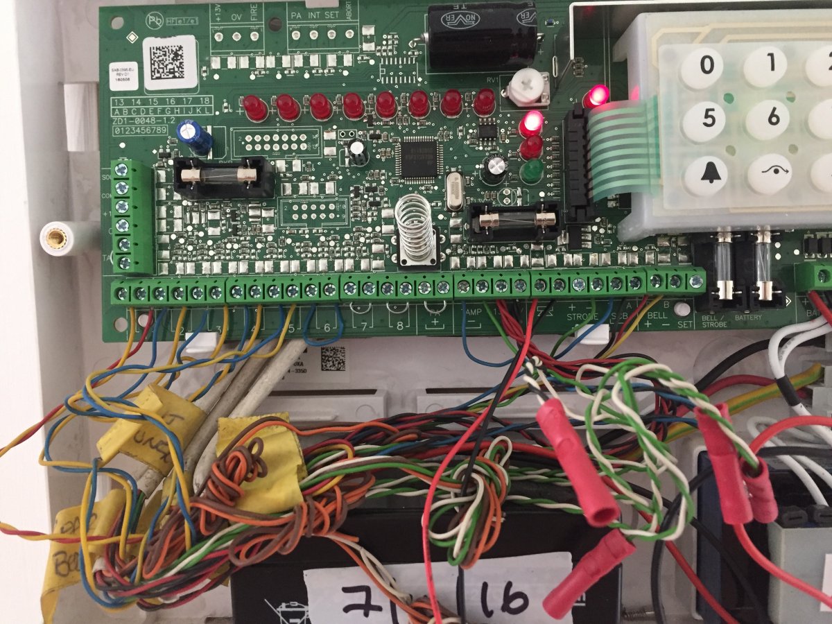

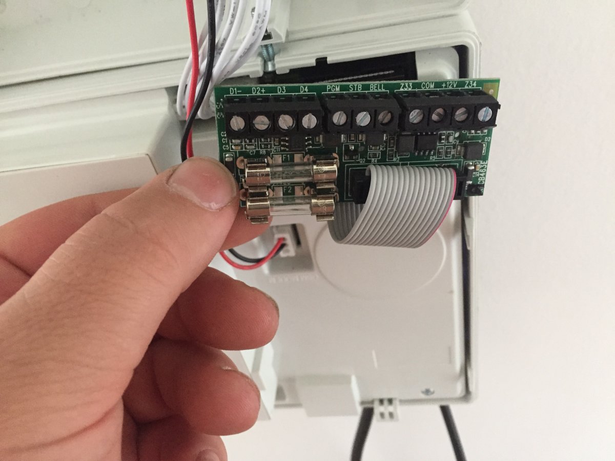

Hi,
Wondering if anybody can help with this.
My current panel is ade optima compact with lumin8 bell box & im replacing the ade panel with a pyronix enforcer panel & would like to keep the lumin8 bell box if possible.
Can anyone provide me with some wiring details? Want to avoid getting upto bell box if possible as I've got a leg injury.
Cheers Lee

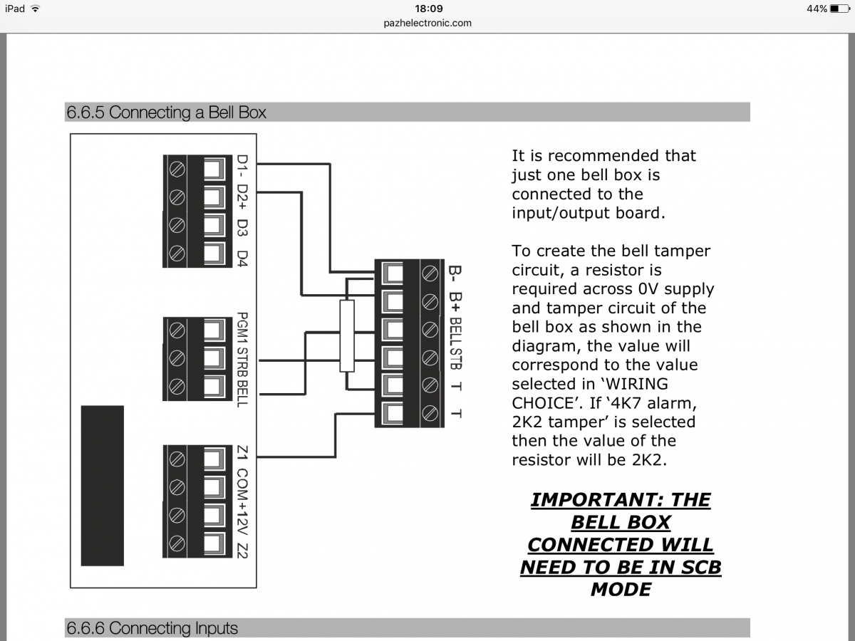

As per the diagram in the enforcer manual !
Problem may be if the enforcer can run the Risco bellbox as you would normally run the bell in SCB or low current mode , you may have to get to the bellbox anyway If scb is available on that bellbox
