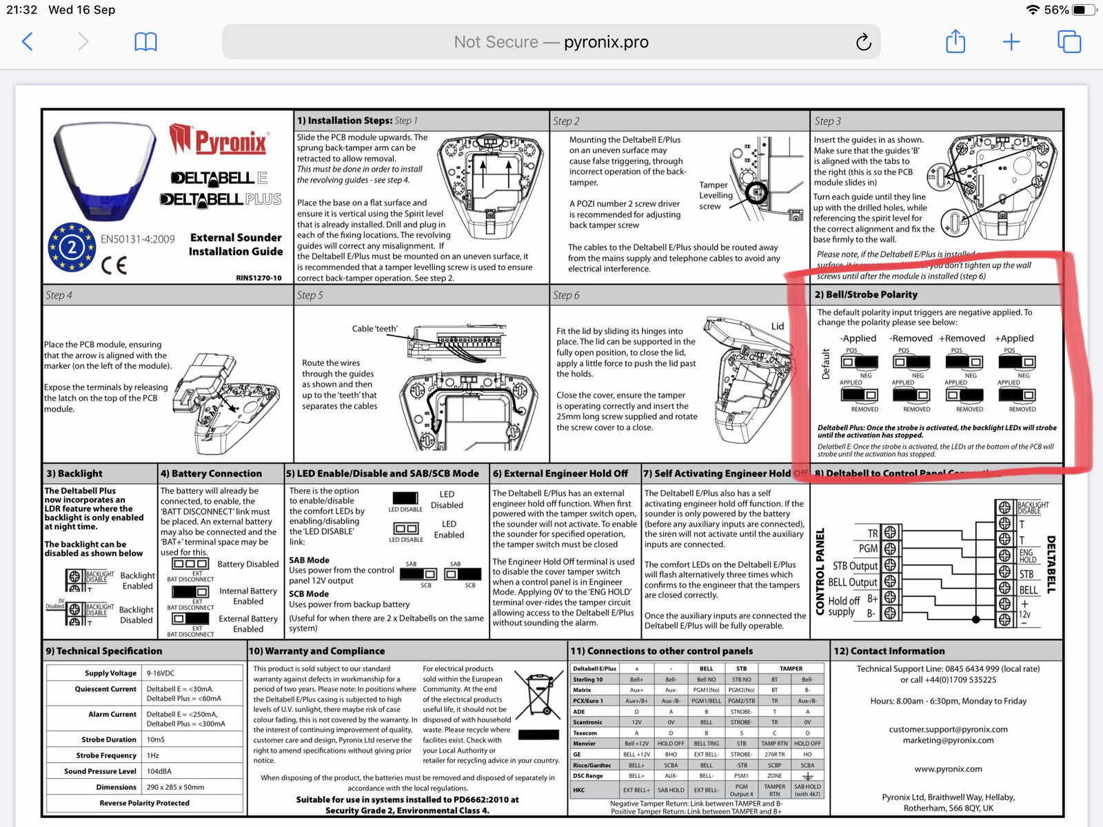

Losing my mind a little, I’ve got a pyronix enforcer alarm system and a deltabell external sounder.
I have lights etc on the box however when I run a siren test from the control I’m not getting anything.
On the panel my outputs are 14 strobe and 16 bell...is there something I’ve missed out?
It’s wired...
bell to bell
Strb to strb
+12 to +12
Com to -12
Tamper to z33
And then I have a link from T2 to -12 on the bell box.
Thanks for your help in advance.
As in by accident or certain ones that I should have moved? Thanks
So the bottom line of jumpers in your screenshot is what it should be for the deltabell x correct?
