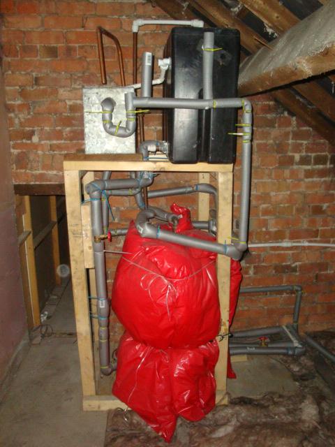

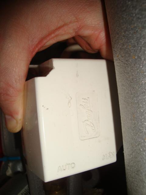

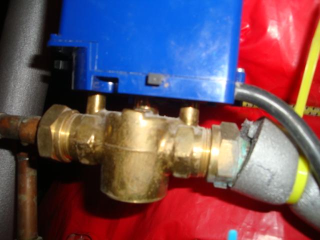

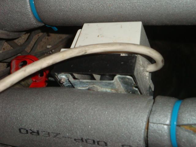

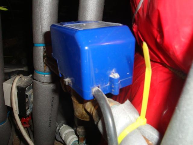

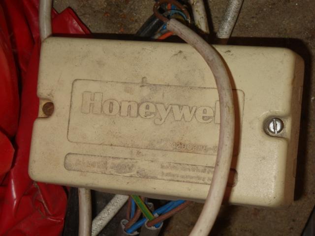

Ok , got some piccys that may help.
This is the system from a wide angle
This is the valve that does work when the cylinder stat switches on or off
This is the other one i can see but doesn't seem to do anything
This is the box they are all connected to
It could be all sorts of things, but very likely the grey topped valve is not working, and has been latched in the MAN (open) position, so you get CH heat when the hw is heating.
Very likely it isn't wired properly as well, if the same guy who did it as got the timer configuration wrong.
Get the dud valve working, which may mean a new motor or a new head or a new valve. Unless it's just not connected!
Then Start over. Identify all the wires which go into the connection box - write it down.
Then connect as per the standard layout, and it'll work.
Sounds simple, but first time you go in there, there's a lot you can get wrong.
Alternative is to call a heating engr, who will get you sorted in an hour, unless either
1) there are wires missing
2) he needs to change the whole valve
3) you have multiple faults.
