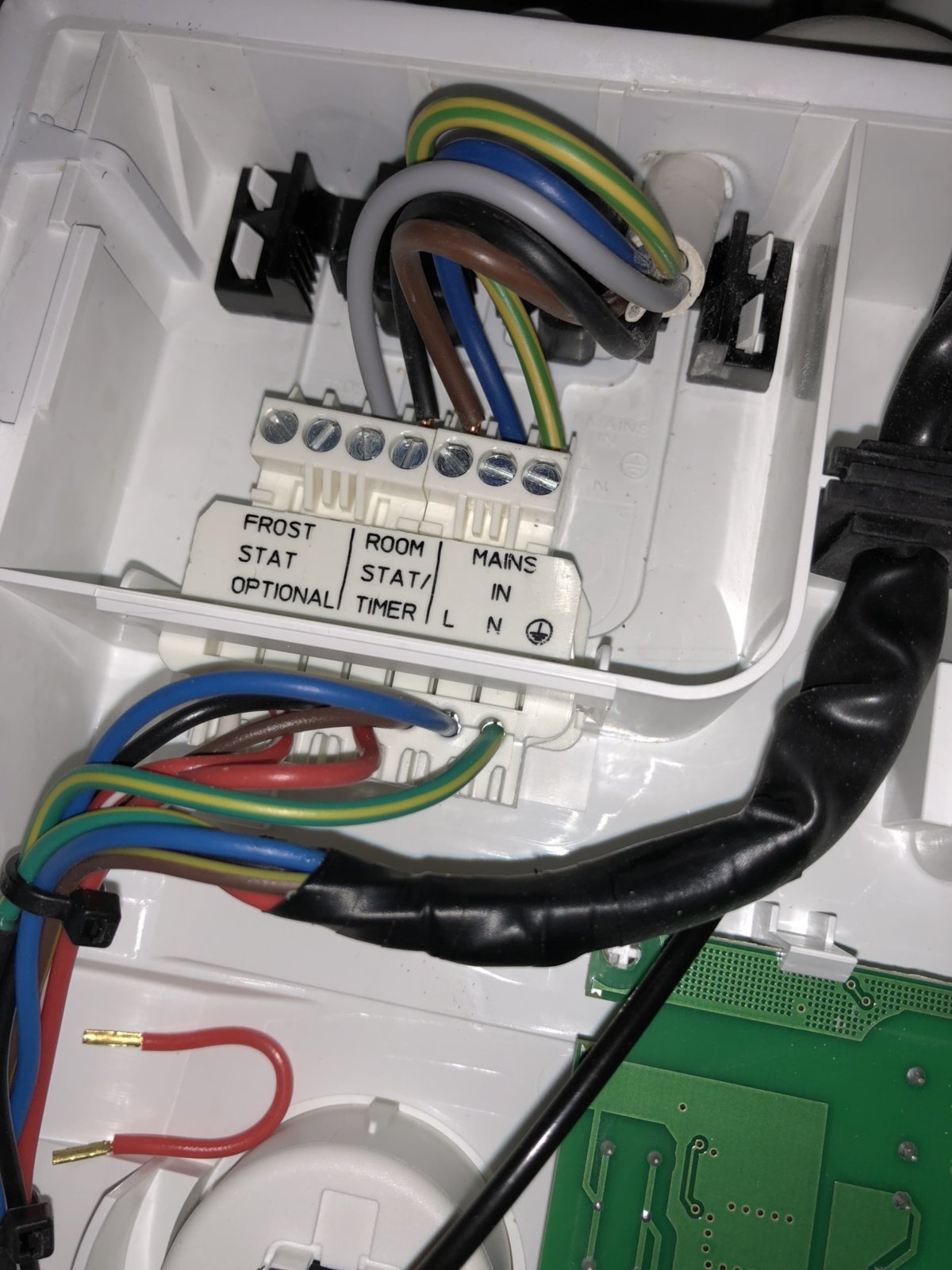

Could anybody help how I would wire this up to my hive please .

It would appear that you already have a room thermostat connected via the black and grey wires. That should be disconnected and removed. Then the two vacant terminals that presently have the grey and black wires in them.......

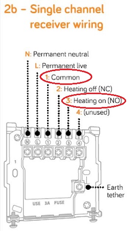

....would be connected to the Hive (Single Channel Version) terminals '1 Common' and, '3 Heating on'. It doesn't matter which way around that they go.

What about the earth wire do I need to just ignore that part and just wire in what you have said. Do I have to put the grey wire in or can I just put the black wire in?
Where would the brown and blue wire to then the green and yellow?
Sorry to as 101 questions
The grey and black wires will go to the existing room thermostat. As I said before, the old thermostat, and the existing wires to it should be disconnected and removed.
The then vacant terminals where the black and grey wires were connected to, should now be connected to Hive terminals (1) and (3)
The other wires below won't change. Leave them connected as they are. This is the mains supply for the boiler.

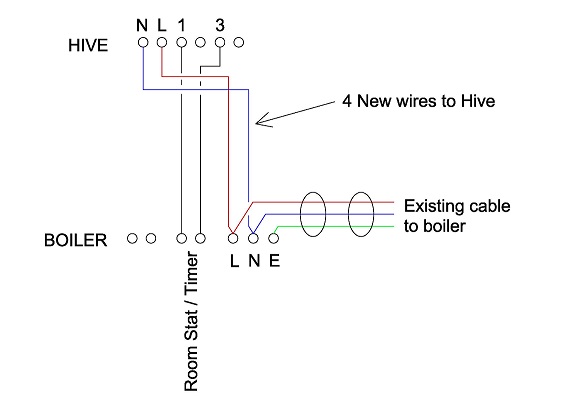

Plus you need the 230V to power the Hive. Once the old room thermostat and wiring is removed, this is how the Hive should be connected. I've shown the 230V connected to the boiler terminals, but if it's easier for you, you could wire it directly to the fused spur instead as I described earlier.
Although plan shows 4 wires, you actually need 5, the earth is not actually used, but regulations require it is run even when not used.
