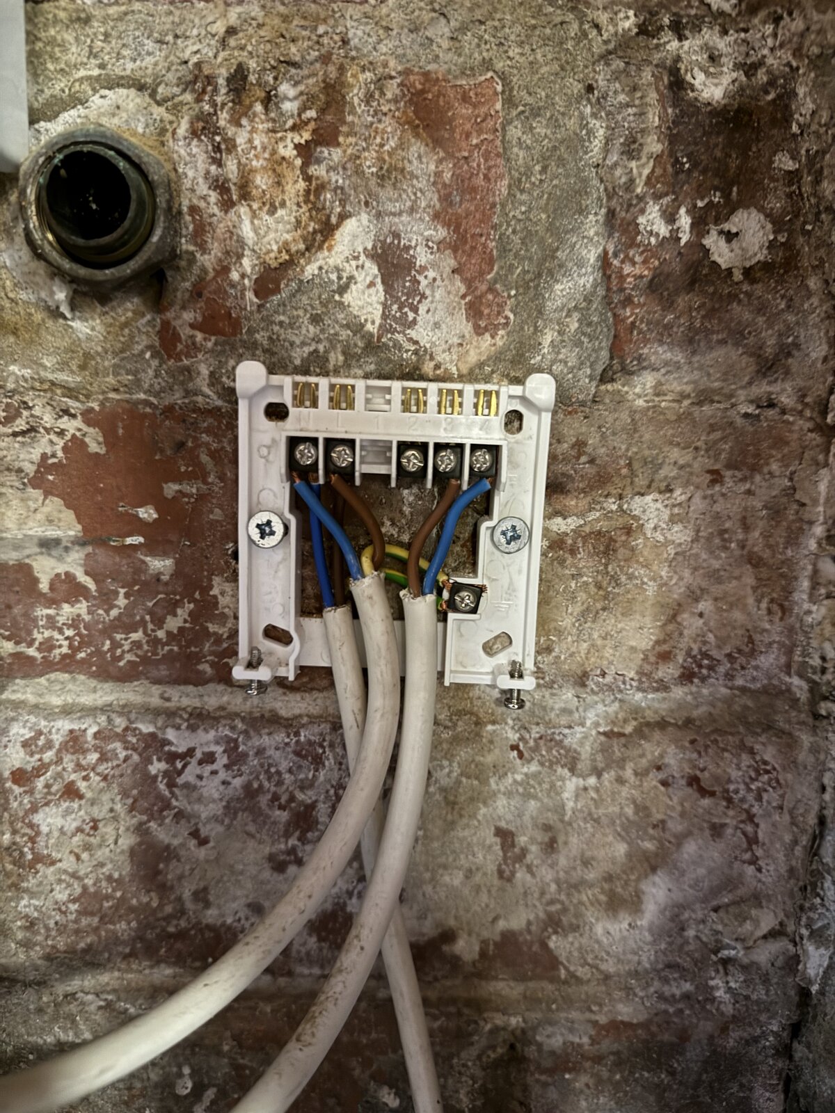

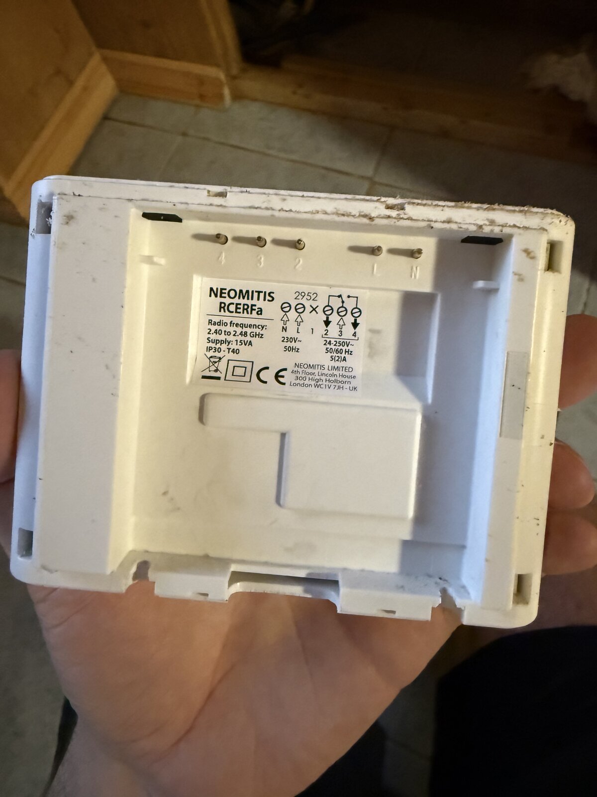

Hey, can anybody please help me out without the correct wiring, in order to get hive set up?
If it helps, my boiler is a combo Glowworm 35C
I ask because the wiring in my bc current neomitis doesn’t appear to match what hive want the wiring to be like.
Hi, yes sure move the following from Neomitis to Hive:
N to N
L to L
Common (3) to Com (1)
Heating on (4) to on (3)
Job done
