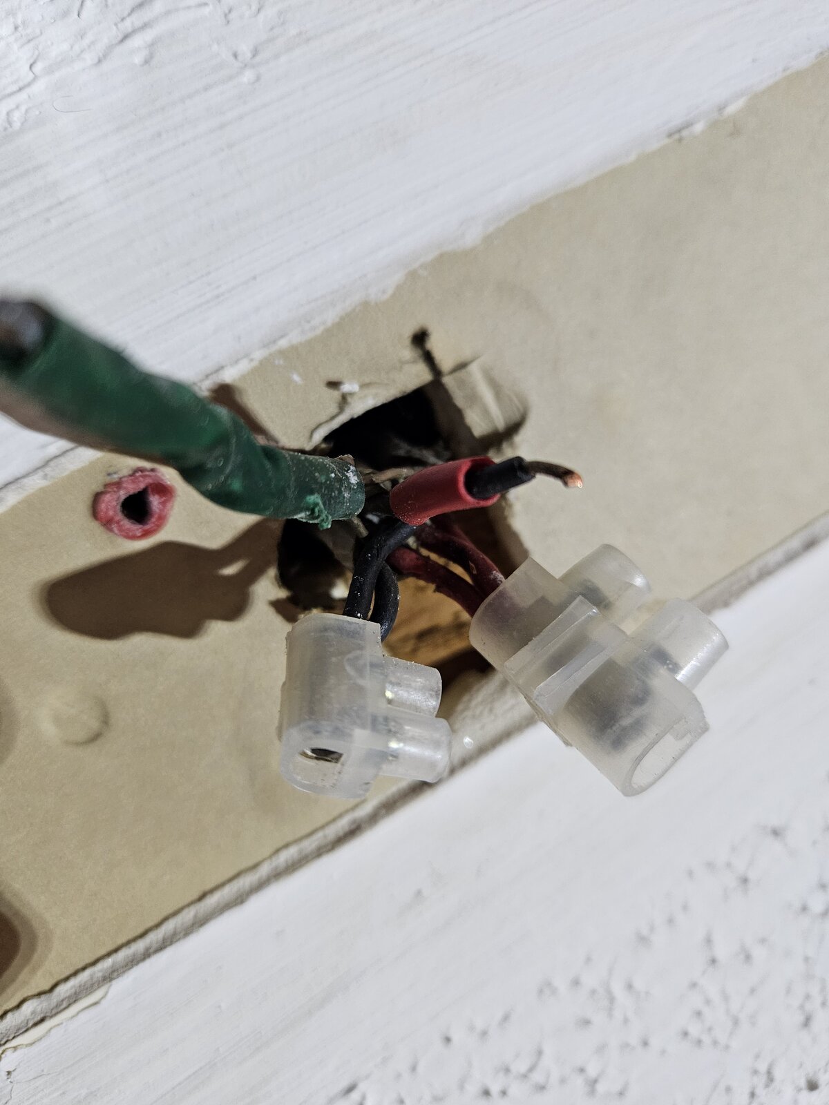

Hi,
Can anyone make sense of the wiring in the attached picture? I can't work out what the random wire there that's not going into a terminal block is? It is sleeved in black but then has red sleeving slid on over it? Any advice please? The wiring was for a fluorescent tube that I am replacing.

Black (or blue) wire, marked with red (or brown) sleeve, usually indicates a 'switch wire'. The switched live.
The two reds and the two blacks are usually the loop in and out of the circuit
All the bare coppers should be the earth wires. You'll notice there is an amount of bare copper showing. It is better to sleeve then individually in G&Y and then fix them to a terminal to earth the lamp body.
So the lamp itself is usually supplied N from the two blacks, and SL from the single black sleeved red.
It will be neater if you use a length of terminal strip that includes screw holes to fix it in place.
The "Twin Screw" connectors shown in the photo of Post #1 are "interesting" (to me) in that
they resemble the "Twin Screw" connectors used in Australia - for Earth connections (ONLY)

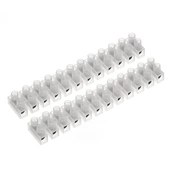

I am sorry that I mis-interpreted the picture of two (different sized) "cut-off" Terminal Blocks as being similar to Australian BP Connectors.
(The smaller one was (obviously) cut-off from the END of a BLOCK. (Hence no "ridges" on the top side.
The cut-off ridges on the larger one are now obvious to me.)
