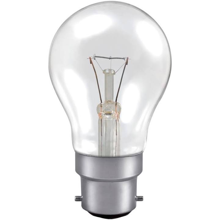

Do you still have an incandescent light bulb in the room? This could allow the fan to connect to Neutral through the bulb on the SL when the light is OFF, then when the light is ON 230V goes to all terminals at the fan therefore it stops.

Not sure what am incandescent light is? but it is connected to a florescent tube if that is what it means?
Youngsters today! :( ;)
