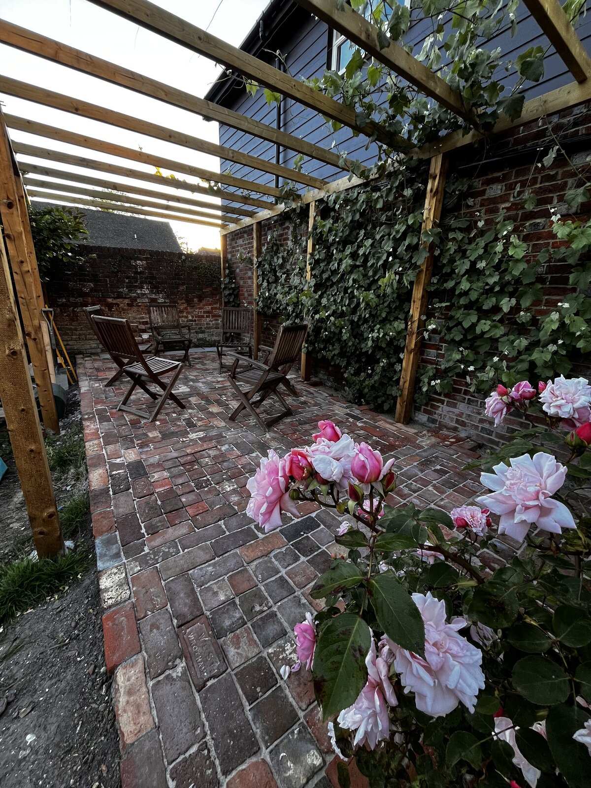

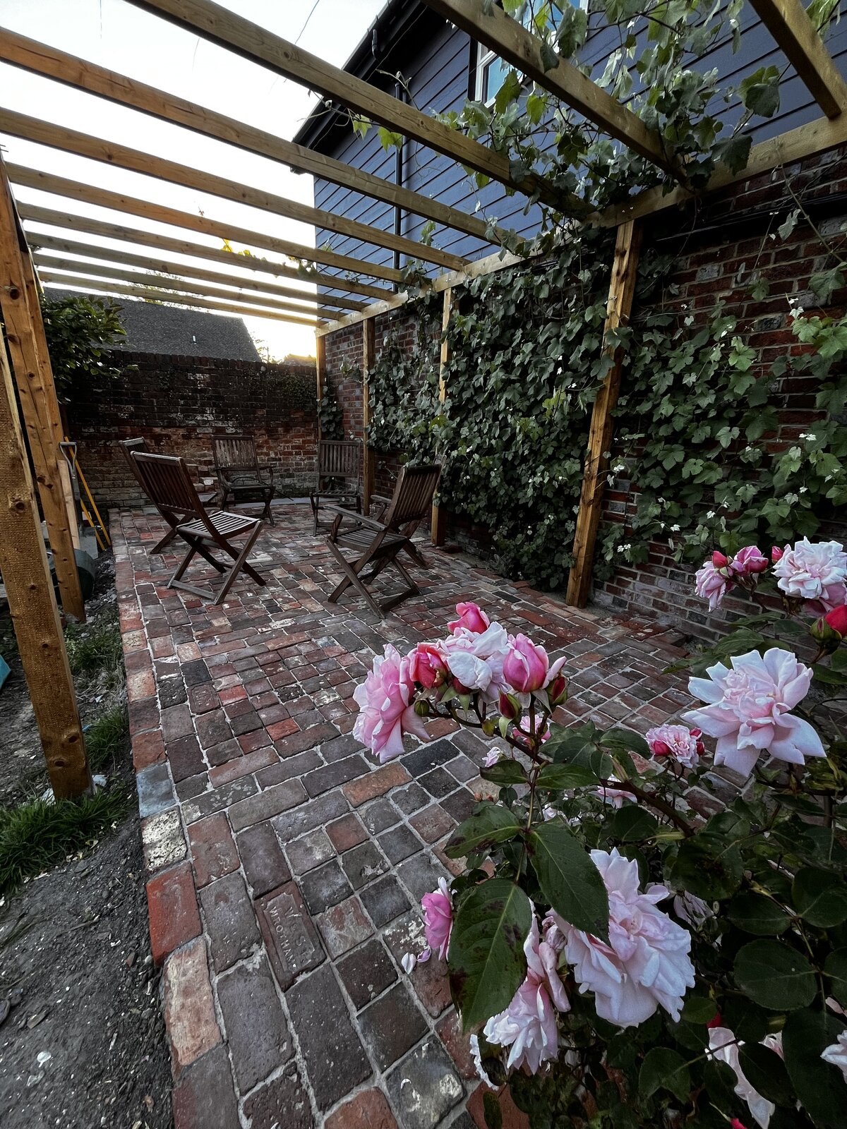

Pretty much finished the patio a couple of months later. Took a long time because I jet washed every single brick, cleaned off all the old mortar, and had to cut a lot of them down to make the half bricks for some of the pattern. But I'm really pleased with the result. It's a really nice rustic look and the the grape vine has really taken to my new pergola as well!!!
Just the BBQ to build at the end and a bit of landscaping and turf to be laid off to the side now.

Thanks for the update, you want to be happy with it, looks bloody good.
Nice to see something 'made' rather than just banging down some Indian Stone!
Suits your house.
Well done!! Looks great. Good on you for recycling those bricks...
I like the detail of that "West Wrotham" brick, I assume that was intentional.
It's actually "W&S Wrotham" - a local brick company (I live in Wrotham, Kent - these were found around the house and garden as were most of the bricks used. I can't find any record of "W&S" so not sure when the bricks were made but I would guess late 19th or early 20th century. I found about 7 of them and strategically placed them around the floor design.

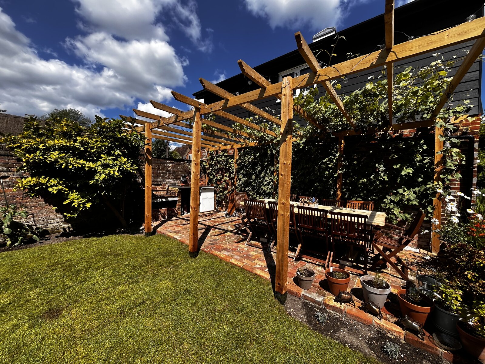

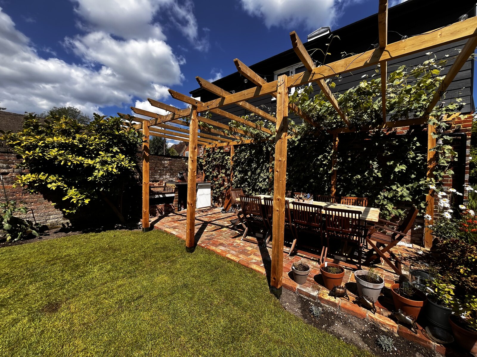

Final update - patio laid, pergola built, BBQ area done (and used!) table made and turf down. All in all I'm pretty chuffed with myself as a complete amateur!
