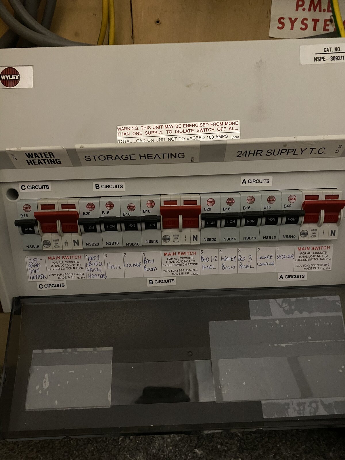

Hi, looking for some advice.
I gotten rid of my storage heaters and went to change the old switches to 3 pin sockets.
I plugged in my new heater and of course it didn’t work. As I have now realised the power is on a timer and not 24/7 as it was for the storage heater.
I have 2 fuse boards in my cupboard. The one with the sockets in question has 3 circuits, the immersion heater, the storage heaters and a 24/7 circuit.
I want the storage circuit to now be on 24/7. How do I go about this? Do I need a sparky in to do the work and if I do what’s a ballpark figure for that kind of work.
I don’t seem to have any spaces in either fuse board as it stands.
Also, I don’t have an economy 7 rate as such. I have a normal rate for one meter and a heating rate in the other.
Any help much appreciated

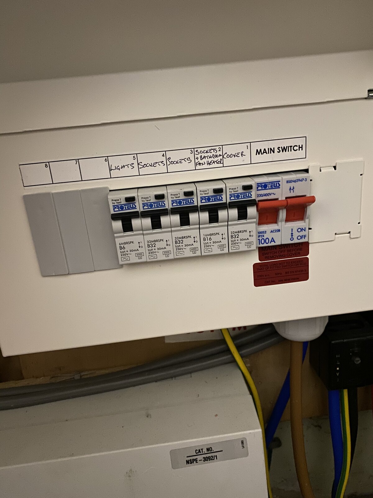

From your description it sounds like a replacement would be one solution. Do you have RCD in the 24h box, if not the replacement is almost a prerequisite, as is a qualified electrician to issue the required paperwork.
Picures help us a lot.
So the first one is my ‘regular’ fuse box and the second is the one with the storage part. Circuit B. I see there are 3 spaces in the other fuse box.
Any idea for the best way around this?

Sparky it is then I guess.
