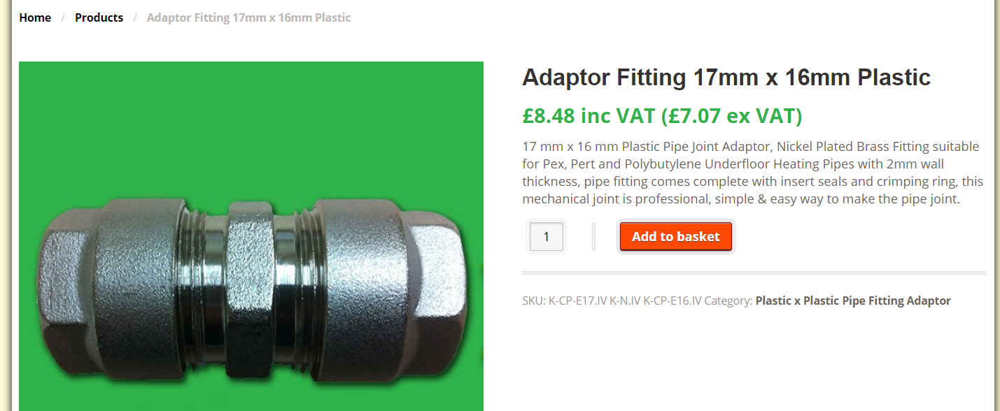

One company I spoke to said I would struggle to replace the manifolds because the underfloor pipes are 17mm and they weren't aware of any manifolds that would fit them, but I will look around and see what I can find.

Not that I’m an expert, but 17mm pipe is not the norm, you might be able to get a reducer to take you to 15mm, then you could change the manifold.

Adaptors are available so changing the manifolds would not be a problem (but not cheap)

Have sorted a few we are polypipe registered underfloor contractors so we fit new polypipe manifolds, as has been noted adaptors are available but pricey.
