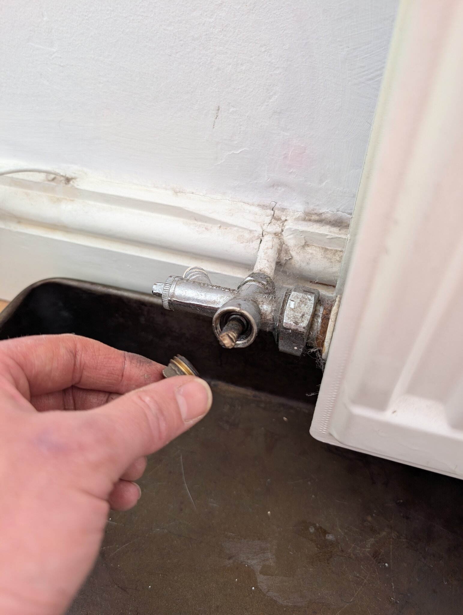

Hi all,
I am trying to remove a radiator and I can't seem to close the lockshield valve as it is seized. I have already snapped off the flat bit at the top, but fortunately I still have enough of the spindle I can grab hold of with pliers, but it sill won't budge.
I've tried some Plus Gas dismantling spray and I have also loosened the gland nut but this didn't help. In fact I could totally remove the the gland nut without any leaking. Is that normal?!
Any advice appreciated, I would definitely prefer not to drain down the system if possible (it's a ground floor radiator unfortunately).
Thank you

You need to fit a new lock shield ,which is possible to do without fully draining the system. Close the other valve and drain the rad,after a while the water should cease to flow from the valve,and you can quickly swap the valve for a new one.

Thank you. I've been reading about this method and didn't realise it was possible without fully draining the system.
Just a couple of questions....
1.) Would it best to remove the pressure from the system in a controlled manner first? E.g. by bleeding some water from another radiator somewhere in the system first until it is no longer under pressure?
2.) Do I need to shut any valves etc on the cylinder first before attempting this?
Don't touch any other radiator. Use the air bleed valve on the radiator in question to reduce pressure a little before draining that rad.

Thank you. I've watched a couple on videos now following your advice and it's giving me a bit more confidence to try this.
It's just scary opening up a 'live' system, but I guess that it's essentially basic physics and as long as air doesn't enter the system anywhere, it creates a vacuum and can't push the water out (I presume anyway!).
Correct ,it's the vacuum that holds the water from continually flowing.
