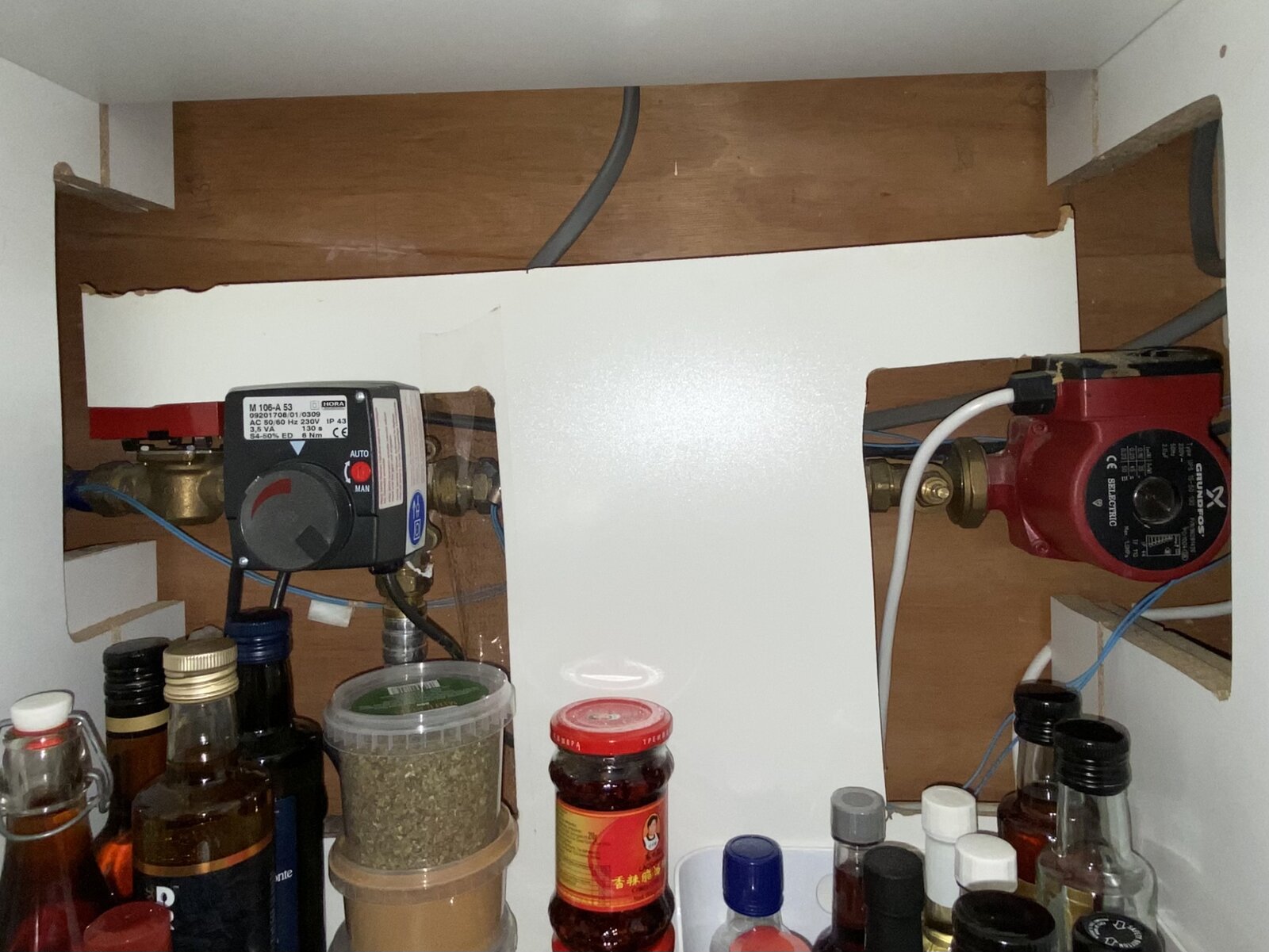

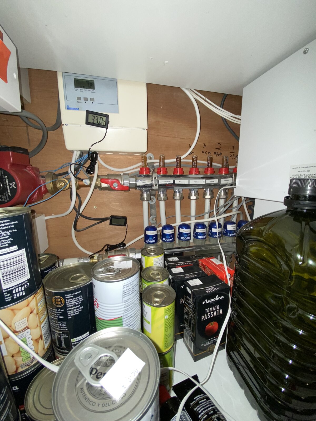

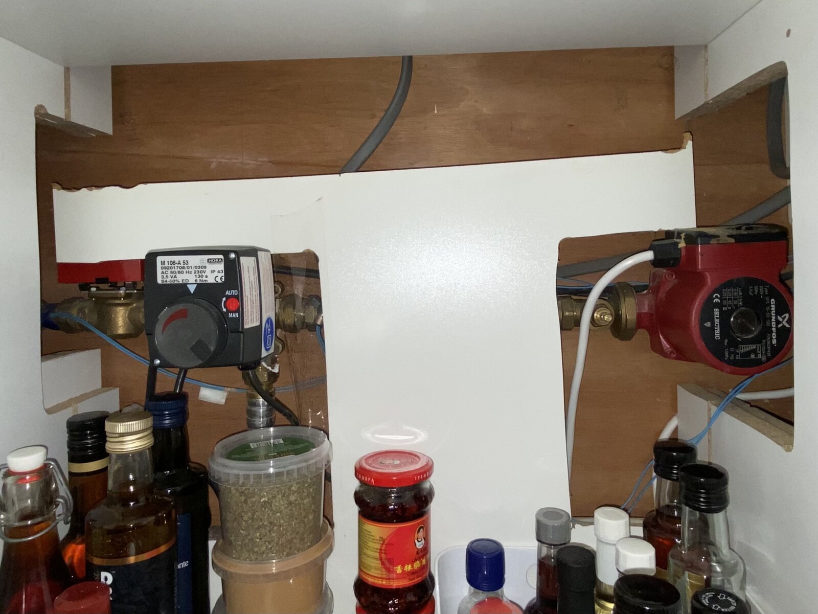

So…photo overload - the 1st shows the mixer valve (?) next to the manifold in the upper part of the house. This seems to opened and closed fairly frequently (the noise is quite noticeable).

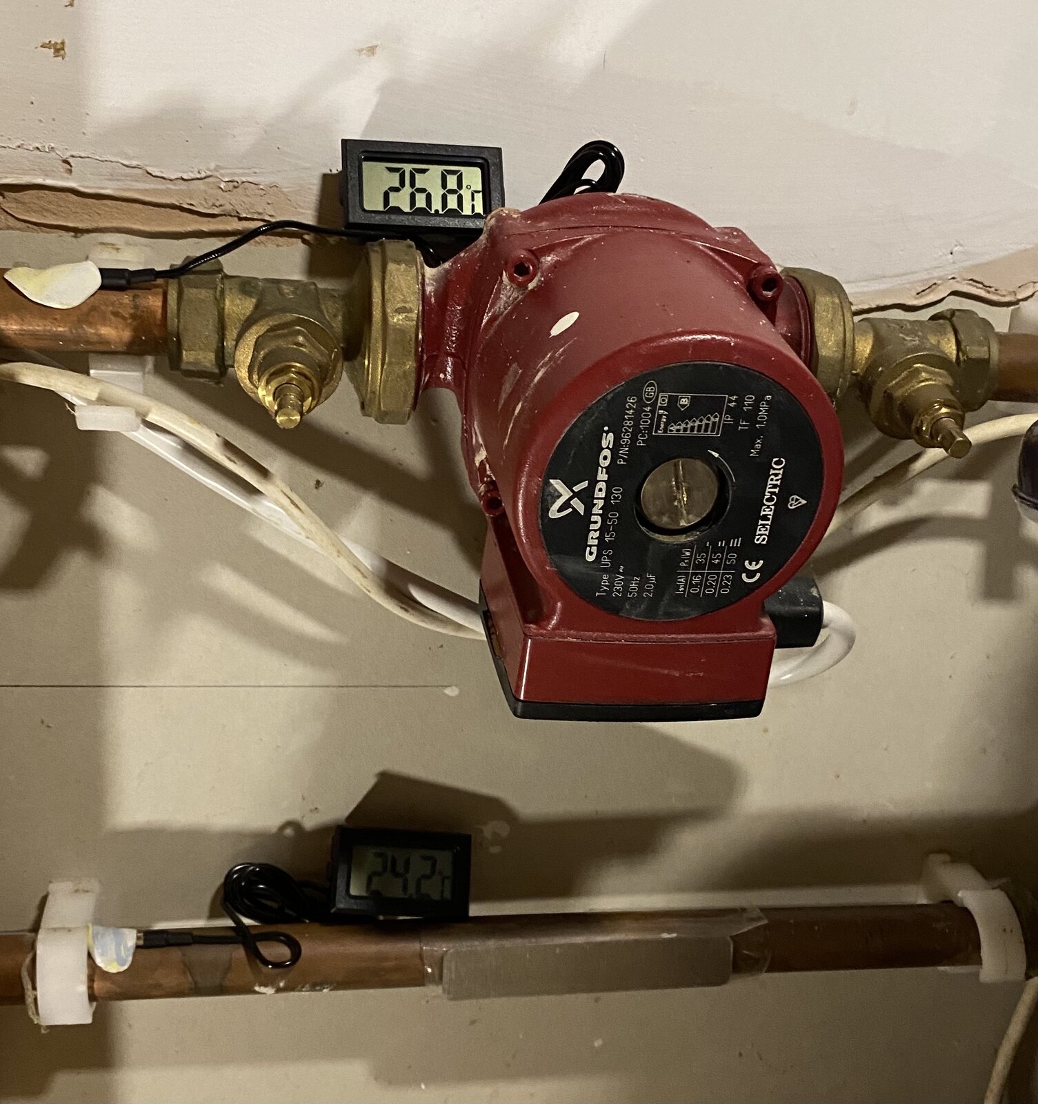

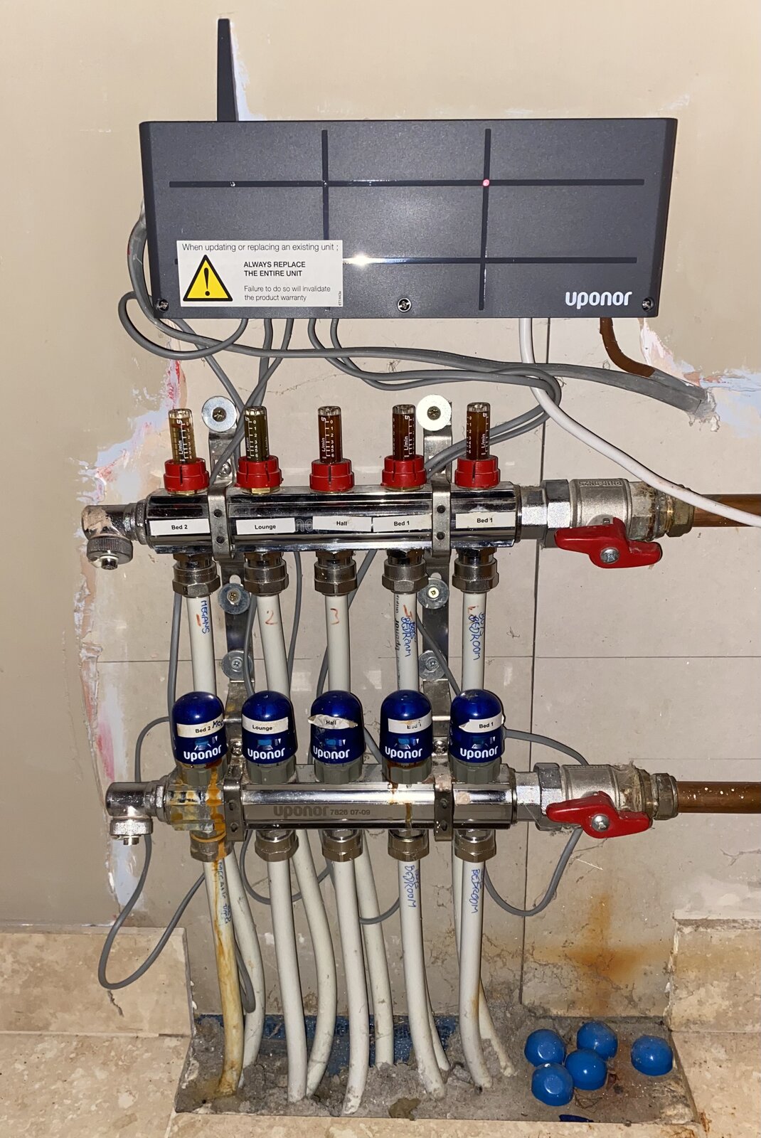

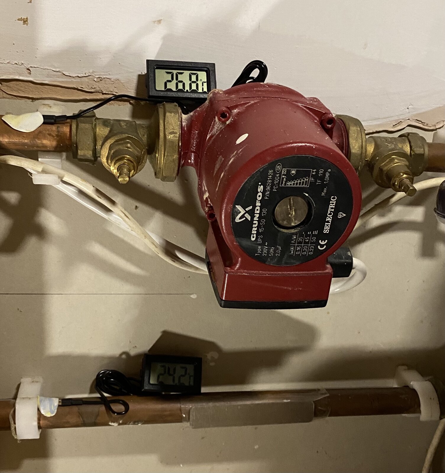

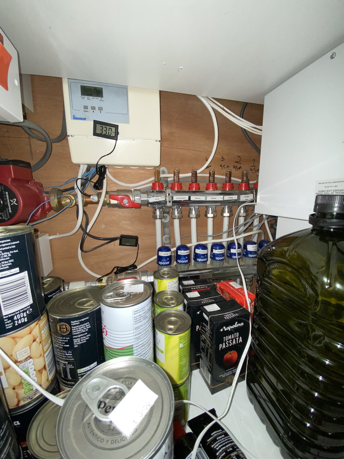

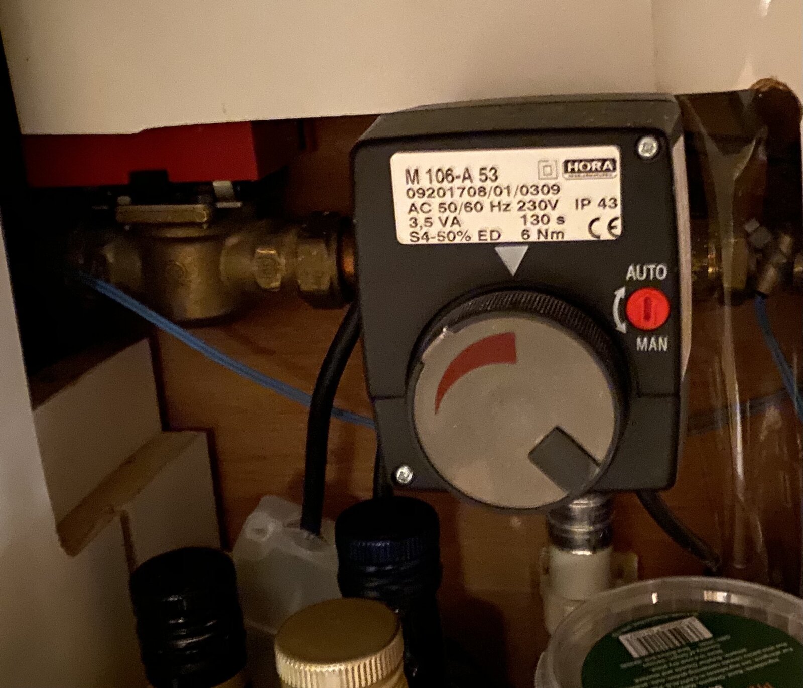

Pic 5 shows the pump next to the 2nd manifold at the other end of the house as shown in the last pic.
You can see the little Amazon thermometers I’ve been using to get a rough idea of the pipe temperatures.
Sometimes the inlet temp on the 1st manifold jumps to just over 30 degrees (due to the mix valve functioning?)
but mostly the in out temp diff is still about 2-3 degree. With slightly warmer weather today the temp in the cold far bedroom has crept up to 17 but in the upstairs bedroom there is still no heat coming through to the rads.

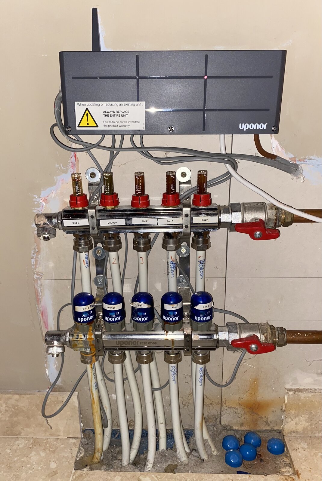

on the last picture it shows that bedroom 2 actuator is off (closed ) and bedroom 1 righthand actuator is off (closed). what speed is the pump set to in picture 4? needs to be on max speed (3).
Need a clearer picture of the first manifold to see which actuators are open.
On the second manifold unless bedroom 1 had just reached temp or has only just turned on then it looks like either a faulty actuator or wire has come loose

Can you measure the pipe with the hottest temperature (the HP flow temperature) on that what looks like a electronic mixing valve, is this feeding all the manifolds or just one?.
It shouldn't be moving around frequently, it should give a steady required mixing temperature, whatever that is?, 30C.
On the problem 5 loop manifold you are only getting a dT of say 2.5C, at a assumed flowrate of 2LPM then each loop is only producing 350watts say a total of 1.75kw yet the 7 loop manifold is running at a dT of 12C giving ~ 2100watts/loop.
You should be able to switch off the power to that mixing valve and just set it to give say a fairly constant 35C mixing temp and see what effect this has.

Don’t worry about the mixing valve.
It shouldn't be operating like this though?
"the 1st shows the mixer valve (?) next to the manifold in the upper part of the house. This seems to opened and closed fairly frequently (the noise is quite noticeable)."
these mixer valves will continually alter the mixing to create a fixed output temp. But unless the OP is certain that it is this making the noise and its's not the 2 port motor we can't be certain. It could be a broken mixer valve but i doubt it.
