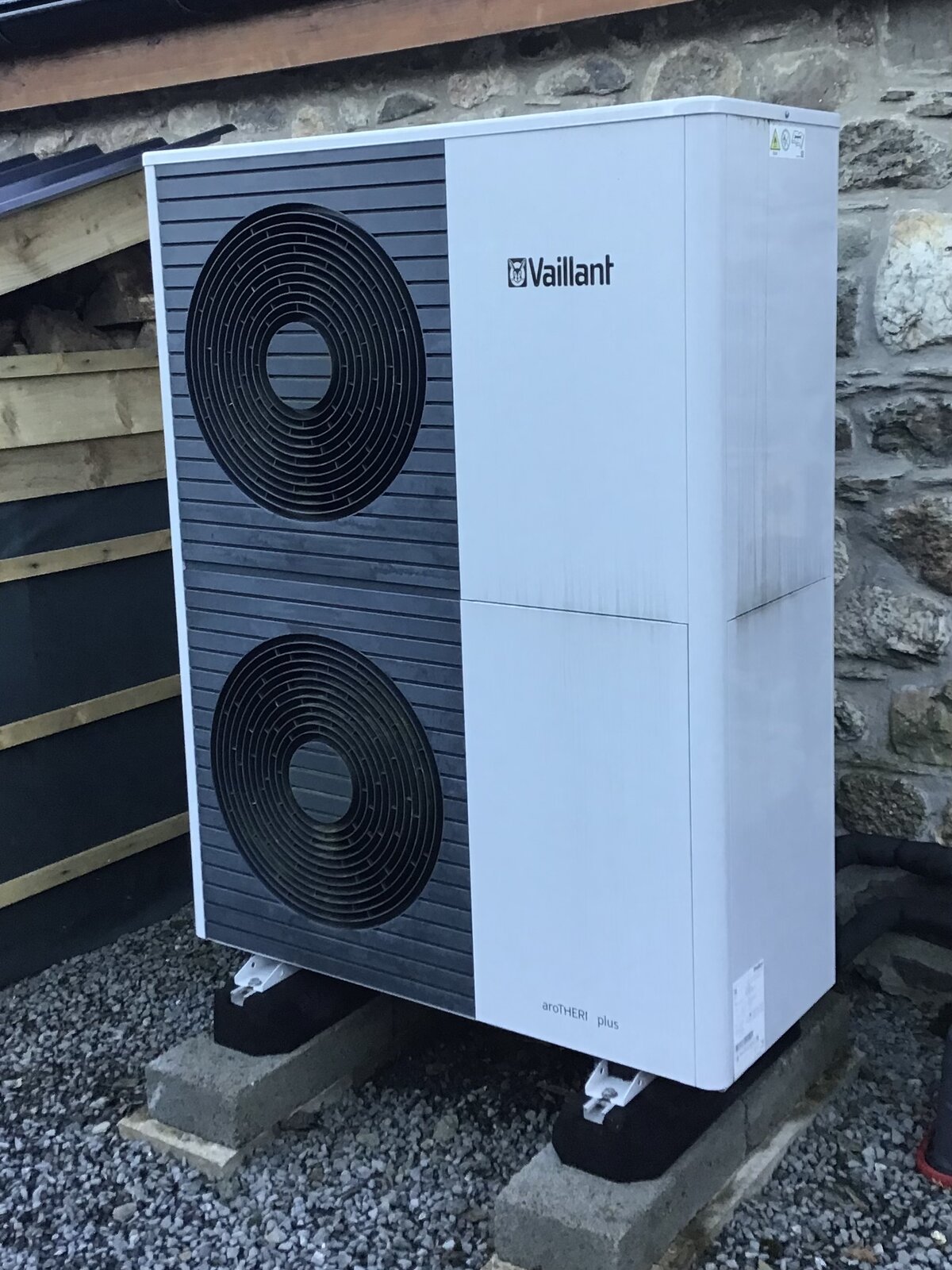

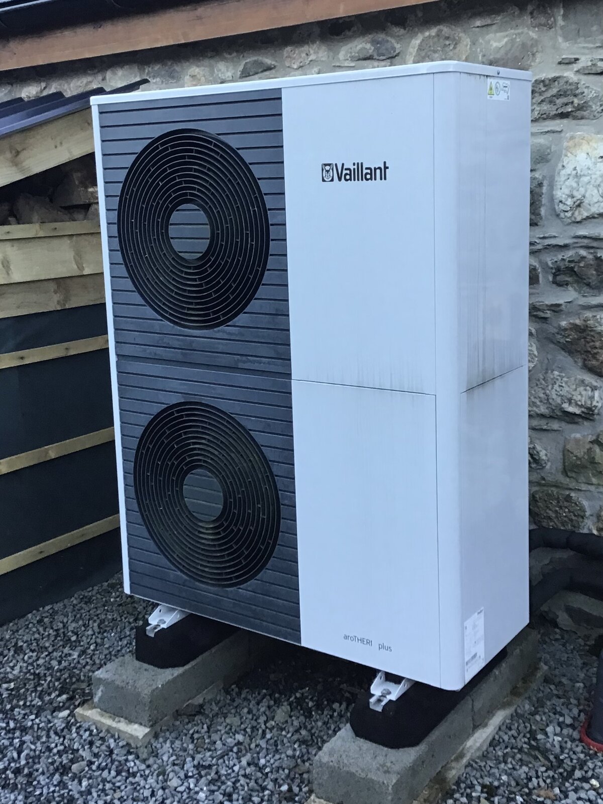

Thanks Johntheo5 too -so the mixing valve seems to affect the both manifolds. Trouble is the other manifold is at the other end of the house So that pipe run is probably about 30 m. Hence by the time the water gets there it’s down to about 27 degrees. The pipe temperature coming out of the ASHP tank seems to be about 45 degree.

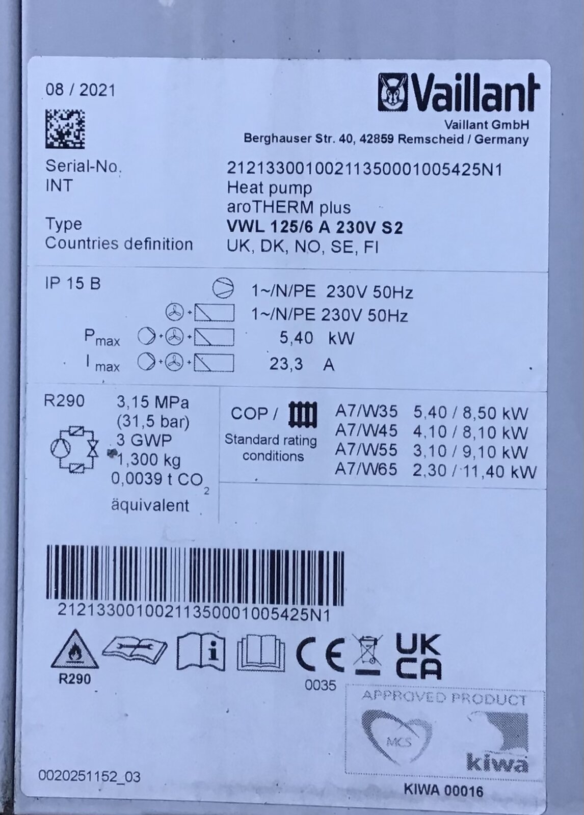

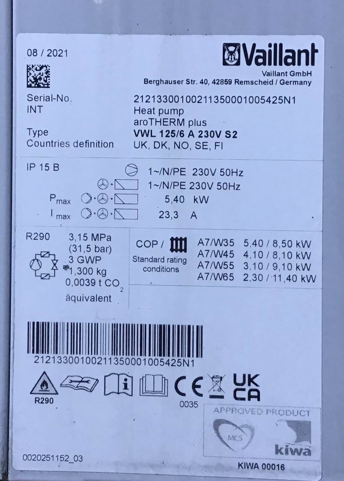

this is our ASHP…hope that’s helpful.

heat pump is 12kw model. Just need the size of the property etc to see what kind of heat loss.
