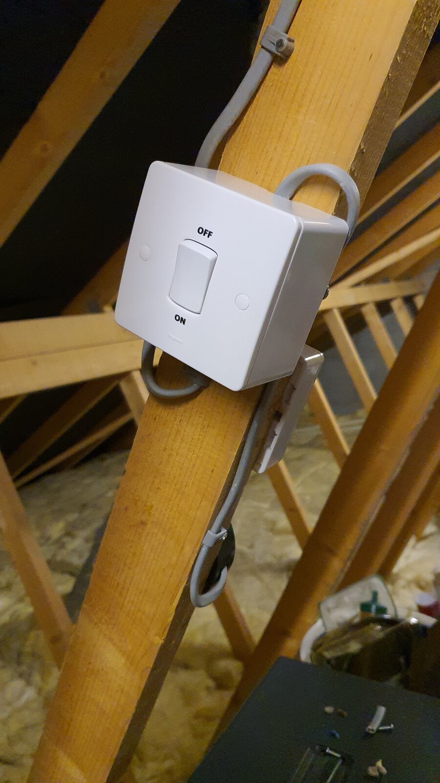

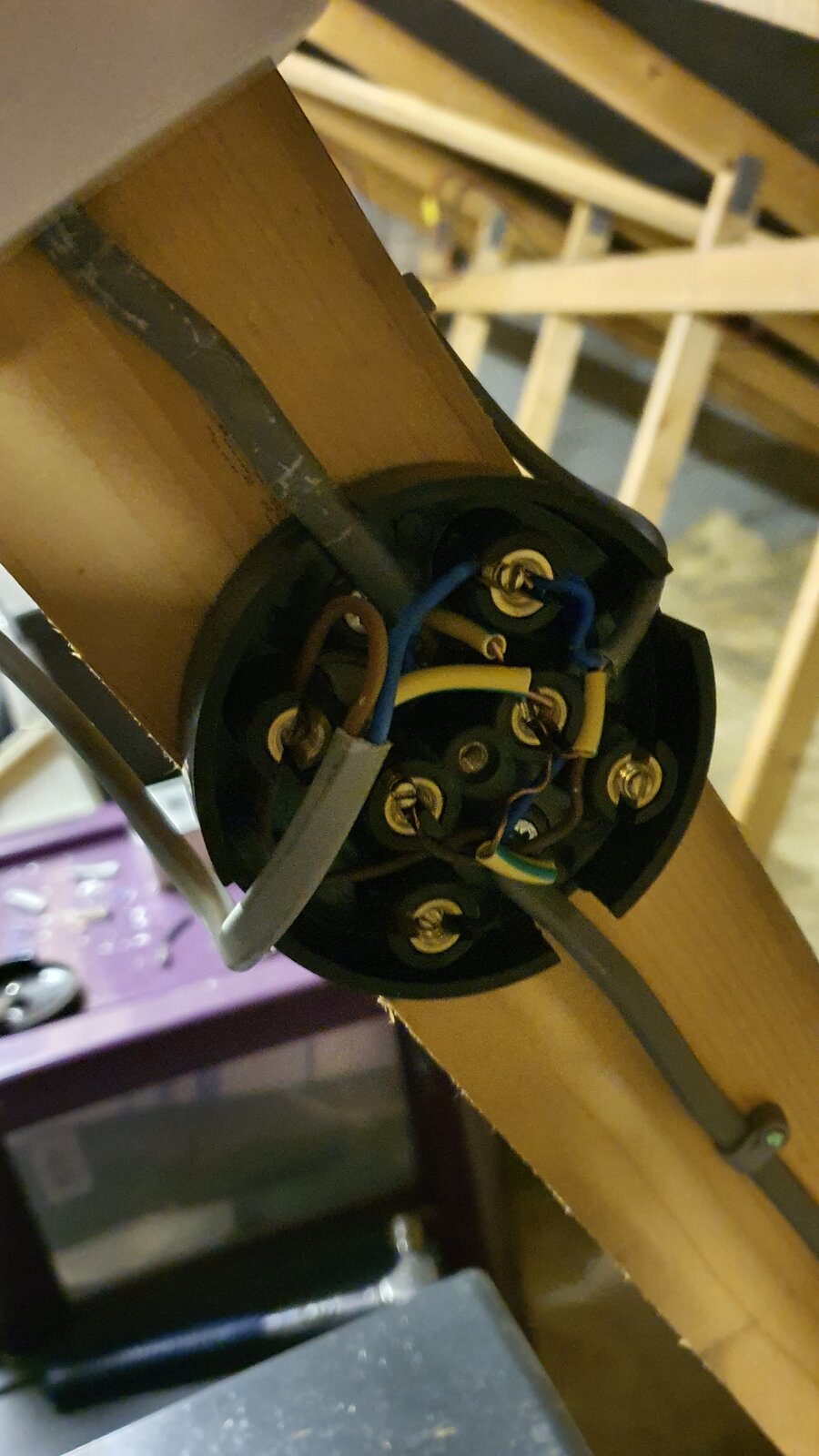

Are there any issues with my plan? I assume I just use the two empty connectors in the box and link it to incoming Live feed as the loft lights have been?
Aside from using a double pole switch, is might be worth your while putting the switch in a more accessible place, if the PIR is of the type where a quick on and off makes the light stay on. It could be handy if you might sometimes need the light to stay on.

The security light im getting as per this post is simply for the side of the house so a standard 5 min timer will probably do the trick, i cant see a time when Ill need to turn it on and leave it on. Its simply a side path from front to rear. Although I will at least leave the switch somewhere mounted in the loft that I can use, (just not to next to the loft light switch to avoid someone turning it off by mistake).

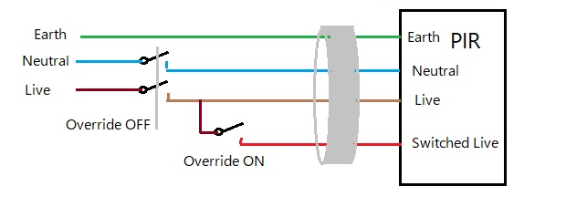

Second vote for an accessible dp switch to allow the light to be forced "on" in daylight/all night.
A quick flick of the switch off/on can be useful and even if hardly used takes little effort.
It saves entering the loft if the lamp blows ( not sure if you are planning LED of halogen?)
Those PIRs with the quick OFF - ON override function can get turned ON by transient power cuts.
Installing three core + Earth cable would future proof the installation for adding override switches at a later date ( when the PIR gives up )

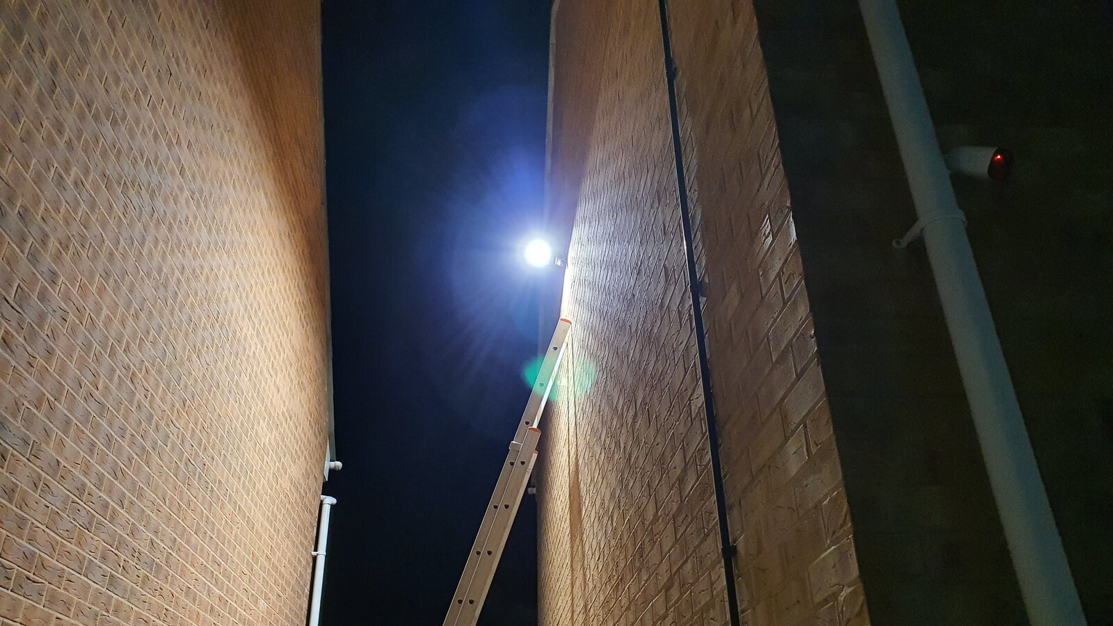

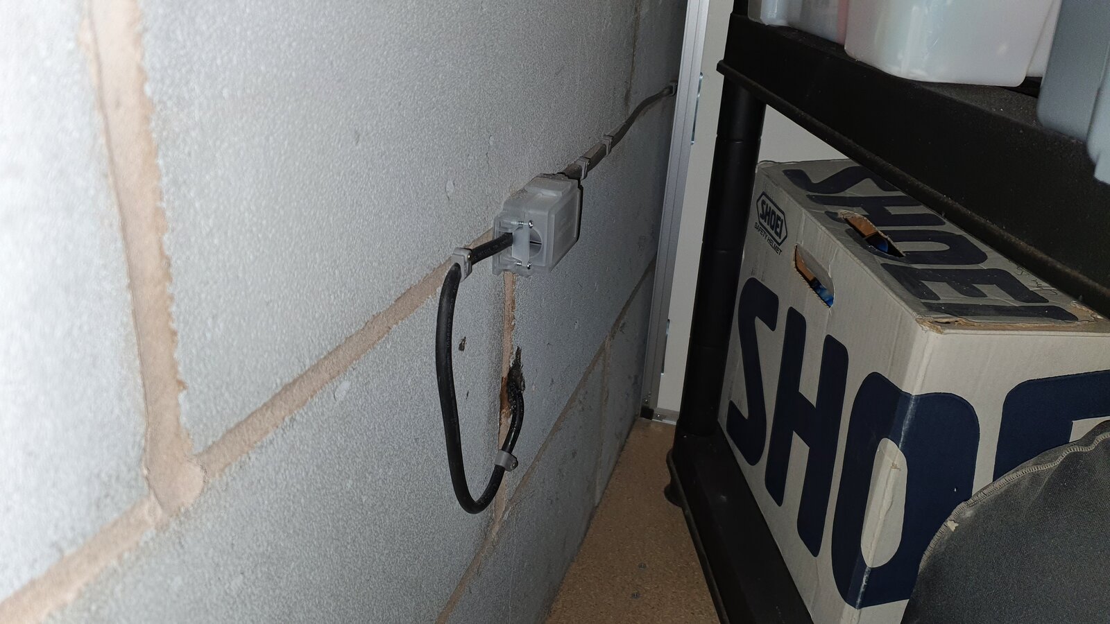

All done and working well. Thanks for the assistance all.
Freezing up there today!
