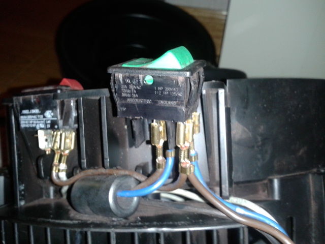

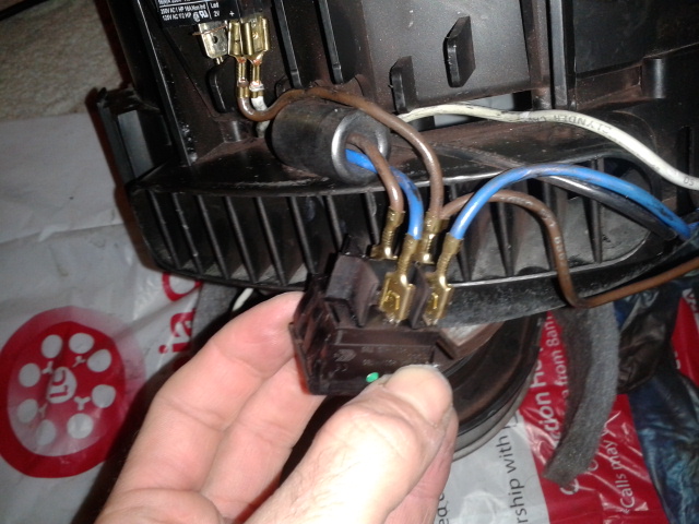

Henry Hoover (hetty model) fault diagnosis? Any help please?
On the switch you have 4 tags. 2 blue 2 brown. The two blues should have a reading or continuity when switched either way. As the same with the Browns.
the only thing left is the pcb.
You need to put the 2 white wires from the motor direct to the on off switch. One either side one on brown one one blue. And disregard the pcb and the wires on that. look at the post re Henry below. That's wat needs to come out.
No you can't check without a tester. I've done hundreds of these and on my a couple have been on off switch. If you changed the plug and cut off 3 inches at the head end and rewired it back into the head the only thing left is the pcb. You need to put the 2 white wires from the motor direct to the on off switch. One either side one on brown one one blue. And disregard the pcb and the wires on that. look at the post re Henry below. That's wat needs to come out.
Can the Hoover operate without the PCB completely? There is no extra terminals for the white wire spades, I presume I will have to cut, crimp and join them with the blue and brown either side you mentioned?
Yes it will work without the the pcb. But the low speed won't. No need to cut or crimp the wires just pull off the old one and replace with the white ones. The rest of the wires attached to pcb are no good. Wait till you get a tester tomoz it might be the switch
So ill leave alone the main live + neutral. (brown and blue that are in individual terminals on the left if the pic, and feed from the head of the appliance)
One of the terminals on the on/off switch is doubled up. Which is a brown wire from the pcb into the on off, then looped into the high low switch. Will i remove that wire completely and attach the white wire from the motor to the on off switch terminal?

Where do I send the christmas card mate??
Removing the PCB and switch did the trick..
Thank you for taking the time to explain
Good stuff. Saves you buying a meter and another Hoover ,hetty lives on for a few more years. Them pcbs have been a problem for years. It blows a little triac on the board and you can't replace them.
