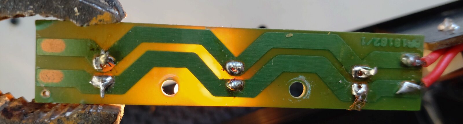

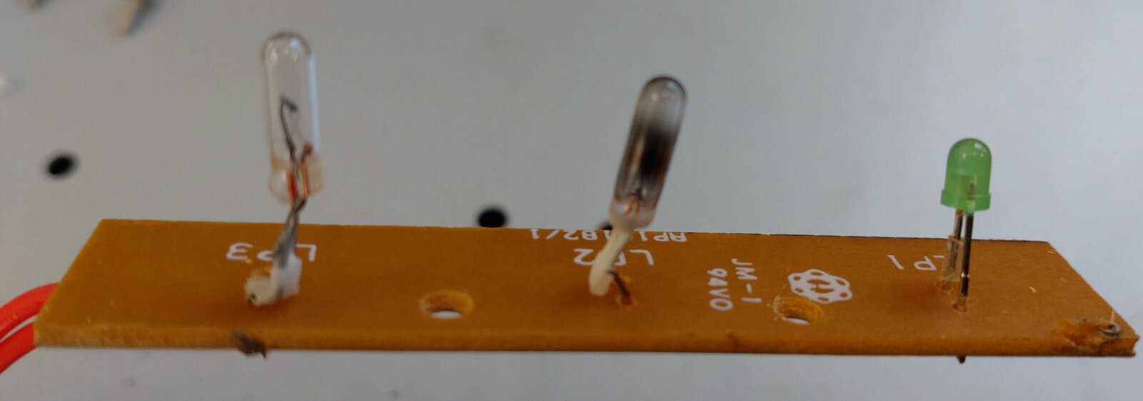

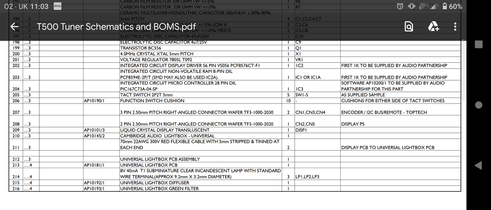

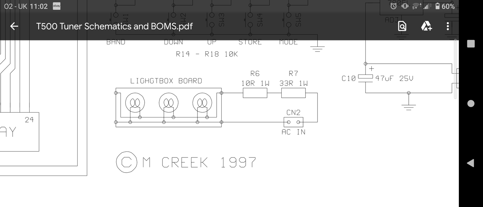

Hi, I can't read the front panel of my radio. According to the schematic, the display is lit with 3x 8V bulbs. I've measured 8.3vAC across the tracks. The soldering doesn't look great and it looks like maybe one of the bulbs has been replaced with a green LED. Supposedly this was new when I bought it's albeit 20 years ago!
I thought a green LED was about 2v, how can it survive 8V AC? How would you fix?
I've found these online in USA, can't find anything similar in UK. Do you think they are basically an LED soldered in line with a resistor and covered in heat shrink?

Yes I understand V=IR but that doesn't explain what is going on. Good point on the diode but I can't see one in the circuit (schematic provided).
1. How does the LED survive 8V AC?
2. What should I replace all three with? Should I leave the LED and put in new bulbs, replace all three with new incandescents, or something else?
Right fixed. I used white obscured 20mA LEDs, cut the positive lead short and soldered on a 300R resistor.
The LEDs were flickery to look at but I installed them opposite polarity to reduce flickering and it seemed to have worked, the display looks fine.
I was concerned about breakdown voltage since I didn't use a diode as above, but it doesn't seem to be a problem. So despite the spec sheet saying breakdown voltage 5V they seem to cope with 8V AC so a peak of 11.3V.
