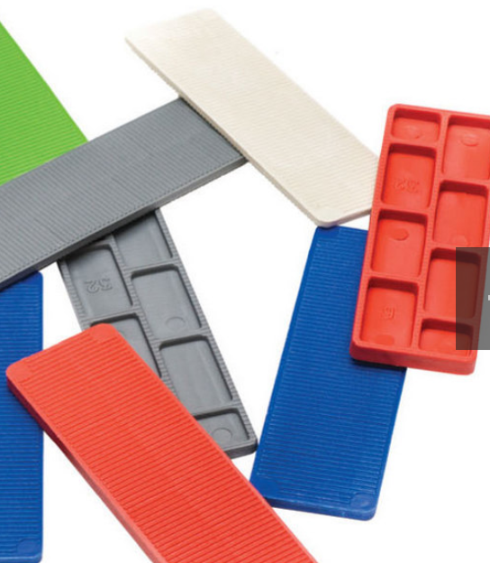

The glass is an integral part of the structural rigidity of the door and needs careful packing to ensure it functions as the compression diagonal that keeps the frame in-square. If it's dropped I'd guess something has happened to the packers or the glass in the corners (bottom nearest hinge, top opposite hinge)
Quite often tall packers will crush over time as the height comes from them having little plastic "walls" rather than being a solid lump of plastic
See the red packers in the image below:
And these above are decent quality ones with thick "walls"
The cheapo ones from Screwfix crush more easily as their walls are much thinner:

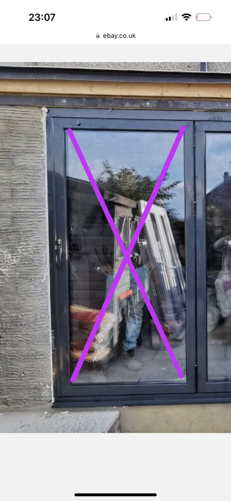

Measure the diagonals.
Upload pictures of the hinges and main door, particularly the seal at the top of the door
