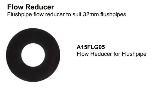

With the force of water coming down from 2.4m high, you might get over spill from the toilet pan, only fit what the manufacturers recormmend.
