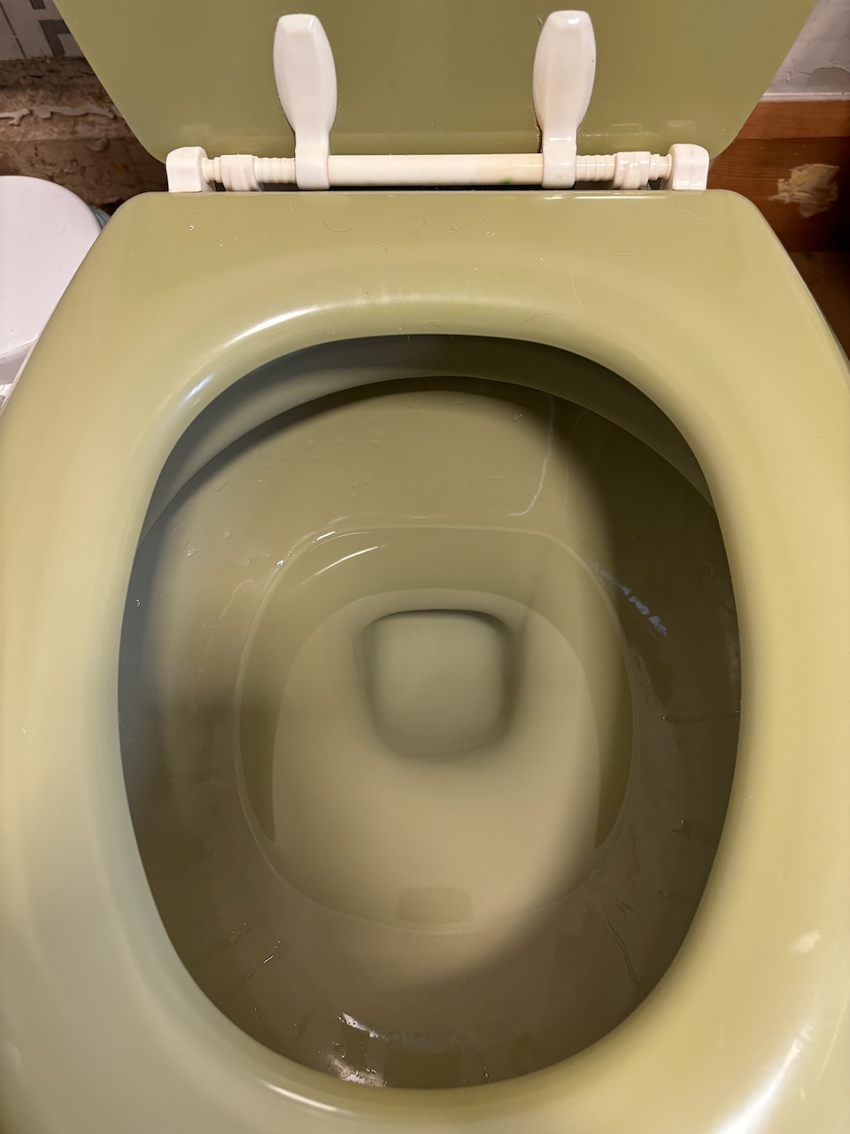

Hi,
My wife is into everything retro - consequently I'm currently removing a perfectly good, modern white bathroom suite and replacing it with a 70's avocado suite.
All's going well so far, we managed to get the cast iron bath up the stairs eventually. I'm currently doing the toilet.
So, the old toilet worked perfectly well, therefore there's nothing wrong with the waste pipe at the wall.
I've fitted the new 70's toilet and have replaced every part except for the siphon as it seems to be ok. No leaks so all good there.
The only problem I've got is that the water is sitting too high.
When you flush, tissue sits on top of the water and the flow from the jets seems to go under the tissue which holds it up out of the way of the pull from the bend.
I've tried restricting the water level with the fill valve and by restricting the flush with the syphon - in both cases the water still sits high but more flushes are needed to get rid of 'stuff'.
If you push the tissue down with a brush, you can hear water flowing out the back into the waste pipe.
What do I need to do to fix this?

Photo and video attached.
Video of flush...

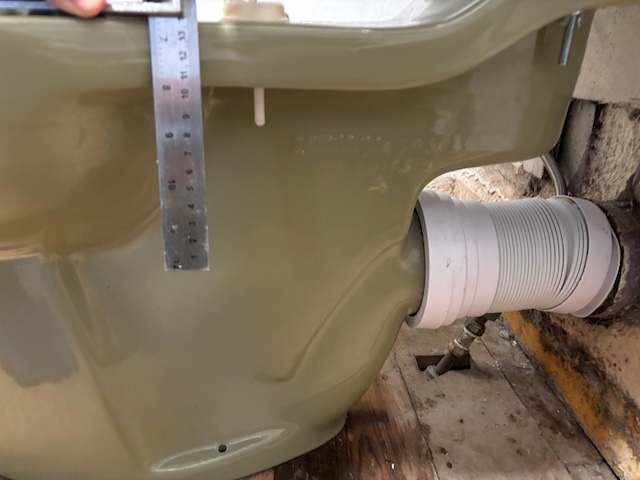

This is the back of it with the level of the water indicated by square...
As you can see the water level is sitting level with the top of the spigot and the connector slopes downwards very slightly - is there anything that can be done with that?

If the water level really is at the top of the spigot, that suggests there is no fall on the pipe exiting the spigot.
It should settle at the level of the bottom of the spigot, or rather the internal bottom level of the spigot.
No not really - as suggested there's only 1 thing that could cause the water level to be higher in the bowl and that would be that the water was caught in the outflow pipe - in essence - raising the level of the water seal.
The design of the pan's trap means there is no other way the water line could be 'held' higher, if you see what I mean.
and would certainly explain the higher water level in the bowl - good shout.
usually though with a double trap SS the water level would drop when flushed and then fill itself back up at the end - @Dazzathedrummer does the toilet do that when flushed?
Video here of the flush - https://share.icloud.com/photos/0a5lInK8aha70fr-n5HG3VPjg
It did have an aspirator but I removed it as it wasn't doing anything (same result when it was fitted)
If there is a faulty (the rubber bung) or no aspirator then usually there is no syphonic action triggered and the pan would fill right up and just drains slowly. That being said if yours had one then it certainly needs it and will undoubtedly be the problem.
The aspirator allows some of the flush down into the lower trap creating suction in the upper trap, if it's not there it won't ever work correctly
