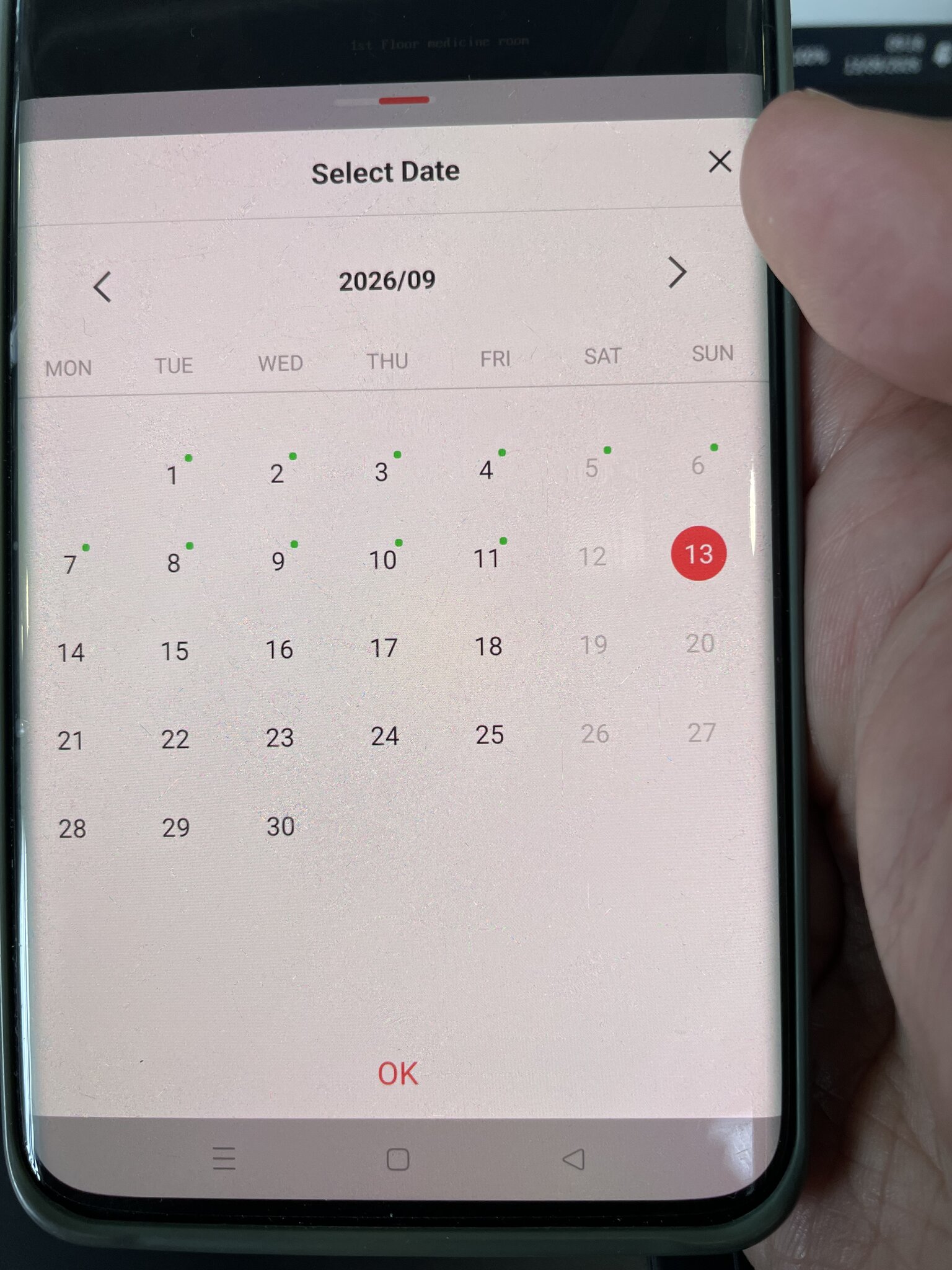

I have a Hikvision CCTV IP addressable NVR system (model DS-7616NXI-K2/16P) with 10 cameras (capable of 16) and possibly a 8gb or 10gb drive. Had it professionally installed by the installer is difficult to get hold of.
Since about July, when I try to view historical recordings on my phone, the green dot that appears against historical dates does not appear until some few minutes after I am playing with the app or trying to view footage. its as if there is no historical recording except for today. Also when I can view recordings for yesterday or few days earlier, it only shows it starting from midnight and I cant scroll forward through the day. After a few minutes the dots will appear against the historical dates (I can usually access about 3 weeks of footage given my capacity drive) and can scroll through the time lapse of the days. It's as if there is a lap before the historical footage appears. My questions are:
1. Would formatting the drive help clear any issues? The firmware software on the NVR is the latest from what I can tell when I try to do an online update.
2. After watching footage on my phone for about 4-5 minutes, it times out and I have to refresh and do it again. It stop in landscape mode and goes to the main screen again. Very annoying and feels under developed.
Anyone got a solution to these issues and are these general issues with Hikvision?
Alas the online update check from NVR isn’t what I would call reliable way of checking it’s up to date.

I'm saying that the green dots on the calendar do not appear for quite a few minutes after, so initially it feels like there is no recorded footage for the days shown.
I would have to guess phone connection to cloud as just done some tests and mine is instantly there. Try testing with a WiFi connection and try testing with mobile data only and compare.
