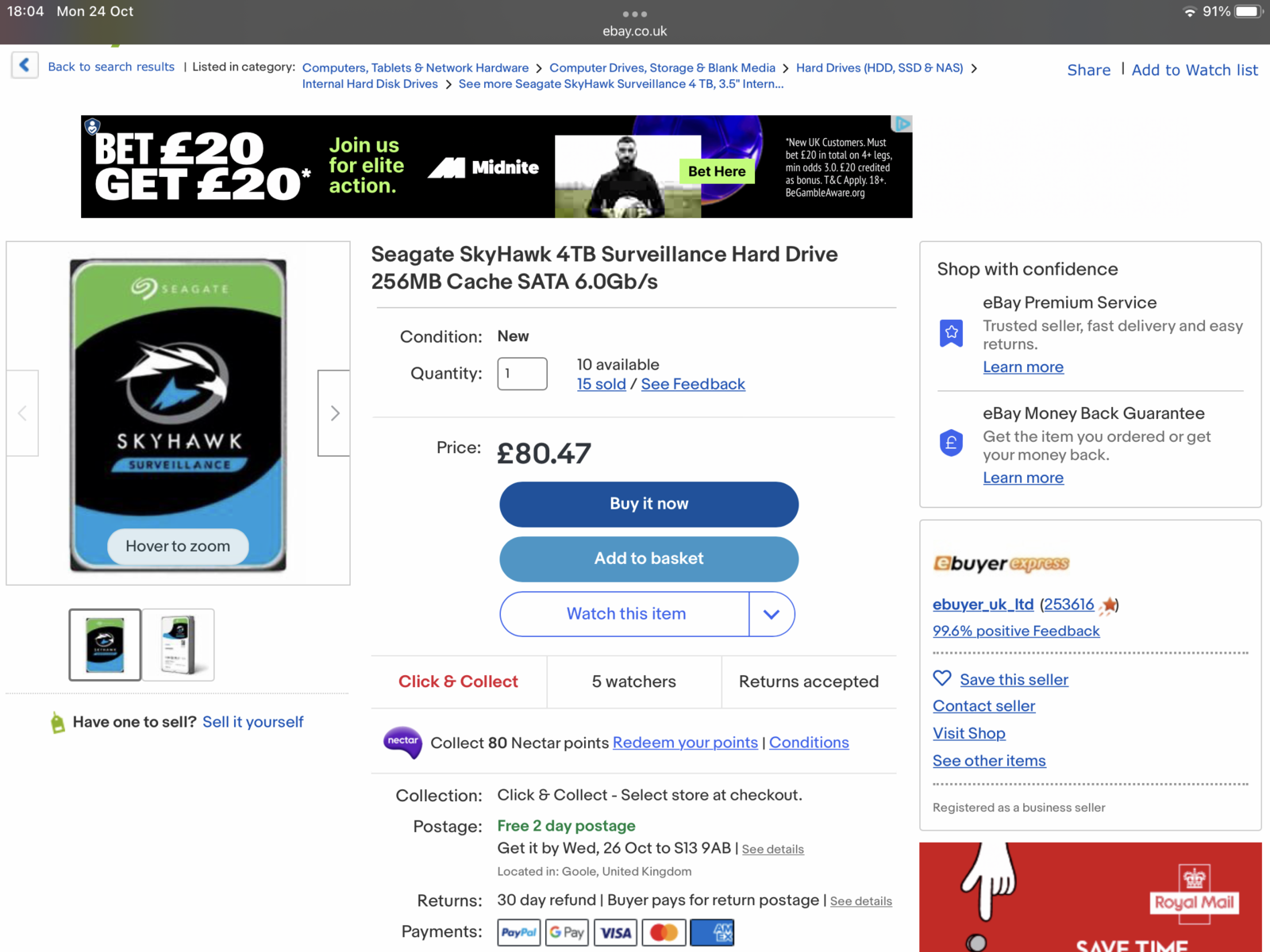

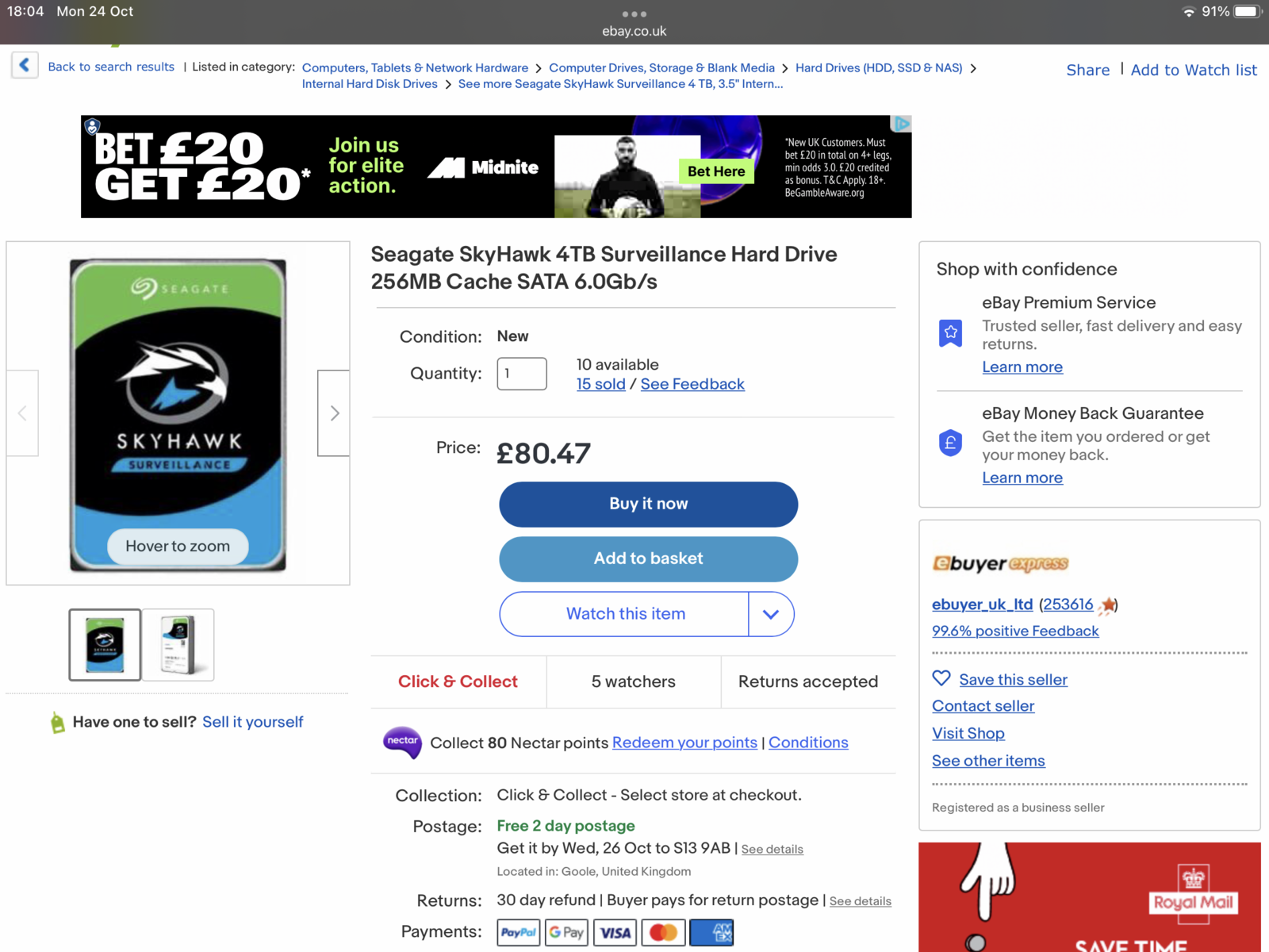

You can pick up a 4tb seagate on eBay ( new with probably the same date code as other retailers for £70 ) check date code when buying …
Look on ebuyer website , this is on eBay from ebuyer
