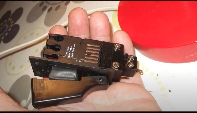

Here is a photo of the switch I found on Youtube, I know it is double pole....
Only two wires in/out and no electronics board? If so it won't be a VS type

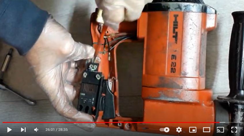

Thanks JobAndKnock, here is a better photo I just found....
Sounds like brushes in that case (so that's good), it was not cutting out at all just varying in speed....
Many thanks again !!!
