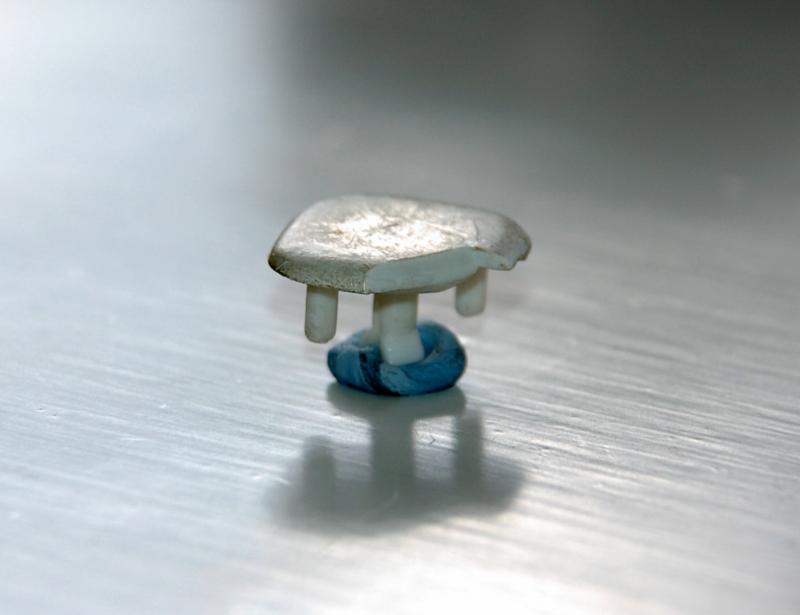

I have uPVC 'French' doors that are 20+ years old.
(The maker has long gone out of business.)
Each door has three external hinges.
Each hinge has a plastic cap to keep the rain out.
The hinge caps are breaking up - with age and sunlight.
Does any one have any idea where I can purchase spare caps?
See attached pic.
Regards to all
PS: The hinge cap is standing upright on a piece of blutac...
Can't tell if the cap is square/oval/round/rectangular but in any case the caps will be part of a hinge pack and not available seperately.......i would think
Thanks for your thoughts
FYI: The cap is (21mm) square, with rounded corners.
A picture of the whole flag hinge would be good, been flicking through all my hardware books this afternoon and the only square capped type hinge i could find is the 'MILA BKV challenger 3D flag hinge'
A link to window ware BKV page.....
http://tinyurl.com/cmwof6u
Although this shows caps that are round it could be just a generic picture to show caps, the correct ones could well be square
Or another supplier......
http://tinyurl.com/dypxap3
This one shows the hinge and probably only available as a pack as previously said
Wow - thanks for all your help with this!
The hinges pictured on the webpage you suggested: http://tinyurl.com/dypxap3 look exactly like the hinges on my door.
I've emailed the supplier asking if I can buy (just) the caps.
