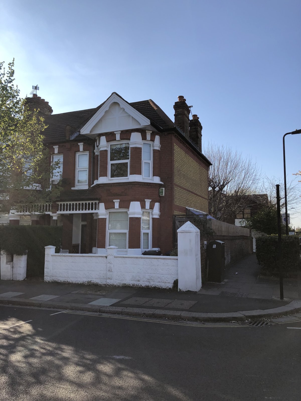

I am trying to make sense of the PD rules related to hip to gable loft conversions.
My property is an end terraced house on the corner of two roads. See picture.
I am trying to determine if the following term applies to me;
  • No extension beyond the plane of the existing roof slope of the principal elevation that fronts the highway.
Based on the picture provided am I allowed to gable the side elevation and place a loft dormer on the back of the property under PD? Does the fact I am the end house on two highways restrict me?
If I am restricted what course (if any) can I take to secure permissions?
Thanks in advance
Steve
The rule is that it is not p.d. if the roof enlargement extends beyond the plane of a roof which forms part of the principal elevation of the house and fronts a highway.
Even though your hip-to-gable would front a highway, it would not be on the principal elevation, so you could do a h-to-g, plus a flat-roof dormer on the back under p.d. (subject to the other restrictions of course).
Yes, seems like you can do almost anything you like with these hip to gable extensions under Permitted Development nowadays :!:
As a matter of interest what do you intend doing with the chimney stacks ?
