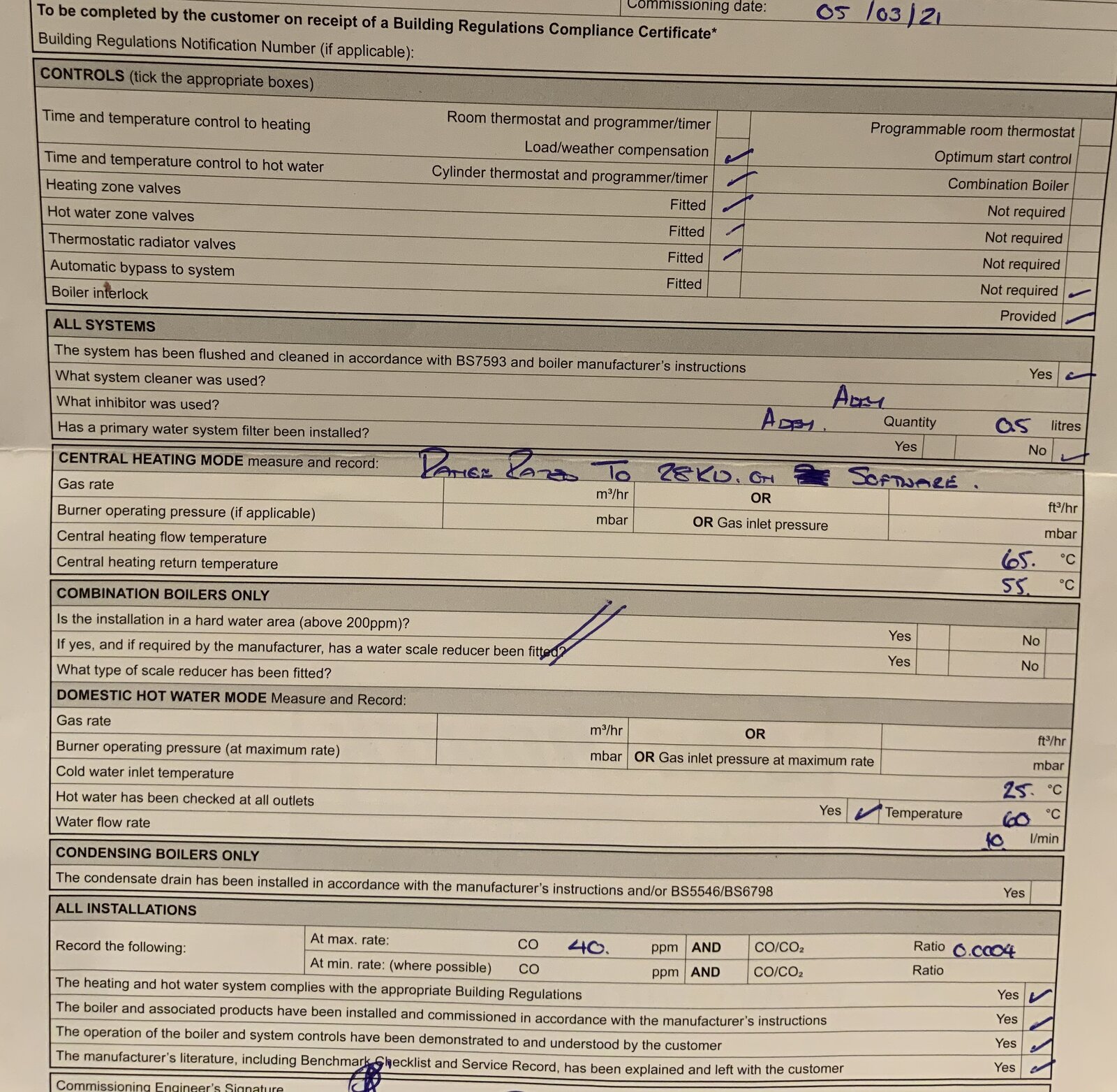

Can you post a pic/scan of the Benchmark Commissioning page in the installation manual of the new boiler?

Is the attached page what you wanted to see (I have excluded personal info)?

I see that the installer has balanced for a 10C CH temperature differential (65C-55C). Your boiler is designed to work with a differential of up to 20C. A 10C differential requires a flow rate twice that of a 20C differential, which means the pump has to work harder to overcome the considerably increased (4x) friction losses in the heat exchanger and the pipes. What you are hearing is the high flow required if balancing at a 10C differential.
Please check the values of parameters 2 and 4 (pump settings).
