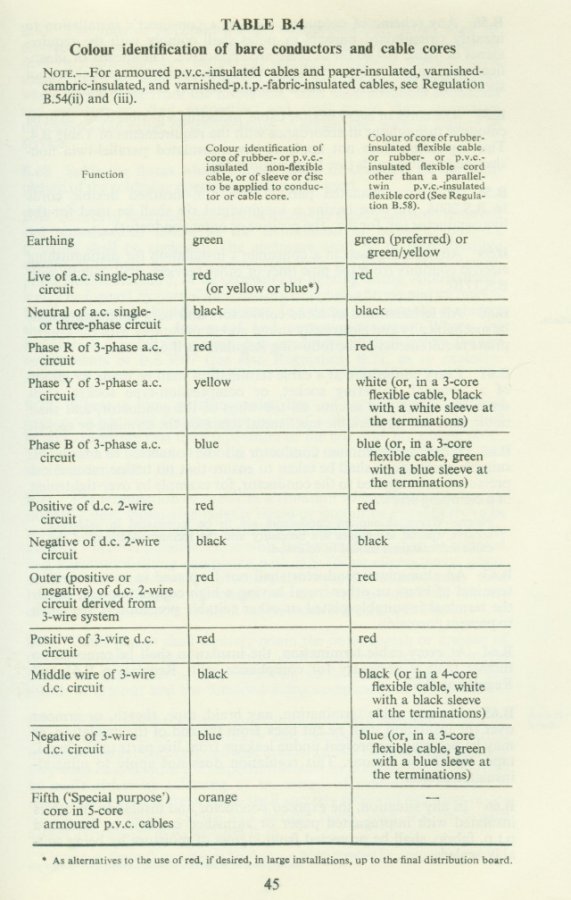

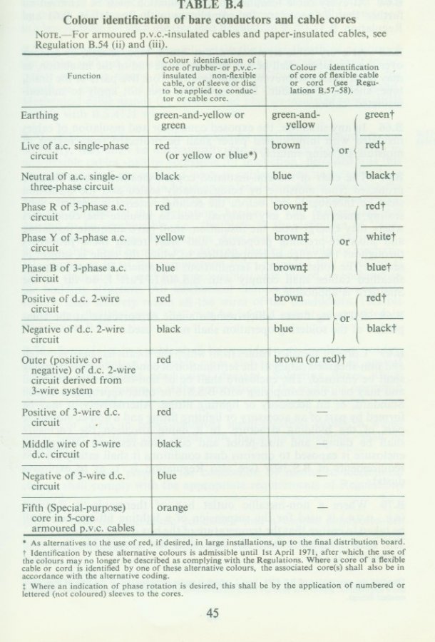

For what it's worth, here are the relevant tables from the Wiring Regs. 14th edition.
The original 1966 version:
And the revised 1970 edition:

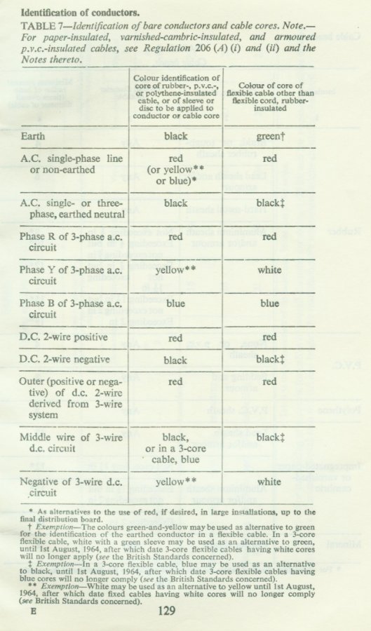

And here's the 13th edition as amended to 1963, this particular scan from the ASEE guide to the Wiring Regs.:
