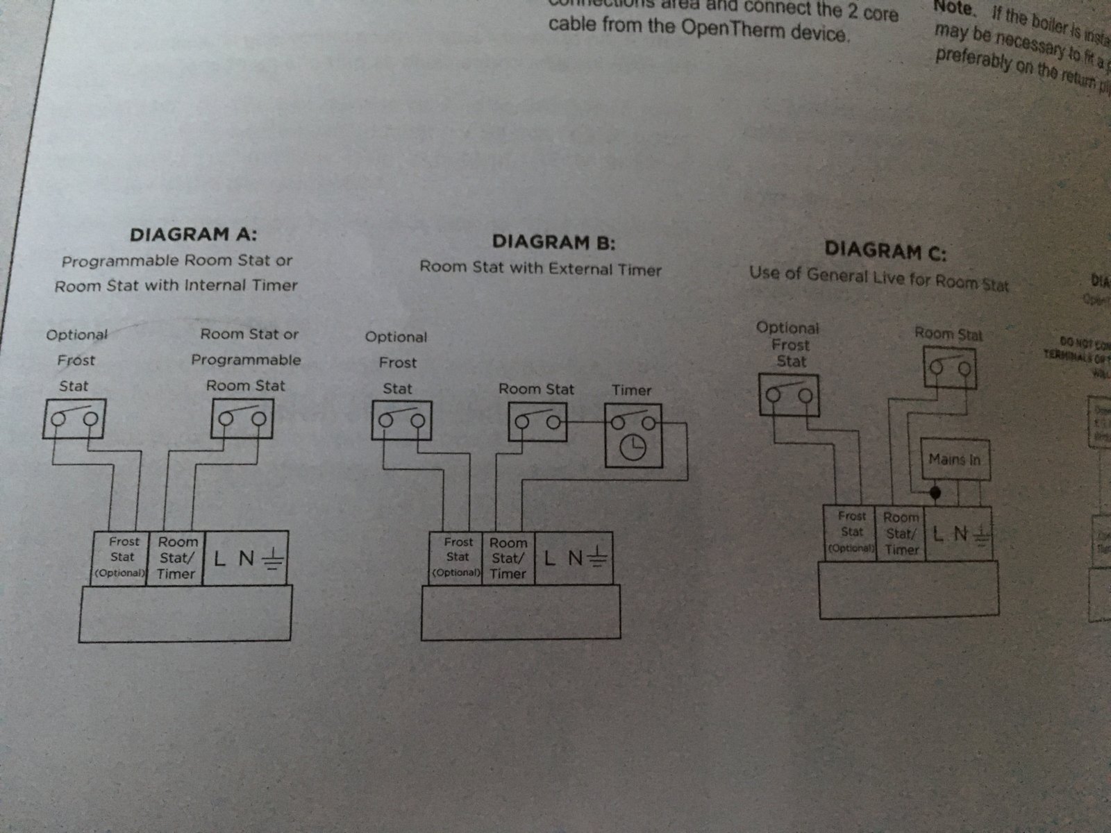

Hi All - I am new so please bear with me and my stupid questions :-)
I have just had a new Ideal Logic Combination Boiler installed with no external thermostat. I have purchased a Hive 2 to install (as a self install).
Does anyone have any simple diagrams showing the wiring needed from the boiler to the Hive single receiver (and also if I need any other wiring from the fuse spur powering the boiler - although I do not think I do).

Have you looked at the instructions that come with the Hive and those which came with the boiler?
Yes but unsure which one to use hence asking for advise
Question is if that boiler uses on/off thermostat or a modulating thermostat? And what the thermostat is to do?
Modulating boilers have a problem in that without a thermostat unless switched off they would cycle on/off all summer, so it is common to fit a thermostat to turn off boiler in warm weather using on/off.
However you would not control room temperature with an on/off thermostat, either it needs to be a modulating thermostat or a TRV. Some wall thermostats can be wired either way, Nest for example has both options.
The second problem is a thermostat to turn boiler off in warm weather needs just a simple on/off with a gap between off and on temperatures, however a thermostat for the old non modulating boilers needs to incorporate anti hysteresis software and start cycling boiler as it approaches the set temperature, needed with old boiler but causes extra stress on boiler with new type.
