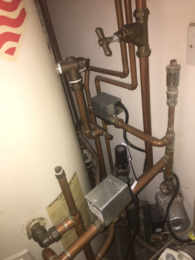

Just wondering do you need photos of boiler or control box to determine whether it is S or Y plan? Thanks.
Valves in airing cupboard, how many are there?
One with three pipes attached to it or two with two pipes attached?
Buy a hive and do what everyone is doing this week, post it up here and await instructions!
Excuse the mess. Is it round one or the circular one? :confused:

So if I have S-plan, then I do not have to worry off HW/ CH off wiring. Hive 2 should work then?

Hive will work with your current setup, S plan is currently one of the most common system types.
