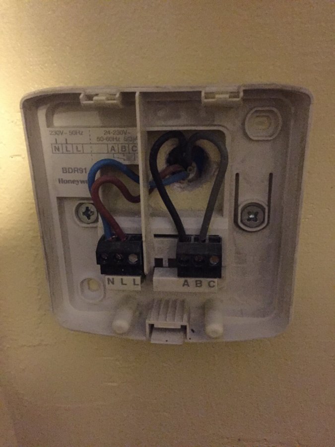

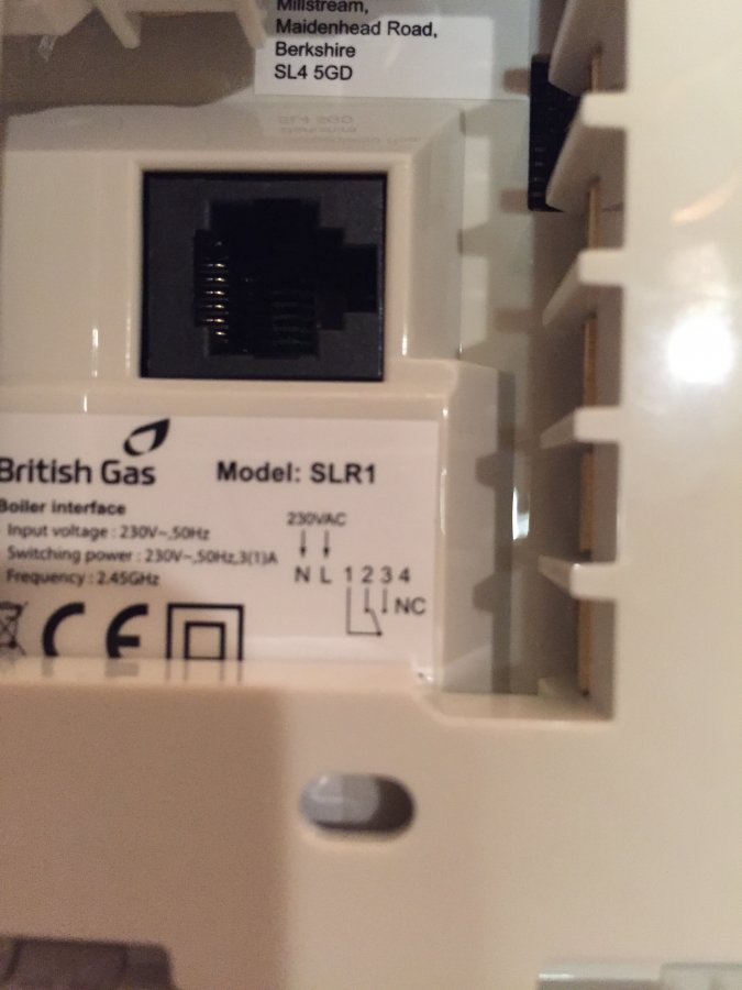

Hi Guys,
i am after some confirmation regarding the wiring of the Hive 2 receiver in place of my current fitted receiver. please see pictures below.
To me it looks as if:
Live is in Live
Neutral in neutral
A and B are for the switch and look to be in the normal open position
so to tx the wires over....
live in live
neutral in neutral
switch between points 1 and 3????
