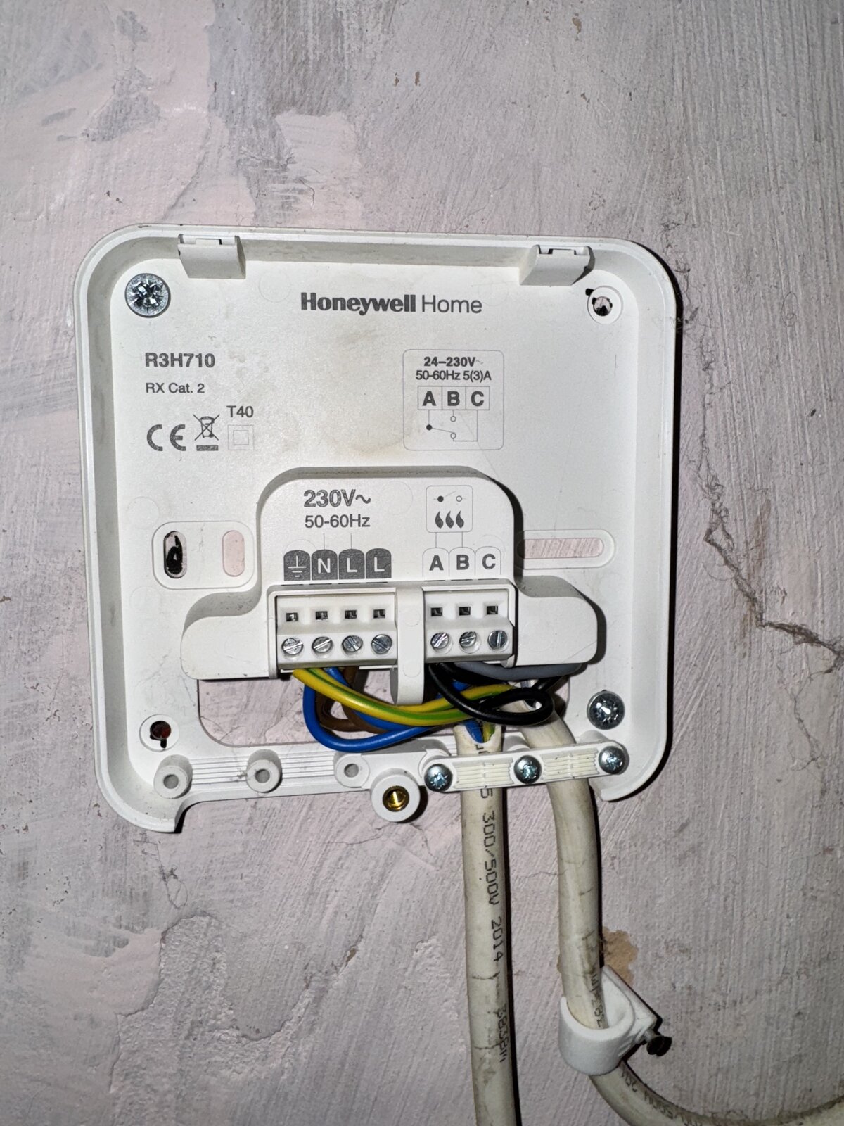

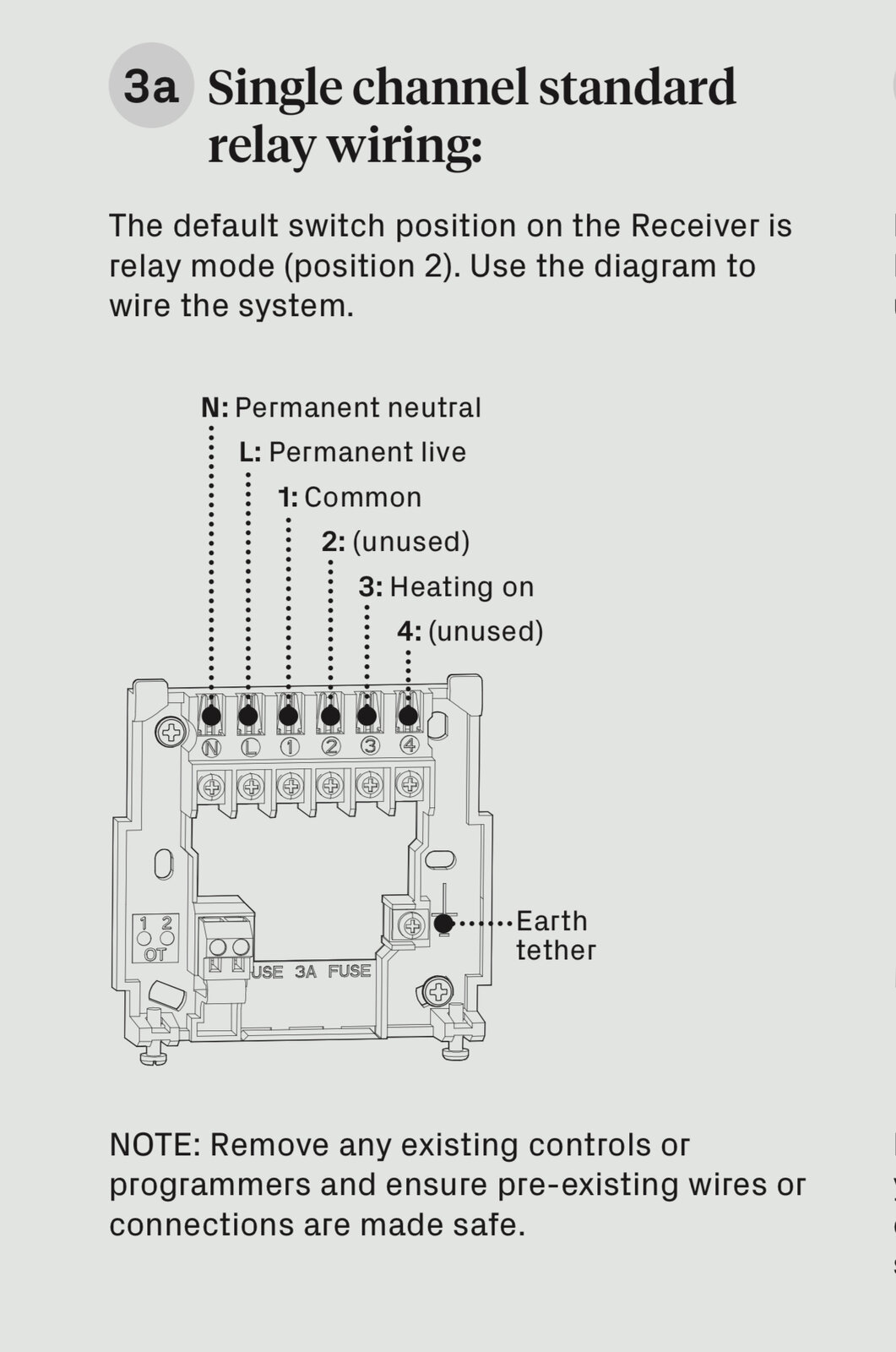

Hi,
Hoping someone can help. I’m switching my Honeywell Thermostat out for a Hive one. I just wanted to confirm the wiring in the receiver. I have attached a picture of the current wiring and the diagram from hive. Is it as simple as
Earth > Earth
Neutral > Neutral
Live > Live
A > 1 Common
B > 3
I noticed there are two wires in most of the terminals, is this normal?

Is it as simple as
Earth > Earth
Neutral > Neutral
Live > Live
A > 1 Common
B > 3
Yes, it is that simple (for a single channel Hive) :)
It appears the power to your boiler is daisy-chained through your Honeywell.
There's no problem with this, just make sure the Live, Neutral and earth wires are joined nicely within the Hive backplate terminals.
