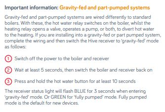

Probably because the way that the system is wired means that only the hot water channel turns the boiler 'on'. If this is the case, then some re-wiring to add a couple of relays to the two pumps and then to wire each relay so that it switched the boiler 'on'. This would mean that if either HC or HW were required the boiler would run. [Systems with motorised valves have a small switch internally that carries out the same function]
If as I suspect, only the HW channel is controlling the boiler, then with the previous controller it would have been the same. It wouldn't have been possible to have the CH on without the HW being on as well.
Hive can handle such systems, and you would need to select 'Gravity' mode of operation. Then whenever you selected CH, the HW (and the boiler) would come on as well. Although yours is fully pumped it doesn't fit the description below, but the wiring functionality is configured as per a gravity system.

However Hive has the option for thermo-syphon DHW, and what it does is activate one set of contacts for the pump, and other for central heating boiler, so if the DHW pump and boiler goes to one set, and the CH pump just to the other set, it would work, but can't have CH without DHW.
