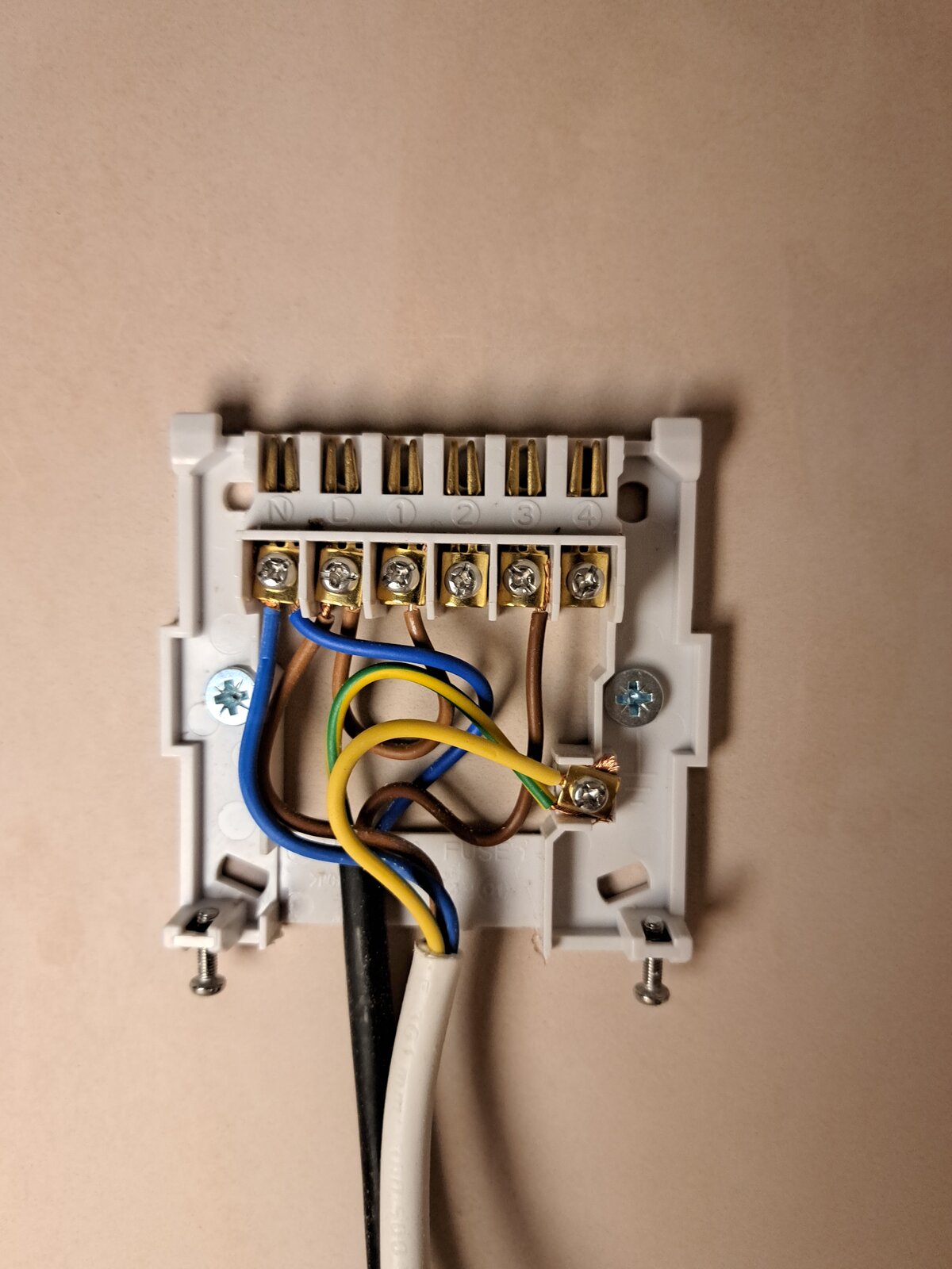

Hi, can someone please help with advice on wiring a Hive?
We have have had a Hive single channel for a Worcester Greenstar 1000 combi boiler recently installed.
Before the Hive was added, the boiler ran fine with the manual controls - Central heating and Hot Water.
Now the Hive has been added hot water only comes through when the central heating is on. The central heating appears to be switching the power for the hot water on/off as well as the central heating.
Worcester say the boiler is compatible with the Hive.
The wiring is shown in the photo.
Hive Receiver Wiring (Mains Supply – 3 core leads L,N,E: Black = Lead to Boiler, White = input from fused supply).
White 3 core lead = input
Mains Supply (Ls) Output to boiler (black lead) = Terminal 3
Can someone please advise what the wiring should be - thanks!

You say the black cable is the lead to the boiler - fair enough to call for heating, but -
verify that there is also another supply cable to the boiler.
The photo is not that clear.
There is a 3 core lead to the boiler (black 3 core lead in photo):

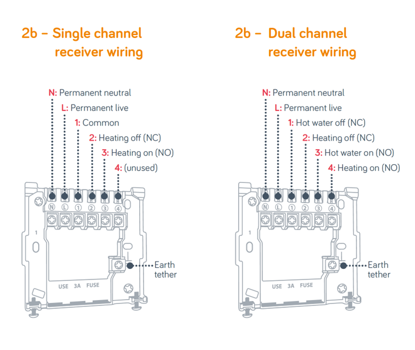

The blue neutral (N) is paired with the blue neutral (white 3 core) mains input lead (left hand terminal), the earths are paired at the earth (bottom right). The brown live (Ls) supply lead is on the second from left terminal. There is a link between the brown supply lead and the third from left terminal (labelled 1 common). The output (switched) live to the boiler is on the 5th from left - (labelled 3, Heating on (NO)) in the Hive single channel wiring diagram (below). The 4th (labelled 2) and 6th from left (labelled 4) are not connected. Suggestions welcomed - thanks.

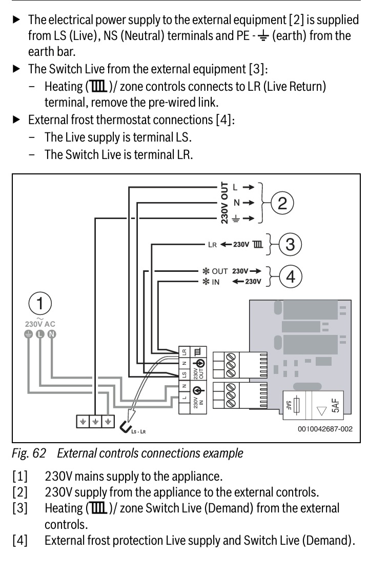

I think we've cracked it - just checked with Worcester Technical support - the switched live needs to go into the external control/switched 230V input on the boiler, the boiler permanent live needs a permanent supply - currently this is connected to the switched supply. So, I need a 4 core lead to fix it - so that I have both a permanent live and switched live inputs. Thanks everyone.

You have a slight misunderstanding of how the boiler operates.
The boiler should have a permanent supply; it should be operable by the controls and have a display.
The Hive should be connected to the C/H LR (live return) terminal of the boiler, so the fourth "lead", should be connected to this.

It seems that the installer has wired the Hive into the mains supply to the boiler, rather than the LR terminal.
Get them back to do it properly - however, to access the LR terminal (depending on version), the cover has to be removed from the boiler; this forms part of the room sealing of the appliance.
The boiler should be checked by an RGI, to ensure there are no leaks of combustion products afterwards.
Yes, the switched supply needs to go into the LR terminal for external central heating controls, as well as having a permanent supply for the hot water. I have also checked this out with Worcester technical support. I will be getting the electrician back in to sort it and the plumber who installed the boiler can also check it as the front panel has been removed. Thanks everybody for helping to sort this one.
