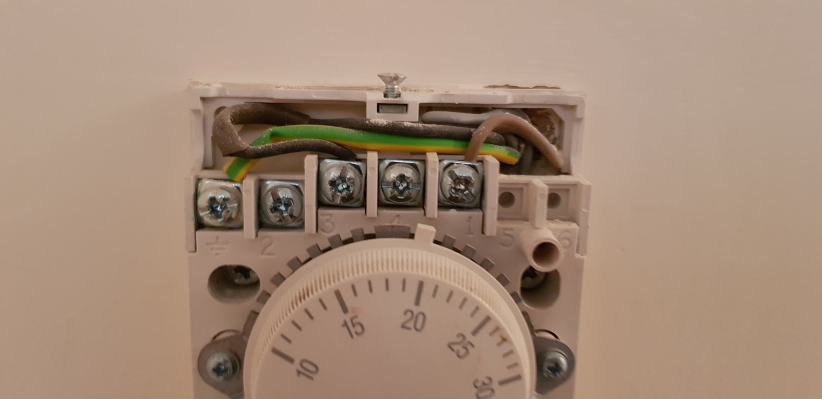

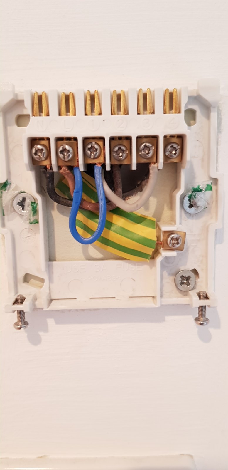

Hi all, new to the forum but need a little advice. I have recently moved into a new house and brought my hive (single channel) with me. I'd obviously like to get this installed however I'm a little stumped....
In my old house, I had a Honeywell dial thermostat which I replaced with the hub/receiver box without issue, I took photos of how it was wired as I knew my new house had the same Honeywell thermostat however after opening it up today, I have noticed it's missing the neutral wire. I have attached a couple of pics to show what I'm talking about. The pic with the dial is what I currently have in my new house. The other pic is of how I had the hive installed in my old house.
Can anyone advise me on this as I don't want to break the heating, especially as it's getting colder and colder outside.
Thanks in advance

Also, reading the manual for the Honeywell thermostat, it says that a neutral should be used in pin 2 otherwise the thermostat will not be accurate
With the old thermostat the neutral wire heats up a resistor to reduce the hysteresis, and it will work without it, new one needs a neutral, there are hard wired programmable thermostats that use two small batteries which don't need a neutral.
If you want to alter thermostat with phone then it will need some new wiring, however before going to all that work, you need to consider if Hive is the way forward, although Hive will work with phone, that's it, in real terms it is very poor quality.
