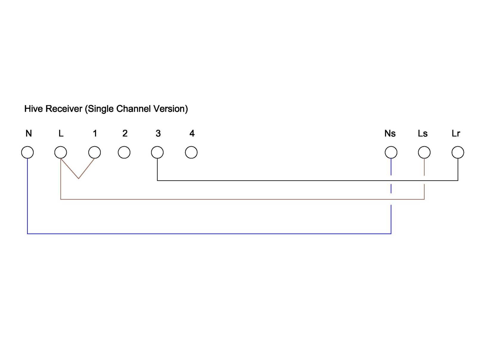

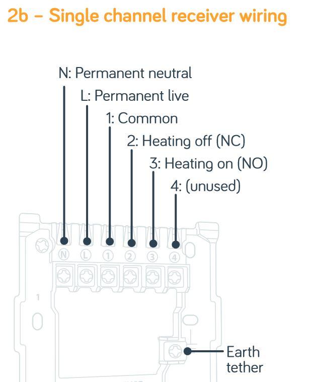

Hi
Has anyone had the pleasure of installing Hive with the Worcester 35CDi Boiler? Have checked with the so helpful people at BG and am more confused than ever!!
The system does not have an existing thermostat and am planning to leave the Honeywell Timer in place ( just setting it to be permanently on?)
Haven't removed the fascia cover but am assuming I will find all the relevant connections highlighted in Fig 12
Any guidance much appreciate ?
