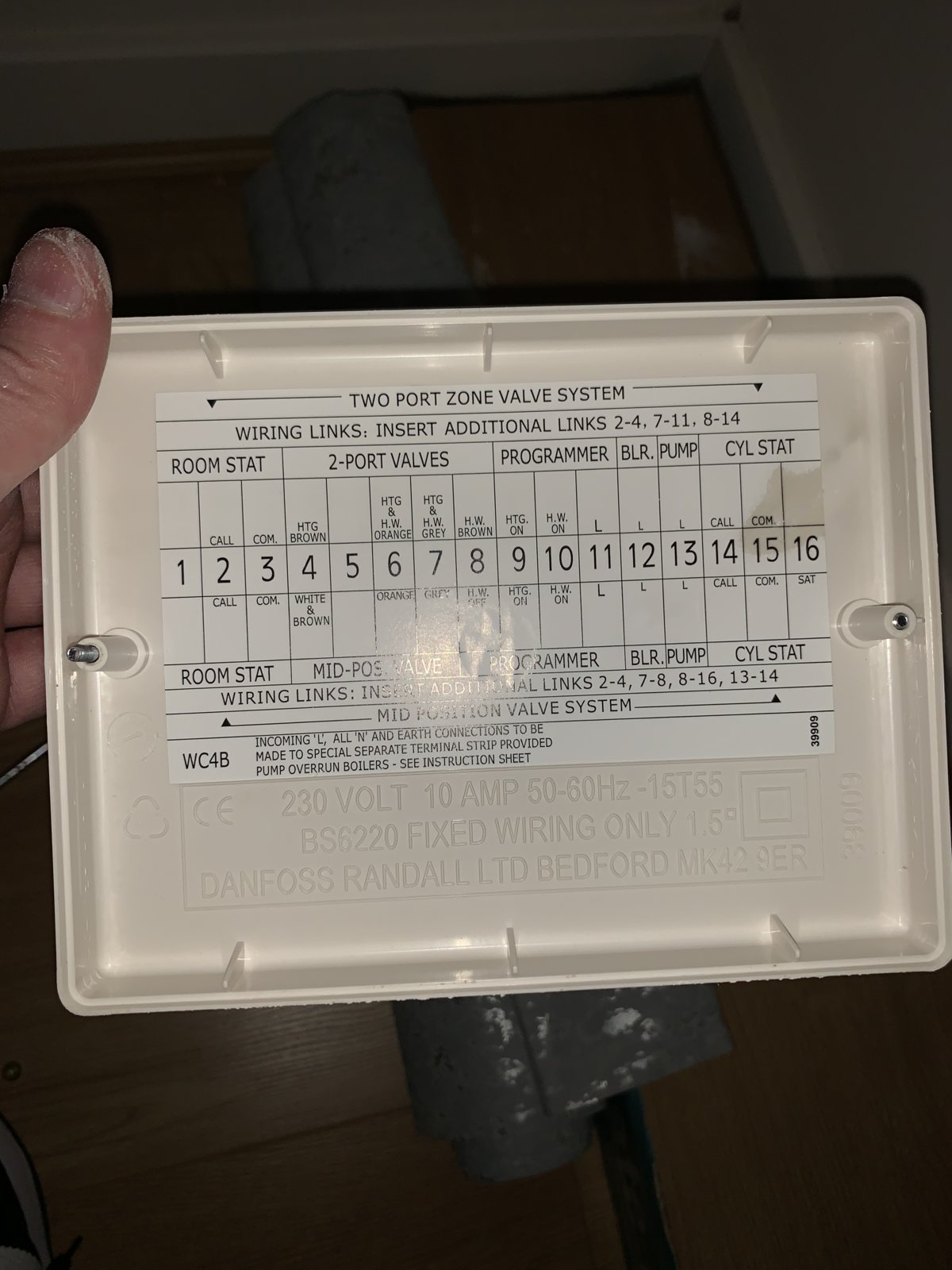

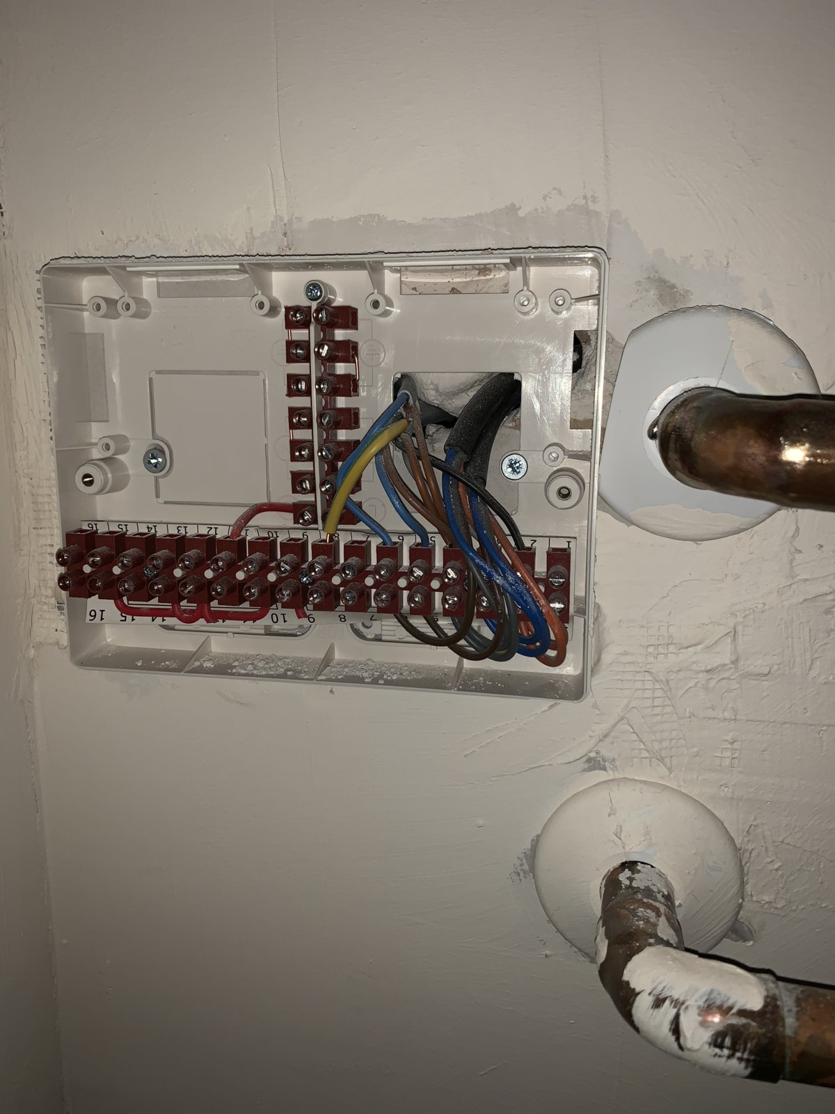

i have purchase a hive active heating single channel kit with an additional multizone set.
i have a house with has 2 zones, one downstairs and one up stairs.
i have located the main switch box for the boiler and wondering which would be the best method to install.
i was thinking that I would install the receivers next to this box for each zone, then disconnect the wires for the current thermostats? Would this work?
I have also seen that i can install the receivers in place of the old thermostats provider i bridge the connection.
any advice would be welcome.
thanks in advance
For DIY it's electrically easiest to reroute each of the existing thermostat wires to a Hive receiver. In this case then there's no bridging required as the Hive will simply be taking over the function of the existing thermostat that it replaces.
If there is a 230V L & N supply already at the existing thermostat (sometimes there is, sometimes there isn't. You would have to check) then that can be used to power the receiver. Otherwise a new L & N will be required for each receiver which should come via the same 3A fused spur that supplies the rest of the heating system.
