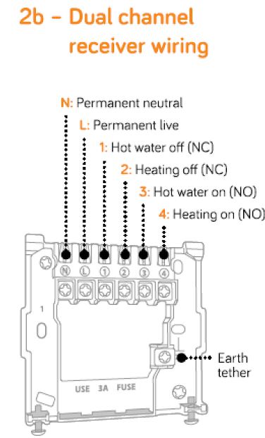

I am planning to install a Hive 2 multizone and replace hortsmann h37xl, I have traditional oil fired boiler warmflow, hot water cylinder and 2 heating zones. have got the active heating hive pack and going to get the multizone. Will I have to wire two receivers for the hive ? and how ?
Step 1 - Install the Receivers

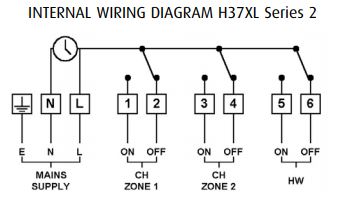

The H37XL connections can be identified from the drawing below. I can't see your photo 100% clearly, but it looks to me as if there the following connections are present.
  • N,L & E
  • Brown wire to terminal (1) 'Zone 1 heating on'
  • Black wire to terminal (3) 'Zone 2 heating on'
  • Grey wire to terminal (5) 'Hot Water on'

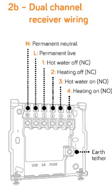

Normally 'Zone 1' and the 'hot water' are connected to a dual channel Hive receiver. From the diagram above you can identify what the wires in each terminal do now, and then it's a matter of moving them to the corresponding terminal that has the same function at the Hive, as per the diagram below. [Do not connect the wire for 'Zone 2' to the dual channel Hive receiver.]

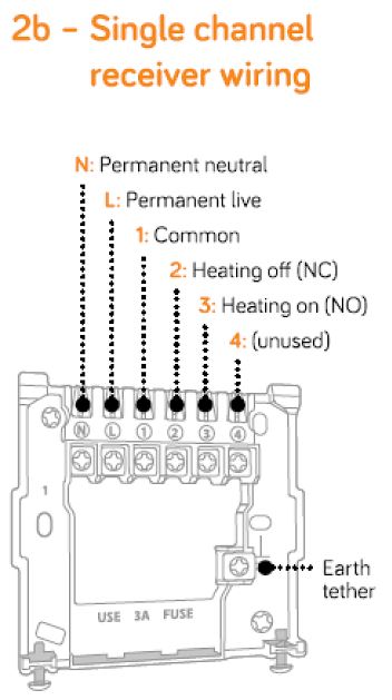

The wire that is connected to the H37XL 'Zone 2' terminal (3) connect to the 'heating on ' terminal of a single channel version of the Hive as per the diagram below
You will also have to run an N & L to the single channel receiver, and insert a link between terminals L and 1 (Com)

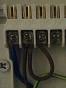

This has really helped - I understand what I need to do with the dual channel hive. With the single, do I run the L N from the fused mains and what is inserting a link between l and 1 ? thanks
The N & L for the second Hive receiver should come from the same 3A mains supply as the rest of the heating system. To do this, you can either connect the L and N terminals of the two receivers together, or pick it up from the fused connection unit, whichever is easier for you.
The single channel Hive has voltage free contacts, so in addition to the other connections, you will need to insert a wire between the 'L' Live terminal and terminal '1' common, so that they are electrically connected.
Like this

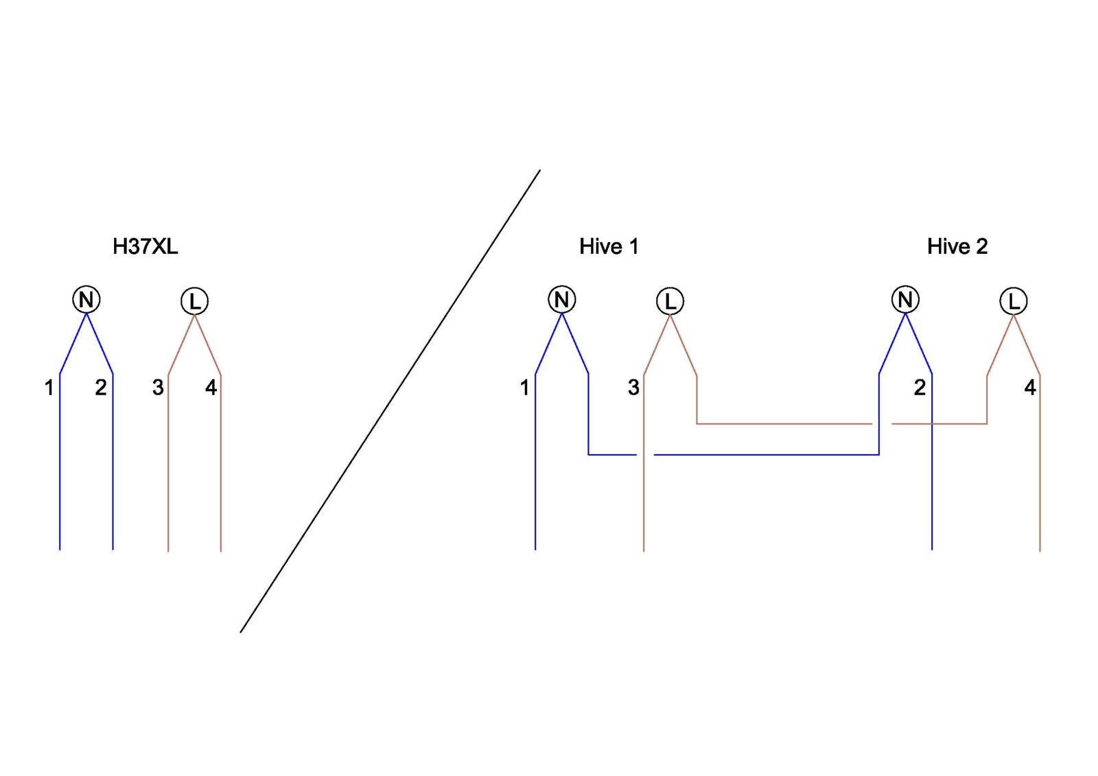

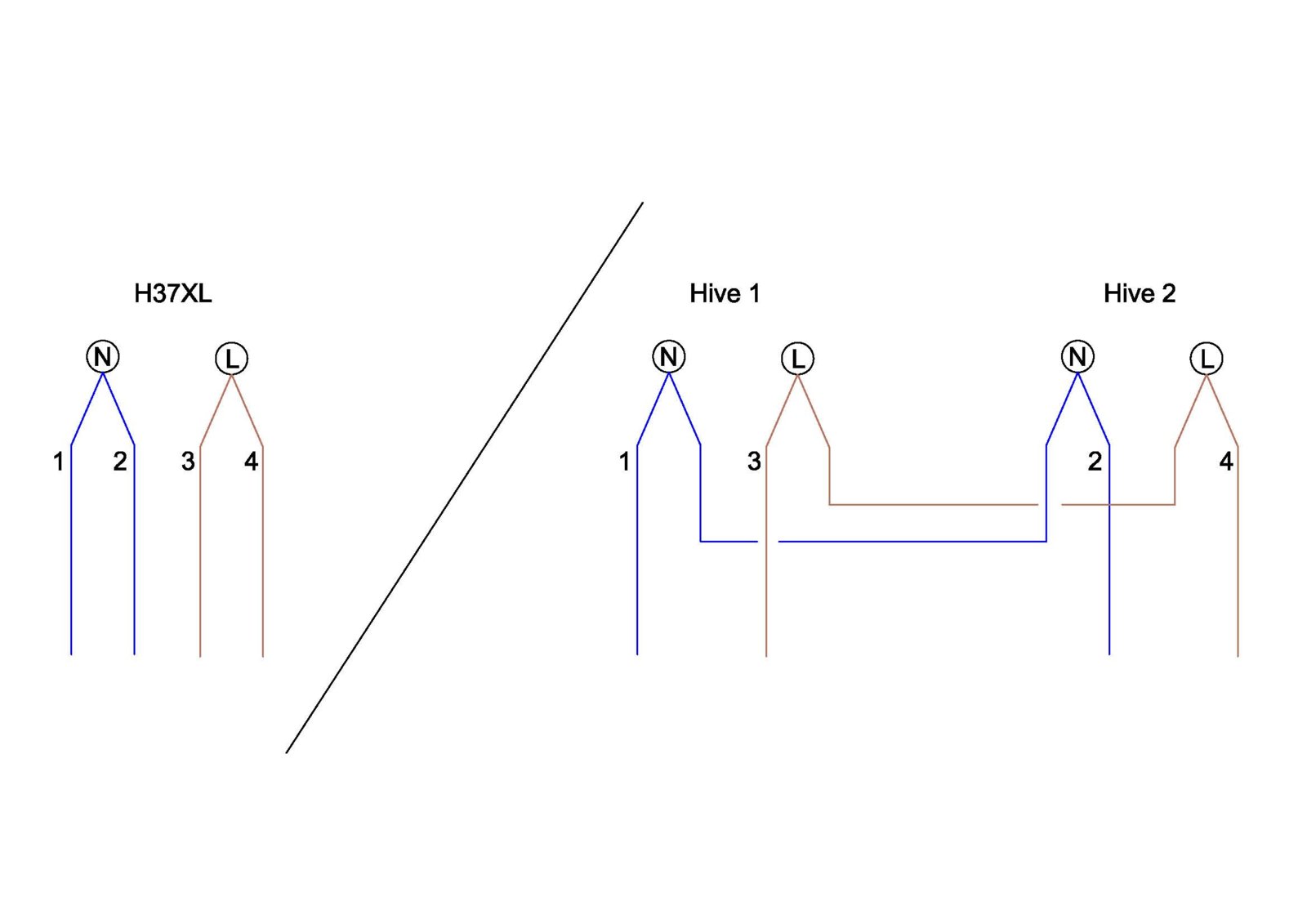

They just need to be connected at some point. If you can't physically get three wires in the same terminals at the first Hive, you could split them like this.
You will probably have to extend the wires to get them to reach the second Hive, but if there is a pattress behind the H37XL you could put some new terminals in there.
