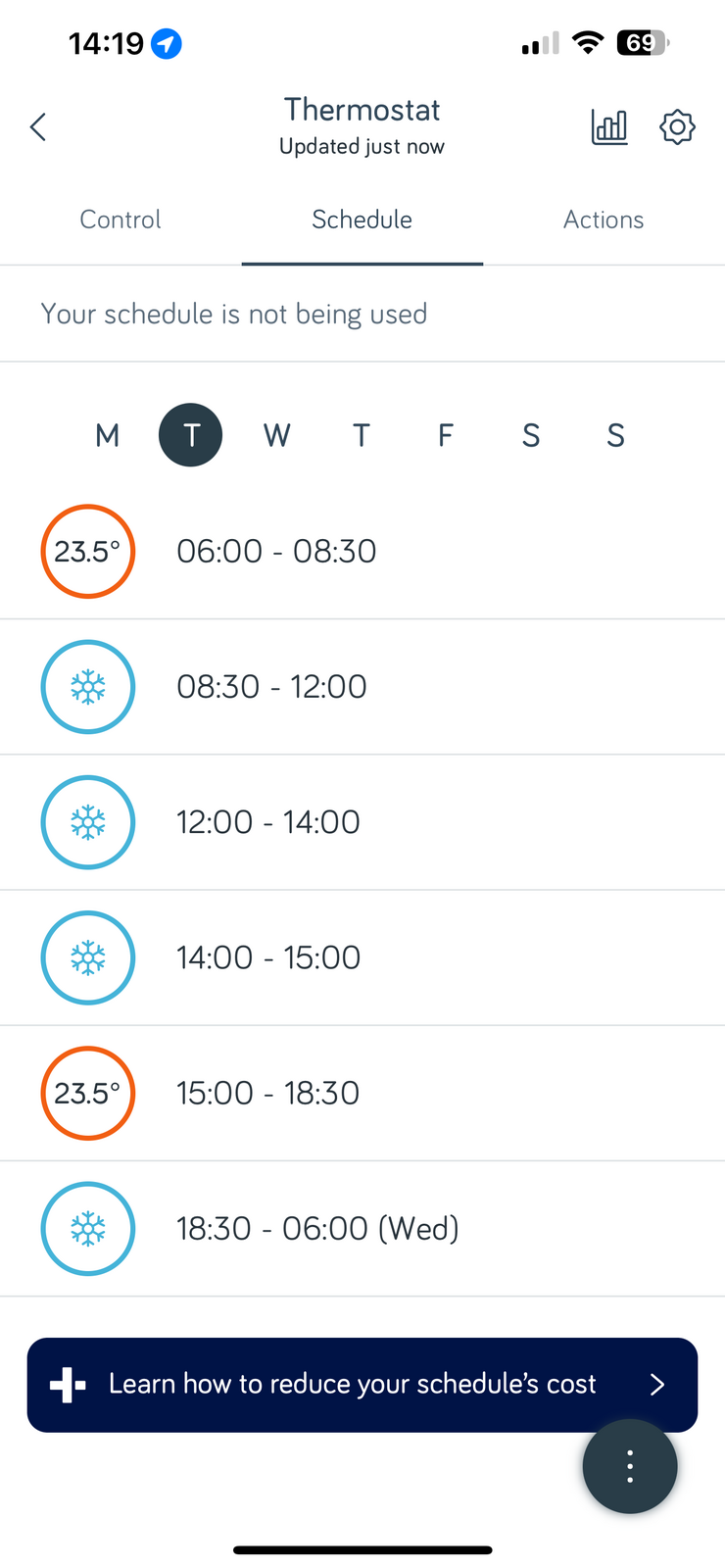

Hi all,
I hope this is okay to post here, apologies if there is a separate area for Hive.
A little bit of a back story. I moved into my current house a few months ago, it was built in in 1984 and is EPC rated C (not bad when the other houses we looked at that were smaller and the same age where EPC D and lower). The boiler had been moved into the loft and the old thermostat looks to have been from c. 2005, a Danfoss TP5 (I think). For whatever reason it wouldn't programme and so we were having to manually turn it on and off.
We got the Hive mini so we could set when the hearting comes on and set it to come on when it falls below a target temp.
I have a few questions but the main one at the moment is:
1) how long does it take or should it take to get to target temp? For example, we set it on the schedule to get to 23.5 in the morning between 06:00 and 08:30. When I got up this morning before the schedule started the house temp, according to the app was 17.1. The hearting did come on at 06:00 but even after two hours, it says the actual temp is 18.6 and it is heating to 23.5. My question is, does it take time to get to the target temperature and what if, at the end of that schedule it isn't at target temp?
Apologies if this is really simple and either I've got the wrong end of the stick or I'm being thick.
Any advice and tips welcome!
Thanks,
B.
23.5° from cold will take some time. Once there, maintaining that temp is easier - just like the speed of a car! We have ours set at 21° from 5.30 and it’s there or therabouts by 6.30ish. Our 18Kw boiler is set at 15Kw max output.

That will depend upon the heating system it is controlling and whether or not it can produce enough heat. When it's as cold as it is presently I doubt my central heating would get to 23.5 degrees if it was running flat out all day. Which is pretty hot, the recommended setting is usually somewhere between 18 to 21 degrees C.
So my question is are the radiators hot? particularly the one in the room where the Hive thermostat is located. If so, there's probably nothing you more you can do. All a thermostat will do is switch the heating off when the set temperature is reached. It can't make it produce more heat than it is physically capable of doing.
@stem thank you for the reply. The radiators are hot, yes. The thermostat was in the kitchen overnight and it is cooler in there anyway due to the size of it. I suspect it is probably better have the thermoset on it's stand in the warmer rooms. We're also in the process of swapping the rads for newer double ones which I'm sure will also make the difference.

Another question, if I have schedules set but pop it into manual mode, setting the target to 18, I assume if it falls below 18 it would come on and the schedule would still work?
Yes. If you pop it into manual mode and set to 18°, it would come on at anything below that. However, in manual mode, the schedule would not work as you will have taken it out of that mode.
For what you want, set your schedules and your temperatures and set the 'at rest' setting to 18°, then even when off, it will come on if the temperature drops below 18°.
Thanks, @Mottie - daft question, is the 'at rest' setting just the blue one out of two? Currently it is set to 7 degrees.
Yep, that’s the one. Everyone’s schedule will be different. We have one schedule for Monday-Weds, one for Thursday & Friday and another for the weekend. We leave our hot water on permanently.
