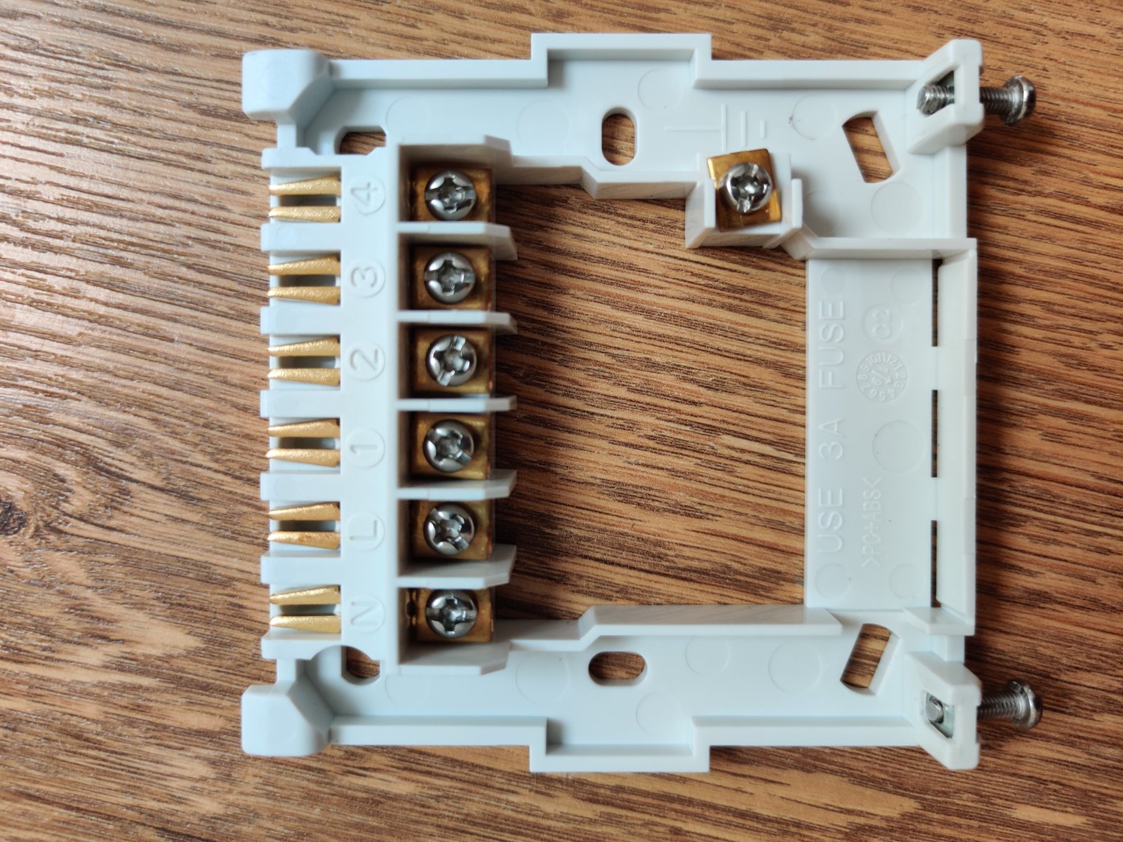

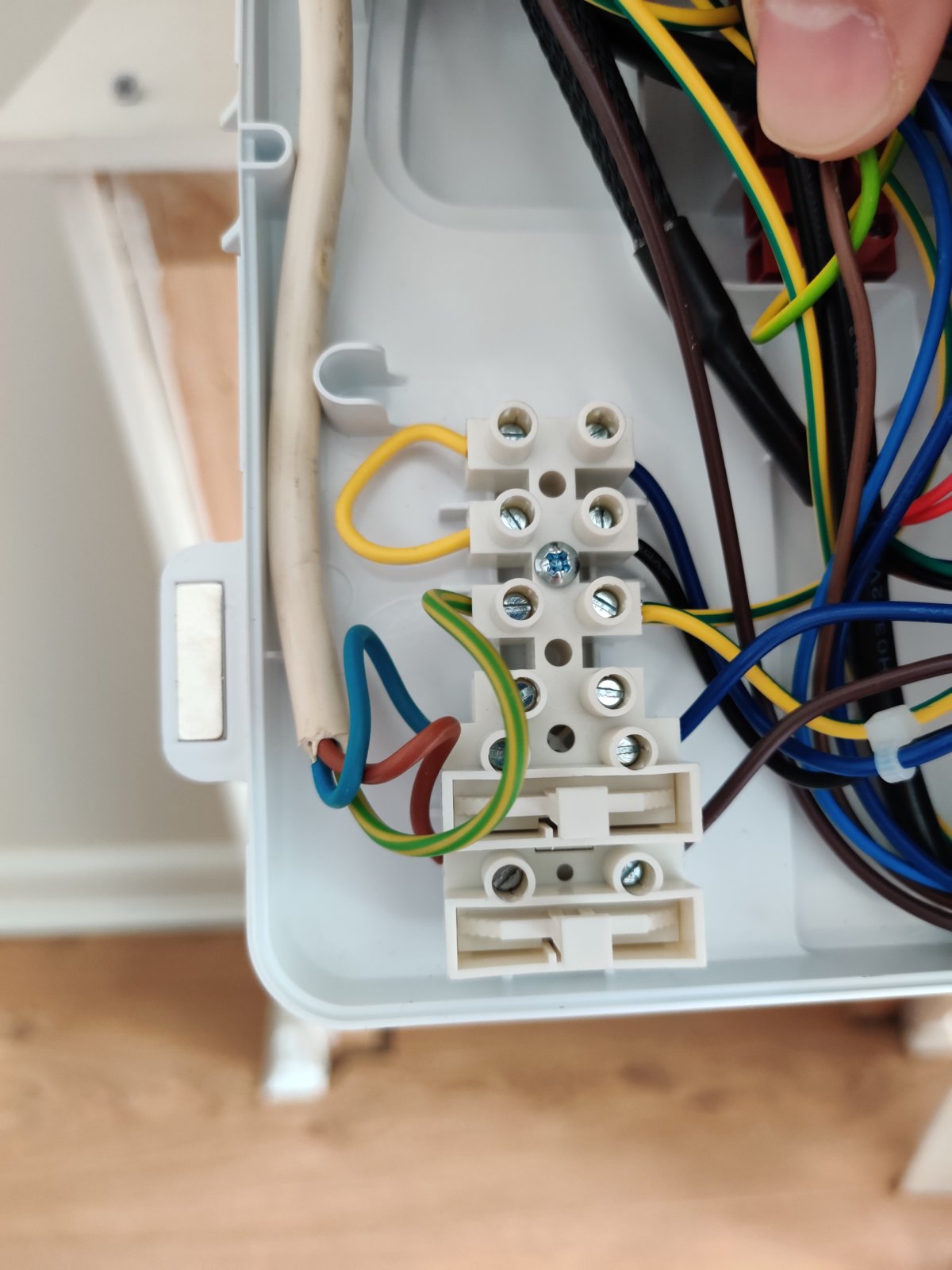

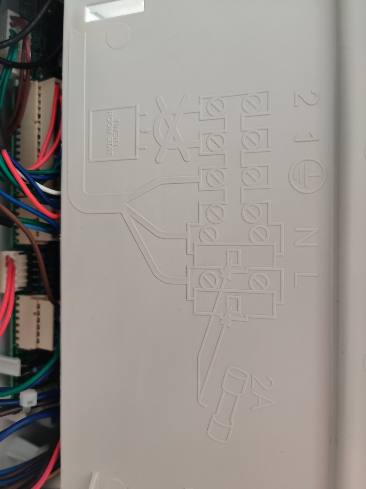

I have a hive thermostat.
I'm looking to connect my hive receiver to my baxi 825 combi.
School boy error assuming it would be simple
Any help would be appreciated.

Hi Ste,
This would have been better asked in plumbing and heating forum or electrical. However, obtain some 5 core flex and: your hive needs a live and neutral (can be taken from the boiler), live in and switched. So, the following should be ok:
L piggybacked from boiler to L Hive
N piggybacked from boiler to N Hive
Black from room thermostat connection on boiler (yellow link wire) to Common on Hive
Blue from room thermostat connection on boiler (other part of yellow link wire) to NO (number 3) on Hive
Hope this helps
